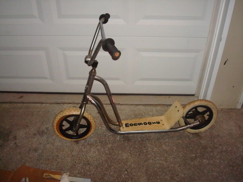

Figured I'd clean up something else I used to like spending my time doing in the eighties
Sent from my pocket ZX81
I drink and I know things.

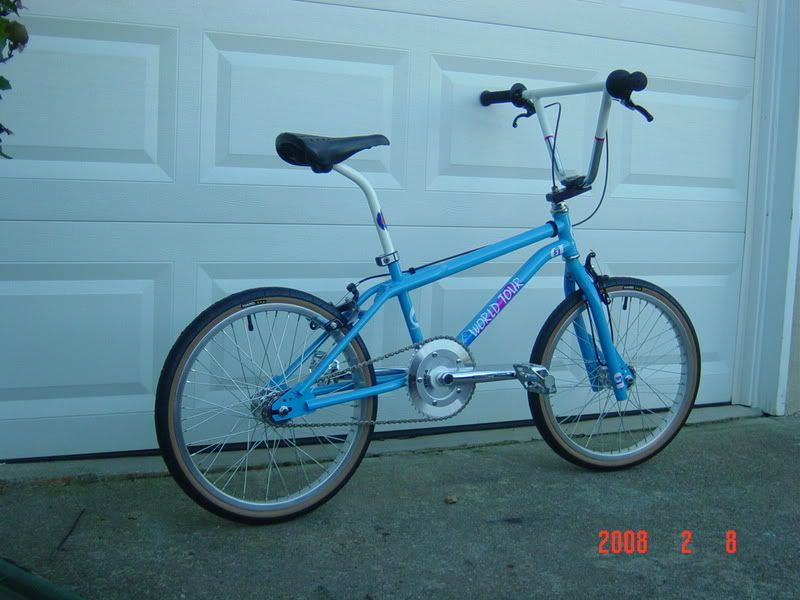

Thanks.  It's a full restore of my old show bike in this pic:
Took me almost 3 years to source the tires.
AJ

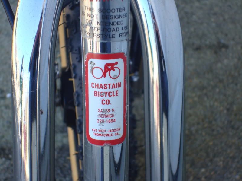

Test with 0000 steel wool.  When I do chrome BMX parts, the 0000 usually leaves them alone, or at least allows me some room for error.  Here's an example
Here's a upclose of the shop sticker...I REALLY scrubbed this frame:
This might take off the zinc coating, though.
AJ
