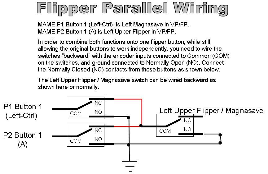

Assuming that you're running Visual Pinball or Future Pinball:
Wire the left flipper in parallel with Player 1 Button 4. (L-Shift)
Wire ball launch in parallel with the Enter admin button. (Enter)
Wire the left Magnasave/upper flipper in parallel with Player 1 Button 1 and Player 2 Button 1(L-Ctrl and A)
1. I have now added admin buttons, but I'm still wondering about the mouse buttons. Is there any other usage for a third button in the middle, other than as a third mouse button?
Admin and mouse button choices look excellent as is.  No need for the middle mouse button.
EDIT: Just realized that when I posted in this thread, I forgot to attach the diagram for how to wire P1B1 and P2B1 in parallel to one button for left upper flipper/Magnasave while still allowing them to operate independently.
