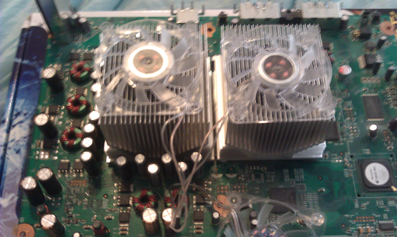

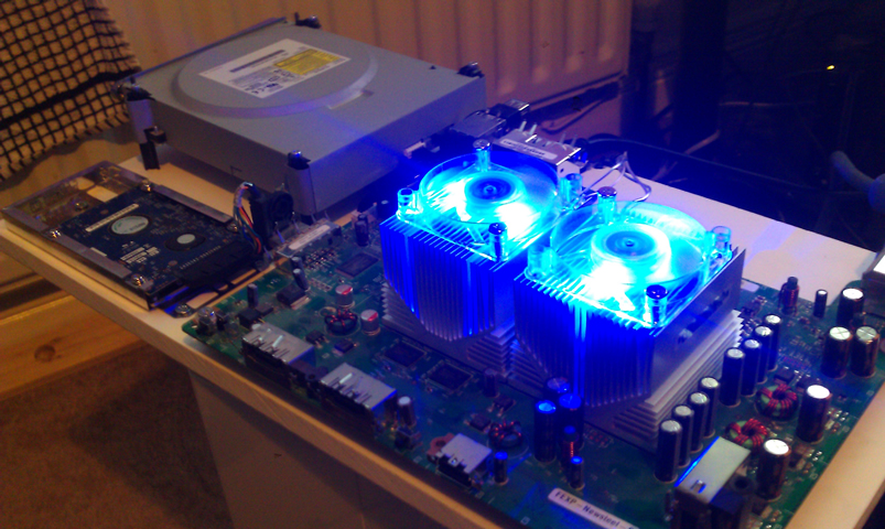

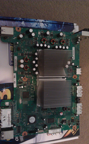

Few more images!
comicsans
  • Posts: 29
  • Last login:June 29, 2012, 05:03:49 am
Re: The X360 - Xbox 360 powered bar top!
« Reply #21 on: May 28, 2012, 07:11:12 am »

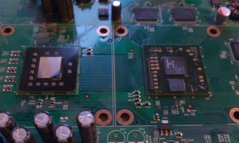

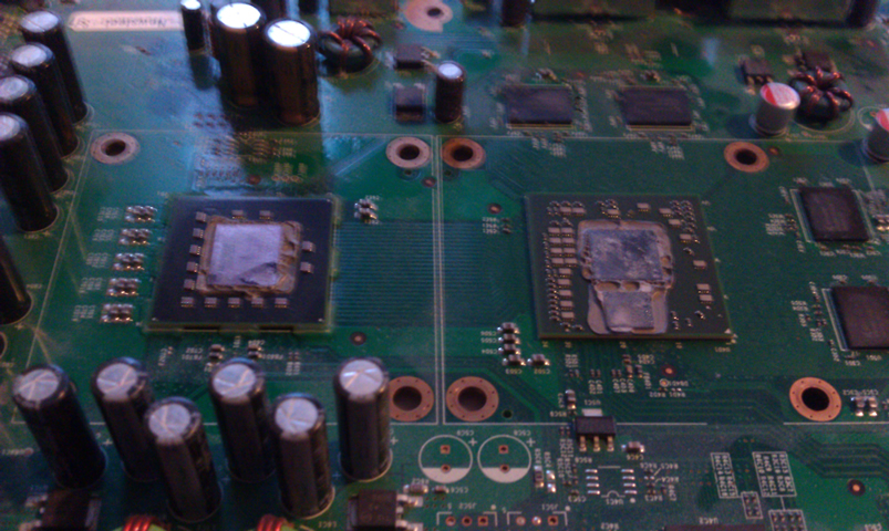

All upto date now with these pics!
I replaced the old stock cpu & gpu with the updated jasper heatsinks as they work alot better especially on the gpu, i also god rid of the xclamps and used the RROD kit to fit the cpu & gpu! and offcourse some article silver thermal paste. I also used a laptop cooling pad for the fans attached as they ran off usb.
Look at the crap microsoft dumps on there cpu & gpu
All clean! took me a little while to get off!
I will also add the orginal xbox fan back on to help coold the cpu & gpu as the small fans arnt that strong. we should be ok for the heat now.
« Last Edit: May 28, 2012, 07:13:02 am by comicsans »
