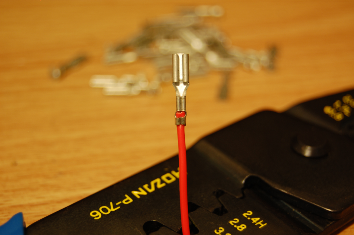

I use terminals and sleeves from polevolt.com in the UK and I use the Hozan P-706 crimp tool.
The P-706 has a range of anvils on it and I use it for Molex, Mini Molex, AMP UP, a range of JSTs, Hirose etc etc.

I must say I do love my P-706, it crimps most things I have come across, even down to the tiny JST PHD crimps.

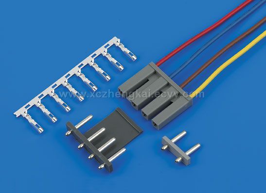

Whilst we are talking about housings etc. Does anyone have a source for these?
I think they are commonly known as TJC1 connectors. The description 'pressure welding bar connector' often seem to me mentioned in relation to them. I'm looking for a four pole one as shown along with the crimps and also the PCB header. They have a 8mm common pitch but the last pin is set 10mm out.
JST have them as LV connectors but they only sell them in boxes of 500. I have found no end of suppliers in HK though Alibaba but they want minimum orders or 1000+. The one company that would supply them in 100's won't reply to me.
Mouser stock a [molex version] of them but they only have 2 in stock.
They seem to be a very common connector but I can't for the life of me seem to find a stockist of them where I can purchase 30 sets or so.  :-\

As for those connectors you pictured, I'm also not aware of where to get them or what they're commonly called.  I know they were used on my KT-2914 monitors for power and other stuff.  They seem to be commonly used for yokes on CRT monitors.  To make power work, I just took a couple of AMP Universal Mate-n-Lok sockets, mangled them down smaller with some pliers until they fit snugly, crimped 'em onto an AC cord, and covered them entirely with heat shrink.  No housing to hold it, but it works well enough for my purposes.
Looks like Mouser does consider that a stocking item.  If you can stomach the 11 week lead time (minimum, probably), they'll order them from the factory for you, even if you only want a few.

If a solid and fully functional crimp like this one in the photo below has an appearance which ruins your day, then don't use them.  But it looks fine to me.
No matter how good the crimping tool, nothing can make those hard-insulated crimp connects look good. I don't ever see those used commercially either. They always seem to come naked or with insulation that was put on after crimping.
That's because commercial crimping machines use large rolled chains of uninsulated terminals because they are cheaper and about 10 times faster to install. But, as stated above, you can get commercial solutions for insulated terminals but those are much more rare.
Exactly why I don't use them. And yes, that crimp looks like ---steaming pile of meadow muffin---.
Now this... This is a sexy looking crimp...
The connectors on my Molex machine can be installed at the same pace, and are fully insulated.  But they cost about 5x as much as the non insulated ones.
:)  Connector pron....  The hard shell still provides a better grip and aids in installation.  It's also functional (insulation).  Again, looks aren't everything.
