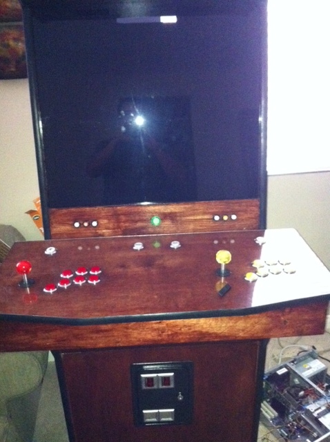

Donkbaca
  • Posts: 2648
    • Slim built MAME/Xbox cab
Re: Fighter Cabinet - PS3 or X360?
« Reply #20 on: March 30, 2012, 10:53:38 am »
If you  look in my sig, you will see my build thread, which I need to get around to finalizing.
Anyhow, I have a 3 ghz core 2 duo running in my rig, runs everything that is playable that I want to play.
I switch between the xbox and the PC using a KVM switch that I attached to a green seimitsu button.  Here is what it looks like:
You press the button and it switches the controls, sound and monitor to the xbox 360
If you have any questions, let me know
