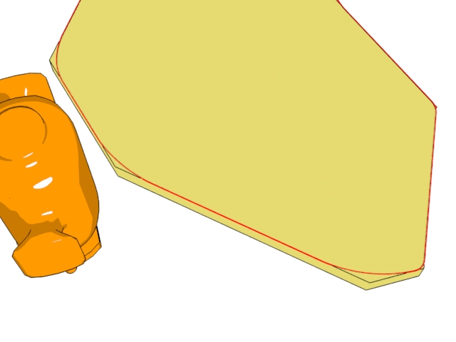

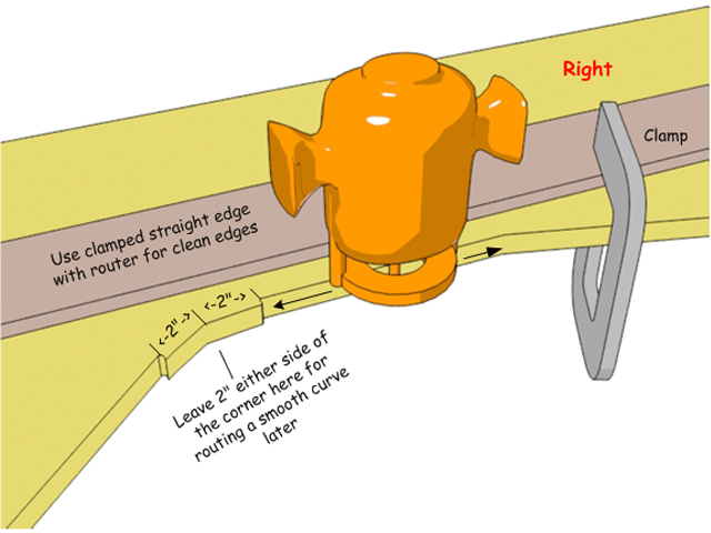

    Thanks for the info TopJimmyCooks.  I've been working a bit more on this recently.  I've taken the basic concept and worked that into a more accurate imperial measurement plan and model.  I've deliberately shown the model with edges left unfinished i.e. not rounded off.  The bezel is now square and can be positioned either for horizontal or vertical aspect.  The plate at the front has been widened to allow for the Suzo Happ multiplayer coin door.  It can still be rear lit with LEDS or neon tubes down either edge,
    I've also drawn up cutting plans taken directly from the model. The sheet sizes in the cutting plan are either 4x8 3/4" or 4x4 1/2".
    I'm nearly ready to begin construction details including 'How to' diagrams which will expand on the cutting plan info.

    Obviously with a saw bench the next steps would be easier, but as I said, with some patience,some clamps and the straight edge you can make most of the cuts with just a hand held power saw.  The shorter cuts near the Bezel area should just be cut as closely as possible to the pencil lines with the jigsaw.  Leave about 3/4" outside of lines which intersect but which will later be routed to a smooth curve.  The next few diagrams help to explain what I'm on about here.
    So we have a panel now which has been accurately cut along pencil lines where possible and rough cut near other lines where necessary.  Time to prop the panel up on a bench or table and switch to the router!  Many routers (but not all) have a base plate with one straight edge, in the same way we used the straight timber edge and clamps with a saw, we can also use a router to cut precise straight edges.  First we're using just a standard straight bit in a 1/2" collet.
    Important!-This cab design does have rounded off inner and outer corners.  We need to leave something to refine into a curve later, mainly in this area here.
    Once all the remaining edges are routed cleanly along the pencil guidelines we can focus on rounding off those corners.  At this point there are a number of options.  People confident with a router can just choose to free hand cut very near an (marked with a compass) arc pencil line and then sand this down to a final curve.  This would be my approach.  I get within a few mil *cough* err I mean fractions of an inch of the line and then take a small paint can wrapped in rough grade sandpaper and just hone an inner arc. Outside corners I'd route away most of the material sand and then refine with a mechanical sander, or hand sand with a sanding block.  An alternative approach is to first make a thin (1/4") template of an arc and then use a flush trim bit to cut out the arc on the panel.  Either way we want clean curves on these areas as well around the top of the cab.  The T-molding is going to go nicely around these.
    Side panels nearly done!  We only need one accurately cut panel which we can clamp over the top of the other rough sawn panel and using a flush trim router bit make a duplicate panel from. TIP!-Trim the remaining panel as close as possible to the cutting line with a jigsaw first, this will make the routers work (and yours!) much easier.
    I totally managed to leave the clamps out of that diagram, always remember to clamp the pieces together firmly for this type of work. TIP!-Use pieces of plywood between the surface of your panel and clamps to prevent denting the surface.
