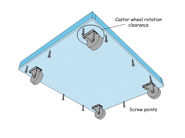

This cab will be sitting on a base fitted with caster wheels, as many builders start by constructing this first, let’s start with that also.
Choose caster wheels which are strong enough to handle the fully loaded cab, each wheel should be rated at least 50-60 kg.  My preference is for casters with smaller wheels if you can find them.  As the diagrams show the base is just constructed by pre-drilling the base panel and brace pieces and then gluing and screwing them together.
When attaching the casters make sure you allow for the turning circle each needs, no part of the caster should protrude over the edge of the base unit as this will be positioned at a set height internal to the cab, all caster frames should have a clear turning circle to allow easy movement in any direction when needed.

Do you suggest two fixed and two turning casters or all four turning? What about locking wheels? Is a rolling cabinet while playing an issue?
This is awesome BTW.  :applaud:
These are all good options to consider and depending on what surface your cab will be resting on could vary.  If you use casters with only a small wheel radius and it is going to rest on carpet then all turning casters are OK.  I've confirmed this with other forum members as well.  In this case the cab tends not to wander about as it's being played.  If the cab is going to stand on a hard surface then locking casters or even just a pair of fixed casters at the back of the cab with small matching (in height) legs at the front could be an option.  To move the cab you'd have to tilt it back on it's wheels.  I'd still recommend positioning the base so that the bottoms of the panels clear the floor by an inch or so for a nicer 'hovering ' look.

Since each person's wheels will likely vary, can you put a suggested height off the ground for the base of the side panels?  You have 3-8/32 listed from the top of the base frame to the bottom of the side panel, but if someone following your instructions picks the smallest capable wheels, it's possible they could get interference with the ground.
This looks great so far!
I’d go with no less than an inch of ground clearance from the bottom of the panels to the floor, this should cover most carpeted surfaces and still look good.
Just throwing this out there, for my cabs [both on laminate flooring] what I did was counter-sink a lag bolt in a hockey puck [I'm in Canada!] and then put a sticky felt pad on the bottom. The puck handles the weight of the cab no problem! And the felt pad makes it easy enough to slide around but still heavy enough to not move when playing.
Nice alternative to casters!
