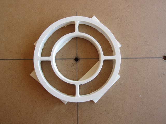

A circle jig was used to create the ring.  I made marks on my template (using the blue "C" ring as a guide) where I needed to stop routing.  I didn't want a complete circle.  Also I put a waste piece on top and underneath the laminate whenever I routed.  This helps to keep the laminate from splitting.
I tried this a few times by making my own circle jig but was not happy with the results.  The jig I bought has marks every 1/16" of an inch.  That made it much easier to try different radius until I had the perfect size for the EL Panel.  The hole I drilled for the jig pin also served as a guide for the 3" hole saw I used later to create a hole for the trackball.
Re: Tron Legacy - CP Started 10/6/2013
« Reply #261 on: October 07, 2013, 11:28:45 pm »
It took me a long time to figure out exactly how to make the patterns that go around the joysticks.
This thread by MikeDuece was one of my original inspirations -
http://forum.arcadecontrols.com/index.php?topic=105795.0

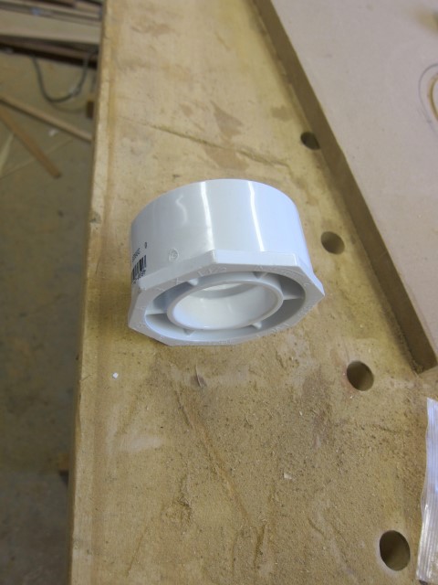

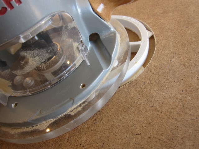

This entire process would be much easier with a CNC.   Since I didn't have access to a CNC I wanted to find existing patterns I could use.  I spent hours walking through hardware stores looking for ideas.  The pattern had to be big enough to go around a joystick but also be the right size to allow me to use pre-cut EL Panels.  Ultimately the plumbing aisle yielded the best results and I used several different PVC fittings as patterns.
I carefully cut a sliver off the end of the PVC fitting with my chopsaw.  This was more difficult than I anticipated because I was trying to keep the sliver very thin.  The sliver was then sanded with my orbital sander to make it as smooth and level as possible.

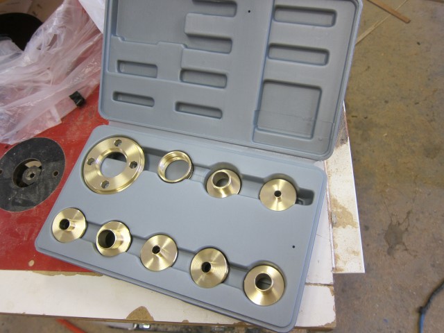

I picked up a set of template guides off Amazon.

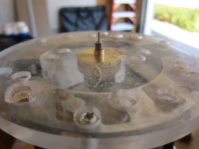

The premise is that the bushing works somewhat like a flush-trim bit using the PVC pattern as a guide.  The bushing allowed me to use a very small bit--in this case a 1/16" double flute straight bit.  Using a small bit has a couple of advantages.  First I wanted to use the smallest bit I could find to avoid the "rounding" you inevitably end up with in the corners when routing.  If you look at the "C" Ring I cut you can see the rounding at the ends of the partial circle.  In that case I wanted the rounding for effect.  These patterns needed to be more crisp.  Secondly the smaller bit allowed me use a smaller PVC pattern.  I could not find a flush trim bit that would fit in the grooves of my patterns.
Here is a shot of the bushing installed in the router.
I drew crisscrossing lines where I wanted the joystick to be and used those to center the pattern.  Double-sided tape holds the pattern in place very nicely.  I don't recall who on this forum gave me that idea but thanks.  That stuff is magic.   :cheers:
Very carefully route out the pattern.  The key here is patience.  I turned off the router every time I had to move it from one section of the pattern to another.
And here is a shot of the partially finished laminate before I messed it up.

To get around the problem I was having with the joystick hole being centered I found some PVC fittings that fit in the center of my templates.
With the insert in the middle I can route the joystick hole and have it be perfectly centered within the template.
The one of the right was done with the new technique.
While I was routing my CP top the double-sided tape on my template slipped and I ruined my last piece of laminate.  I think I made the mistake of not wiping off all the sawdust before putting down my template.  Now I know (somewhat) how Somunny felt with his Ark Project laminate troubles.  I went from seeing the finish line to basically starting over with the CP top.
