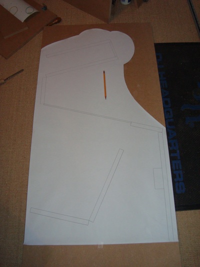

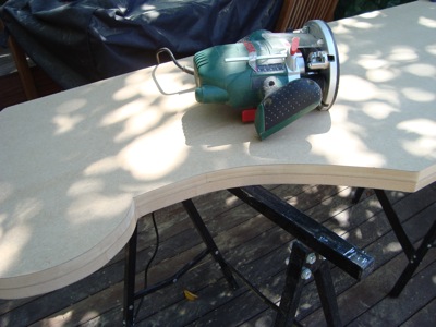

As I'm still waiting for my Star Wars cabaret artwork, I thought I'd crack on with my next mini cab - Burgertime.
I got a large format print of the top part. This made it easy to get an accurate profile.

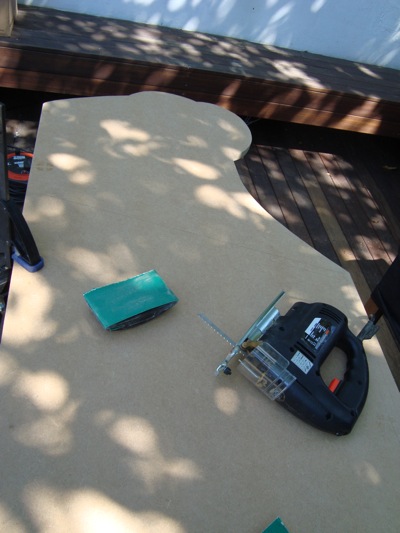

Yesterday was nice and sunny so I managed to get all the woodwork done. First off, cutting the curves with the jigsaw:

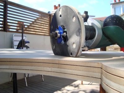

Trimming the second piece with the router:
Cutting the t-molding slots:

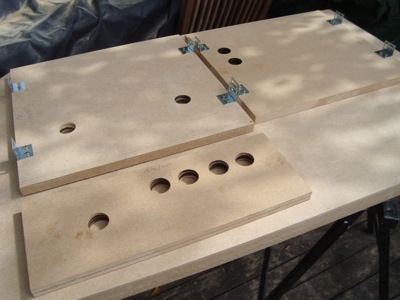

Using the holesaw for the control panel, speaker panel and marquee top panel, which will have power and credit buttons:

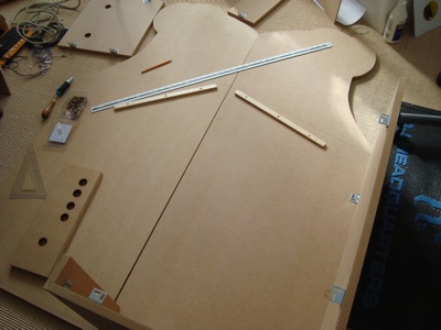

Assembling the cab:

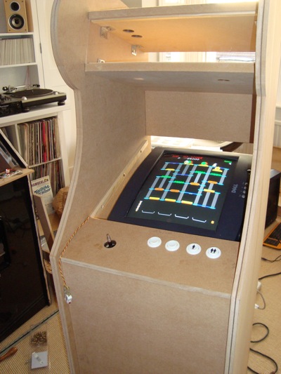

Screen and PC test:
Best progress I've ever made in one day! Artwork to follow...

Could you explain how you did the "large format" print for the top part? I've been wanting to do a bartop sized one of these for ages but getting the curves correct has been the sticking point.
Your artwork is top notch also, care to share them with the rest of us?
Thanks my man. I saved the artwork (just the outlines) as a PDF and got it printed at a local shop that prints up to A0 size. They only print black & white line drawings at that size, which is fine for this.
If you don't have a local place or want to do it cheaper, I've used a program called POSTERAZOR.
http://posterazor.sourceforge.net/
It takes your image and divides it up into standard size pdf pages that you print out, then tape together.
Thanks BadMouth, that's a good alternative. I'm lucky that my local printer does A0 prints for only £3 ($5), plus I never seem to have any ink in my own printer  ;D
