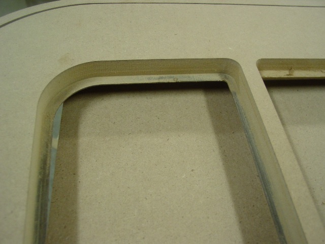

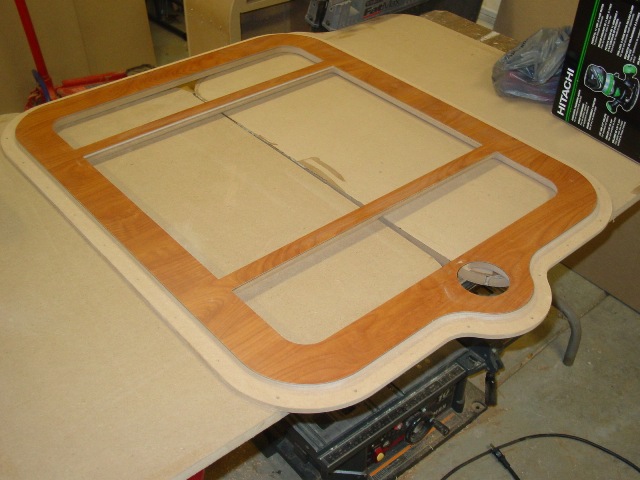

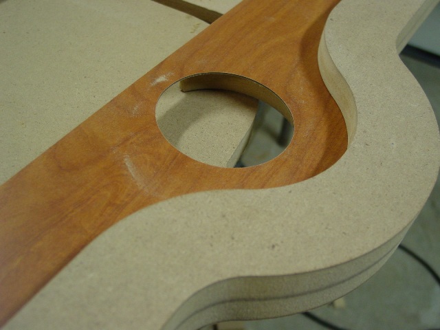

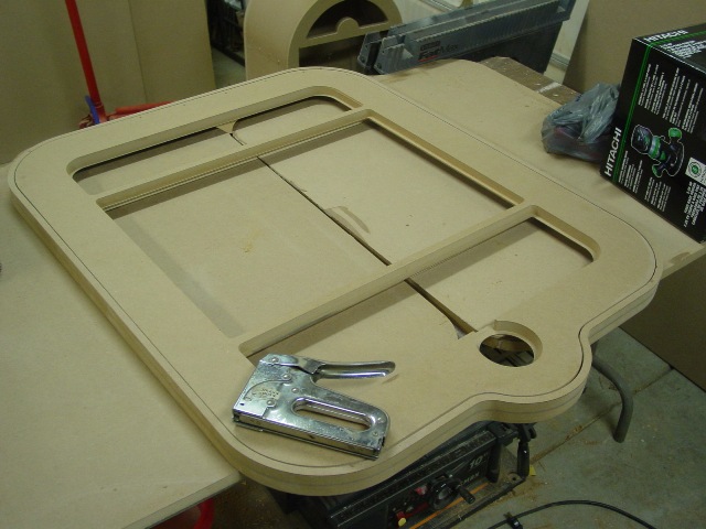

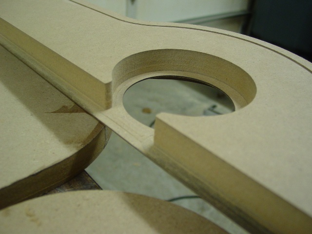

Today I made the center part of the front panel.
It will be glued to the trim piece once it is wrapped.
This piece will eventually be chamfered on the inside and rounded over on the outside. I will be wrapping the trim in this vinyl.
The back of the main panel. Once the trim is wrapped in vinyl, it should fit like a glove. The stapler is there as a reference to the size of this beast.

I was also able to get the front trim wrapped.
Spent some time tonight polishing the acrylic inserts too.
