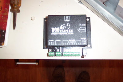

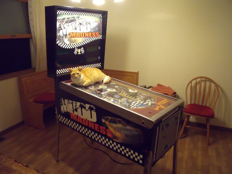

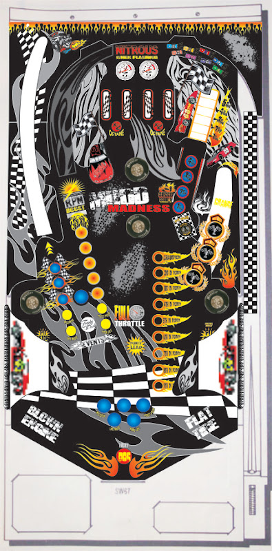

I had on old Gottlieb The Games and it needed some work. No sound, wrecked playfield so I had an idea. I made up some designs and digitally printed a new playfield for it. I scanned the playfeild light location from the manual and drew over it in corel draw to line every up. I used clear vinyl for the clear coat ( just in case I wanted to remove it ). Im in the process now of custom sound. Im using a bootunes controller and micro switches with the aid of amplified speakers. Heres some pics so far:

Are you going to cut out the holes over the inserts, or does enough light get through from underneath to light up the replacement artwork?  I'd be worried about the ball jumping around if the inserts weren't level with the playfield.

I used translucent vinyl for the play field. I think it looks pretty good.
