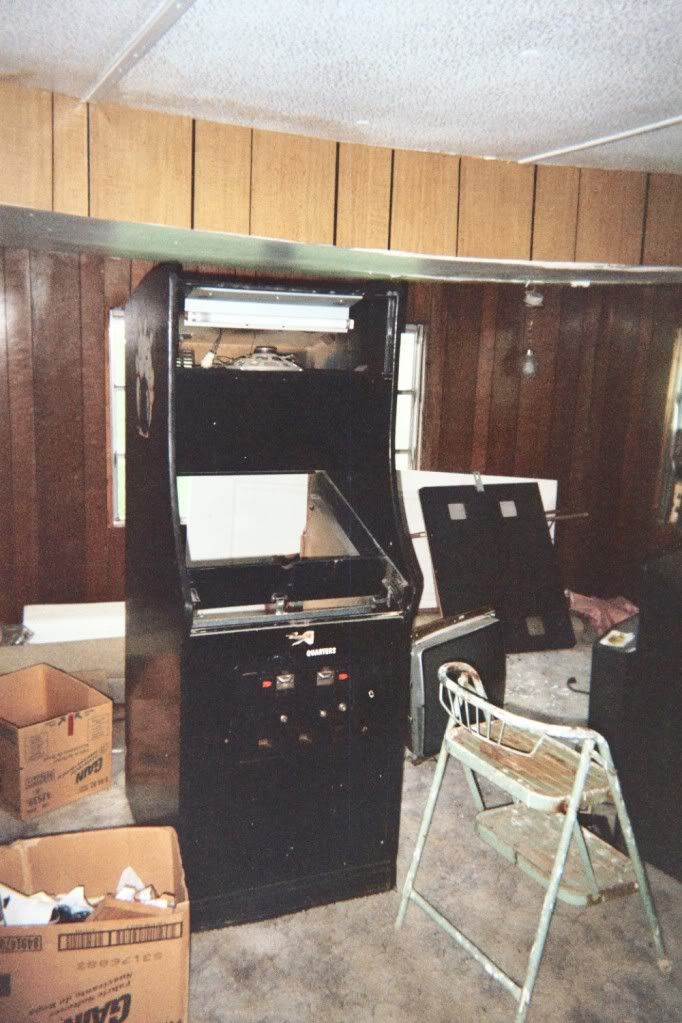

Project J.A.M.A (Just Another Mame Arcade) *working title)
CURRENT STATUS: idle due to time limitations, preparing for tube swap
starting with a joust cabinet that has seen several conversions, finally ending with mk2.
condition is ok, it's solid, although the base has some damage either from water or being moved around (feet are missing), back door will need partial or complete replace, top panel has some modest bubbling from water damage but should'nt be to difficult to sand and pant.
monitor atm is dead, and even if brought back will need a new tube it has HEAVY burn in, which was masked mostly by tinted plexi but is quite noticeable and serious with it out.
coin door is mostly gutted, no coin mech or holder, looks like it was the victim of a failed break in attempt, but should be savable should i get the rest of the parts for it, it's been stripped and painted once before you can see a smooth finish except in corners where you can see some of the old texture that was missed.
I'll be trying to gather the right combination of hardware & software first, im working on getting the controls ironed out & seeing what my options are display wise.
for the cabinets wood problems i'll be doing all the simple stuff first, the base will have ot wait till the end since i dont have space to do major work to the base right now, luckly it is still solid so there is no structural problems from what i can tell.
Project Budget: 300

Cabinet Modifications:
1: add 120mm exhaust fan at top above monitor. add 2x 120mm intake fans on rear door (this may not be necessarily with the celeron)
2. create shelf for computer power supply + mobo.
3. add ethernet jack on back door
4. change toggle switch to momentary push button
5*: add casters to base
6: remove lamenet on side of cab.. [DONE]
im not sure if i wanna do this.. and im not sure how to without damaging anything..
the side panels have been covered with some sort of lament
, im curious if the original joust side art is in tact under it.
the original artwork was under the paneling but it had been sanded down and is beyond saving, this leads me to
7: sand side panels, repair wood as needed, sand again, prime and pant.
