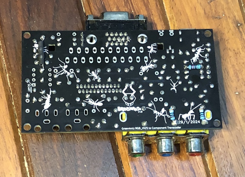

GreenAntz v1.9 is out!
I've recently made multiple significant improvements to the GreenAntz design, including:
1) boosted signal levels and greater accuracy
2) crispier, "faster" (transition/skew rates), sharper image
3) brighter, clearer and more consistent colours (more apparent in games with large areas of a single colour)
4) reverse-polarity protection for external power connection
5) cleaner design
GreenAntz is up to version 1.9 now, and will likely my last revision, at least for this retro-styled through-hole design. I think I've squeezed the last drops of good stuff out with this.
The latest v1.9 PCBs (black) have only just arrived, so haven't been able to assemble any yet.
However, I've already built a "limited edition" batch of the GreenAntz v1.9 design onto these racecar-red v1.8 PCBs. They look hot, if a little Christmassy, and red must be faster right? There are minor "cosmetic" differences. Two (unused) holes are somehow misaligned by a fraction of a millimeter. Some components are different to PCB markings. Otherwise exactly the same as v1.9.
The newer GreenAntz v1.9 PCBs are plain black. So order now if you want red.
These are all VGA units but a SCART version is also available.
In other news:
To go with the improved picture output, I've added (re-instated) a switch to optionally activate a sixth-order "Butterworth" 9.5Mhz low-pass filter built into the main amplifier IC. This tidies/smooths the signal and passes SDTV very nicely, but you may lose a whiff of sharpness and comes with an ~800 nanoseconds delay (<1 microsecond, barely noticeable even to most people who worry a lot about latency). Choose your own adventure. If you want to see what 800ns delay looks like on a video signal, switch this off/on and see the picture shift right by up to 1-2mm (depends on screen size).
Contact me if you want to order. For people who have expressed interest recently, i will try to follow-up. I miss you for some reason, please contact me directly anyway.
Will post some more stuff soon about improvements, picture quality and comparisons.

For people who ordered the black GreenAntz v1.9 a while ago, I apologise for delays getting them out to you. They are on their way now. There are a few good reasons why I had to delay.
Progress
Firstly, I found that my USB oscilloscope (Owon) had been giving me some wonky readings because it was underpowered. New laptop I was using didn't give it enough juice. I rectified that with a powered USB hub, but it meant I had to re-do measurements and calibrations, especially the video signal output levels.
While I was there I re-visited the colour signal voltage references and also tweaked the regulated voltage up slightly to make a better match. This required some more research, thinking, probing, tinkering and testing. Things made more sense now that the scope had proper power.
Once everything was worked out and bedded down, I needed to update the GreenAntz units I'd already built, and test/calibrate them all again, often going back and repeating earlier steps until I was satisfied.
Further Improvements
Video output is even better again now, especially in terms of colour saturation (brighter, deeper, more accurate and consistent).
Best way to test this is to load up Time Pilot (or similar) and leave it on, let it go through the attract-mode screens (blue-green, green and magenta). Magenta (jets) is the best, as it pushes the video channels the hardest overall (if added together). The background colour should be deep, solid and consistent. No shadows or dark patches. The moving clouds should be bright and prominent, outstanding, not grey and not leaving "shadows". You can test blue by starting a game (the first stage background is a deep blue).
Classic-era games with large areas of solid colour are good for this testing this, such as Wonder Boy and Alex Kidd. You may have another favourite.
Sync Autoswitching - GreenAntz is a bit smarter now - smart enough to not need a switch to select between separate H + V sync VS composite sync input. After letting various ideas roll around in my head for a few days, I had a flash of inspiration  8)  It now auto-detects when there is no vertical sync, and quietly slips into composite sync mode. The coolest part of this upgrade is that it is straightforward, doesn't need any more or new logic gate ICs or PCB changes, uses a single ubiquitous cheap part, and can be implemented on the existing PCBs - even older GreenAntz units.

Pics! Back in black, sleek, sexy and always in fashion. There will be a few resistors, maybe a cap, soldered on underneath. These reflect the improvements discussed and they are quite solid, safe and secure, especially once the legs are installed.

Here's a pic of the updated GreenAntz v1.94 with sync LED. I'm currently working on a few to fill orders.
Question: does the yellow sync LED look OK? Or should I go with red? I find the yellow looks too much like green, maybe the red would look better. What do you think?

I'm currently assembling some v1.94 units with blue sync indicator LEDs, so I will be sure to add extra one for you. Will respond to you directly.
As reported earlier, I had a nasty accident. I'd summarise it as like being punched in the side of the chest by a god wearing knuckledusters. Not sure which god, but then they sure didn't give an F about me. It still hurts. Has softened me up, slowed me down, just a little. Every day gets a little bit better, bit will probably be a couple more weeks until I'm feeling great.
Anyways, production is now on again (to meet backorders first). I will get them out over the next few days.
Here is a quick pic of the GreenAntz v1.94 with sync LED. Promise to get some better pics out soon.

Most of these v1.94 units use a blue LED for sync, as some people I asked preferred that, though I did experiment and make a couple with red sync LEDs too. Just wanted to see how they looked. All the units I've just sent out have a blue LED.
There's a lot of customisation on this V1.94 PCB now. Especially in terms of the sync auto-switching and the sync LED, which I installed where no LED was ever originally intended! It took some practice and trial-and-error to get it both working right and looking nice and neat.
