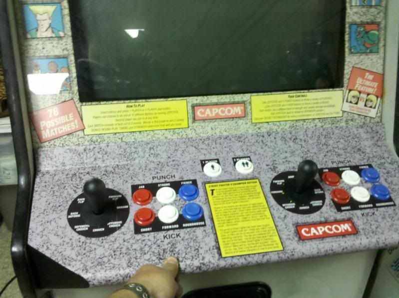

Ordered a replacement ce vinyl. It came while i was away, and though it looked good, upon closer inspection the seller bent/folded the middle which lifted the clearcoat form the base layer right over the player 1 joystick area. Nothing too bad but definitely noticeable. Oh well.

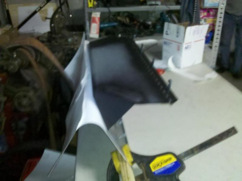

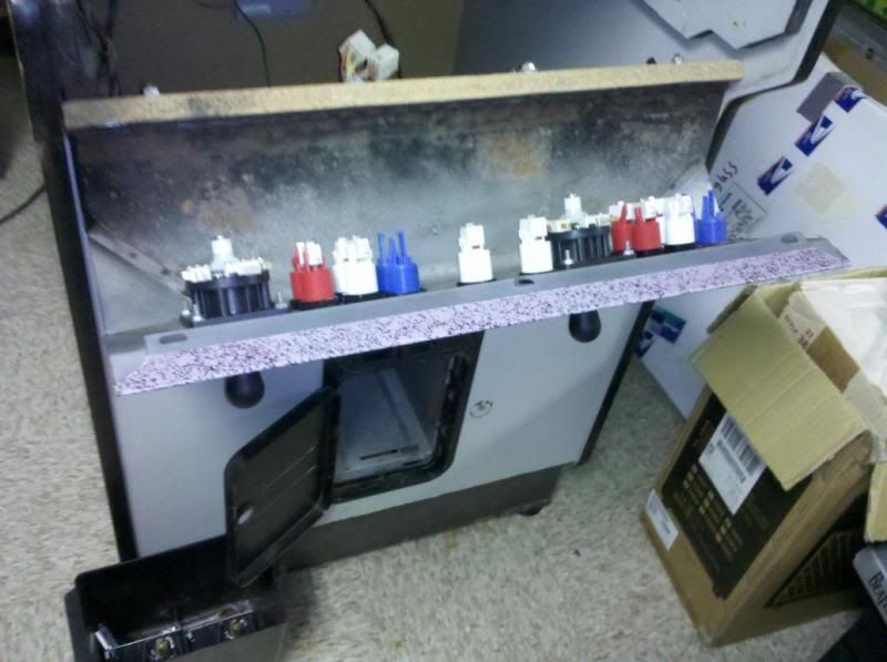

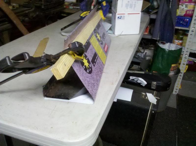

I stripped away the old faded and rotten vinyl with some heat gun and elbow grease. Then i got some goof-off and brake cleaner and sprayed it on and began scrubbing away the goo with a brillow pad.
After that i took a belt sander to the surface side and cleaned up the old rust and black paint. I applied a few coats of rustoleum primer, followed by some semigloss black which i ran out of after 2 coats, so i settled on flat black for the final two coats.
I applied the new vinyl. It was kind of a pain, but I'm satisfied with the final result and definitely learned a lot for next time. I made sure to line up the player 1 and player 2 joysticks in center and let the rest of the vinyl find its place. I used a credit card to get rid of bubbles, and the heat-gun on light and from a distance, so not to melt or shrink the new vinyl.
Here's some pics:
Its cool, but the new vinyl is a darker shade than the faded monitor bezel which is more white. Where they meet up is where the biggest issue is. I guess I'll get used to it but it makes me sad a bit since the machine looks good.

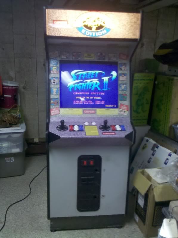

I finished up on wiring it back into action.
She's almost done. I'm just going to reglue/repair the back panel (currently drying), and thoroughly clean her with some magic erasers and some 409 before applying new T molding and calling it a finished project.
