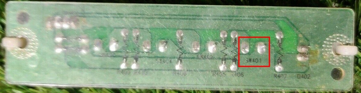

Anyone know where you can buy just the OSD control board for a Betson-Kortek KT-2914 monitor?  My "MENU SELECT" button (SW402) only works about 10% of the time.  This makes the frustrating process of tweaking its many OSD group settings even more challenging.  I'm challenged enough without having to fight this flaky button... :)

lilshawn, looking at the web page of the switch you recommended (TS02-66-140-BK-260-LCR-D) I have a couple questions.
The "140" in this part # indicators an actuator height of 14 mm.  My entire switch is about 5 mm tall.  Is the actuator height is the height of the entire switch?  In this I'll actually want part TS02-66-50-BK-260-LCR-D instead.  Or maybe the actuator is just the button part that moves, in which case the shortest 4.3 mm actuator (TS02-66-43-BK-260-LCR-D) would probably be a better match
These switches all have four posts, but looking at my OSD control board each switch only has two solder blobs on the back side of the board.  Do I just break off two of the posts and only use two of the switch posts?  Or do I need a different switch type that only has two posts?
Below are two pics of why my OSD control board looks like.  On the back pic I put a red square around SW401, you can see there are only two solder blobs.

Thanks lilshawn for the additional details, that button looks like a drop in replacement (once I learn how to solder :)).  I did notice one more thing about my problem that concerns me.  When I press my my "MENU SELECT" button (SW402) it behaves something like this:
10% of the time it does the correct action
60% of the time it does nothing
30% of the time it does the "UP" button (SW403) action
That last "UP" button action has me worried.  Any wild guesses how/why that would happen?  All of the other buttons (including UP) work correctly 100% of the time.  I'm surprised that my MENU SELECT button would frequently send another button's command.  Do you still think replacing my MENU SELECT button will fix this?  Or I have gone into the weird zone where anything is possible?  :)

the way these work is by having 2 wires going to the computer on the main board. when you press the button on the UI panel, it applies a resistor across the 2 wires. (this is what all the resistors on the ui panel are) all the buttons have a different resistor value. the computer measures the resistance on the line and if it's between such and such a value it's this button that was pressed... but if it's between this and that, its a different button....and so on.
typically when these button fail you get a resistance across them when you press it down (usually corrosion, oxidation, or moisture/dirt infiltration)
this additional resistance throws off the reading the computer gets when you press the button, making it think you pressed a different button. (because the value now falls into one of the other buttons resistor value.

Very interesting, it all makes sense now, thanks for sharing.  Sounds like a new button is indeed the cure for this.
