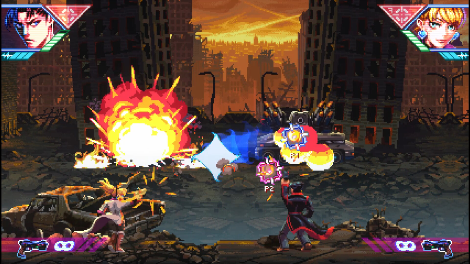

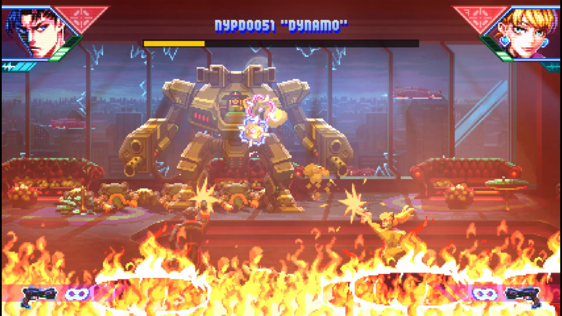

NIGHT STRIKER GEAR
Steam
Native res is 640x360
640x480i@60Hz Correct AR: 16:9 - Black bars top/bottom
854x480i@60Hz Incorrect AR: 4:3 - Fullscreen
Game Settings
Game Start -> Config -> Screen:
Fullscreen: ON
Resolution: 640x360
Bilinear: OFF/ON (Depending on what you want)
Progressive Resolution in Linux
