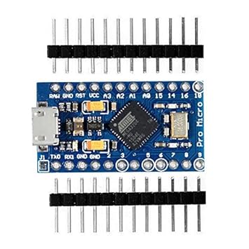

I'm just trying to use the firmwares on different AVRs and maybe modify the source code so I can compile custom firmwares to work with them.
Right now, I'd be happy to figure out three things:
  1.  If the 32u4 is retro-compatible with 32u2 firmwares, which pin on the 32u2 corresponds to which pin on the 32u4?
I can probably find the answer using a gamepad hex and probing each pin on the Arduino Pro Micro.  ;D
  2.  What source code file(s)/variable(s) to edit in order to assign which pin on the AVR handles an input.
i.e. Move KADESTICK firmware Button 1 from 32u4 pin 8 whch is only connected to an LED on the Pro Micro to 32u4 pin 31, an available digital input pin.
  3.  What source code file(s)/variable(s) to edit in order to change the keystroke for a given input.
i.e. Changing P1B1 from "CTRL" to something else.
And I looked at the github page and read for for over an hour on how micro processors programers. My official take away is I would have to do a lot more research before I could even begin to understand what needs to be done.
It is definitely a steep learning curve and we're both near the bottom of it.
If you have a page booked marked that would be a good place to start learning I would definitely take a long hard look.
Aside from the thread linked above, no idea what would be good/useful info.   :dunno

1=https://www.arduino.cc/en/Hacking/PinMapping32u4
#1 shows the pin diff
Unless I'm missing something, that just matches Atmel's 32u4 pin labels to Arduino's 32u4 pin labels. (like a Thesaurus)
I'm trying to translate KADE's 32u2 pins/functions to 32u4 pins/functions. (like a Spanish/English Dictionary)
For example, KADE terminal A2 goes to 32u2 pin 6 which is labeled "(OC.0B/INT0) PD0" and that appears to match up with 32u4 pin 18 which is labeled "(OC0B/SCL/INT0) PD0".
Looks like it will be easy to cross-reference the pins, but the devil's in the details.  >:D
KADE terminal A1 goes to 32u2 pin 5 which is labeled "(PCINT11/AIN2) PC2" and that appears to match up with 32u4 pin . . . nothing -- no "PCINT11", no "AIN2", no "PC2".
Only 16 of the 24 KADE terminals appear to match up to a 32u4 pin.  * Cue Meatloaf singing, "2 out of 3 ain't bad."
Terminal|Minimus label|32u2 Pin#|32u4 Pin#
A1   PC2   5   ??
A2   PD0   6   18
A3   PD1   7   19
A4   PD2   8   20
A5   PD3   9   21
A6   PD4   10   25?
A7   PD5   11   22
A8   PD6   12   26?
HWB   PD7   13   33?
A9   PB0   14   8
A10   PB1   15   9
GND   GND    -     -
B1   PB2   16   10
B2   PB3   17   11
B3   PB4   18   28
_4   PB5   19   29
B5   PB6   20   30
B6   PB7   21   12
B7   PC7   22   32?
B8   PC6   23   (29? 31?)
RST   RST   24   13
B9   PC5   25   30?
B10   PC4   26   ??
V+   VCC    -     -
Am I missing something?

  • Posts: 9794
  • Last login:Today at 03:10:51 am
Re: Using KADE firmwares on different AVRs
« Reply #6 on: January 24, 2017, 02:13:13 am »
  The beta Arduino board has been renamed as:
    KADEuino (atmega328)<
the board never built ? or never supported right ? or mis named ?
1.  This board was never developed into a KADE encoder.
2.  There is only one proof-of-concept firmware (LED BLINK TEST) that was made for this board. (Arduino Pro Mini)
LED BLINK TEST
This is a test firmware which will verify the two onboard LED’s (Red and Green) and the single onboard reset button.
To test, program the KADE with this firmware and connect to the device to a power supply or USB port. A Successful test will give the following results.
The green LED will remain on at all times.
The red onboard LED will flash quickly.
While the reset button is pressed the red LED will remain off.
Right, so all being well, you are ready to check out some seriously cool firmware for your KADE.
3.  It's still supported in Loader. (see the "Board Options" pull-down in the left column)
4.  The downside to the 328 is that it lacks on-board USB support.
Connect your Arduino Pro Mini device to a USB port via a serial programmer cable.
5.  IIRC the 328 bootloader is similar to (or the same as?) the 32u4 bootloader so someone talented enough to update the code for Loader could probably add support for a 32u4 board relatively easily.   ;D
6.  Even if 32u4 board support is added to Loader, someone will need to write/adapt useful firmwares for that board.   >:D

Just finished testing the default KADESTICK 2-axis firmware on a knockoff Arduino Micro.
Everything worked as predicted.
- Analog inputs and buttons were on the expected pins.
- "Hat Down" is not available since 32u4 pin 22 is only tied to TXLED on the Micro board.
The next step is to modify the KADESTICK 4-axis source code and compile a HEX for the Micro and Pro Micro boards.

Bruno is making great progress on the (completely rewritten in C++) miniArcade 2.0 Mapper program.   :applaud:
In just the last week:
- We've worked out the issues with the analog inputs in the gamepad firmware.  You can enable up to 5 analog axes.
- He's added a customizable keyboard firmware.  You can select which keystroke will be on which port.
- I've documented the miniArcade 2.0 board layout to 32u4 pinout/ports and created a graphical cross-reference.
There are still a number of things to be added/tested/refined, but we're making measurable progress every day.   ;D
