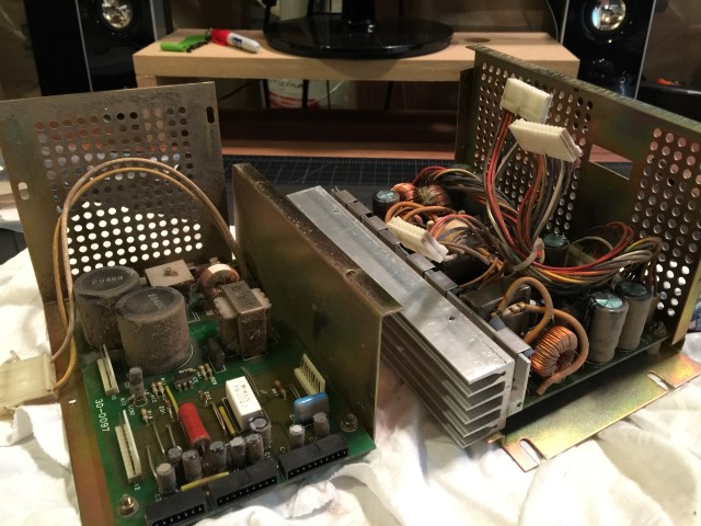

Well if you thought washing a monitor was controversial...how about this?
I'm trying to track down this annoying speaker hum and siren sound on my fugly DK...so I figured what the heck...I'll cap the power supply. I took it out of the machine and cracked it open. (BTW...Nintendo must have hired a gorilla in their power supply factory because I stripped 2 screws trying to get this beyoch open.
It was filthy so I washed it in simple green of course! (gasp!!!) Used a paint brush to get in the tough spots. Then rinsed it off with a spray bottle with water.
Here is the aftermath of snot that came off the 2 power supply boards
I propped them up in front of my space heater for about 10 minutes. And then let them sit for a few days.
Of course I used another one of Ian Kellogg's shaweet cap kits.
Soldering these caps was was a real PITA. Really huge globs of solder followed by very small tacks of solder. Some spots were dangerously close.
For the record...I'd rather cap 10 CRTs than cap a Nintendo power supply again.
All said and done, I think it was 27 caps inside that monster. Sheesh!
And for those of you that like before and after pics..
I then threw it back into the DK and fired it up. (Not gonna lie...I closed my eyes and flipped the switch with a wooded broom handle. lol)  BUT, no sparks, smoke or fire. YAY!
Next step was to check all the voltages coming off the PS. So I used my crappy Harbor Freight mulitmeter and got 5.1v, 12v, and 24v where appropriate.
Now that the voltages checked out, I threw in the 2-stack DK PCB and fired it up.
The Good news: The game still works and plays fine.
The Bad news: Still have that hum and siren noise. (However, I am giving up on the "hum." I'm told that I need to stop wasting my time as all Nintendo cabs do this....guess I never noticed it)
So I'm back to tracking down the "siren" noise. I'm going to look at the transistors on the PCB again.

OK, so I've made some progress. The "hum" sound that my DK speaker was making was driving me absolutely bat----steaming pile of meadow muffin--- crazy so I had to fix it. However, I learned this "hum" sound is actually totally normal for Nintendo cabs. Why? Well, it's actually a design flaw. Nintendo thought it would be a good idea to have the audio amp draw its power from the monitor chassis. Thus, the audio amp picks up interference from the monitor and outputs it through the speaker in the form of a "hum" sound.
So how do you fix that? I purchased a $16 12v-amp from Amazon.
This little amp will now draw 12v directly from the unused 7p power headers on the power supply. Pulling clean, non-noisy power. Here you can see it from the back of the cab. Jankey-ly hooked up but working nontheless. NO MORE HUM! YES!
And a view of it from the coin door. I'll decide later where to permanently mount it. Anyone interested in eliminating the "hum" sound in their cab, I think this is a perfectly good solution.
Now I just have one issue left...That annoying "siren" sound that repeats in the background. It's definitely coming from the PCB. Grrrr.  :banghead:
