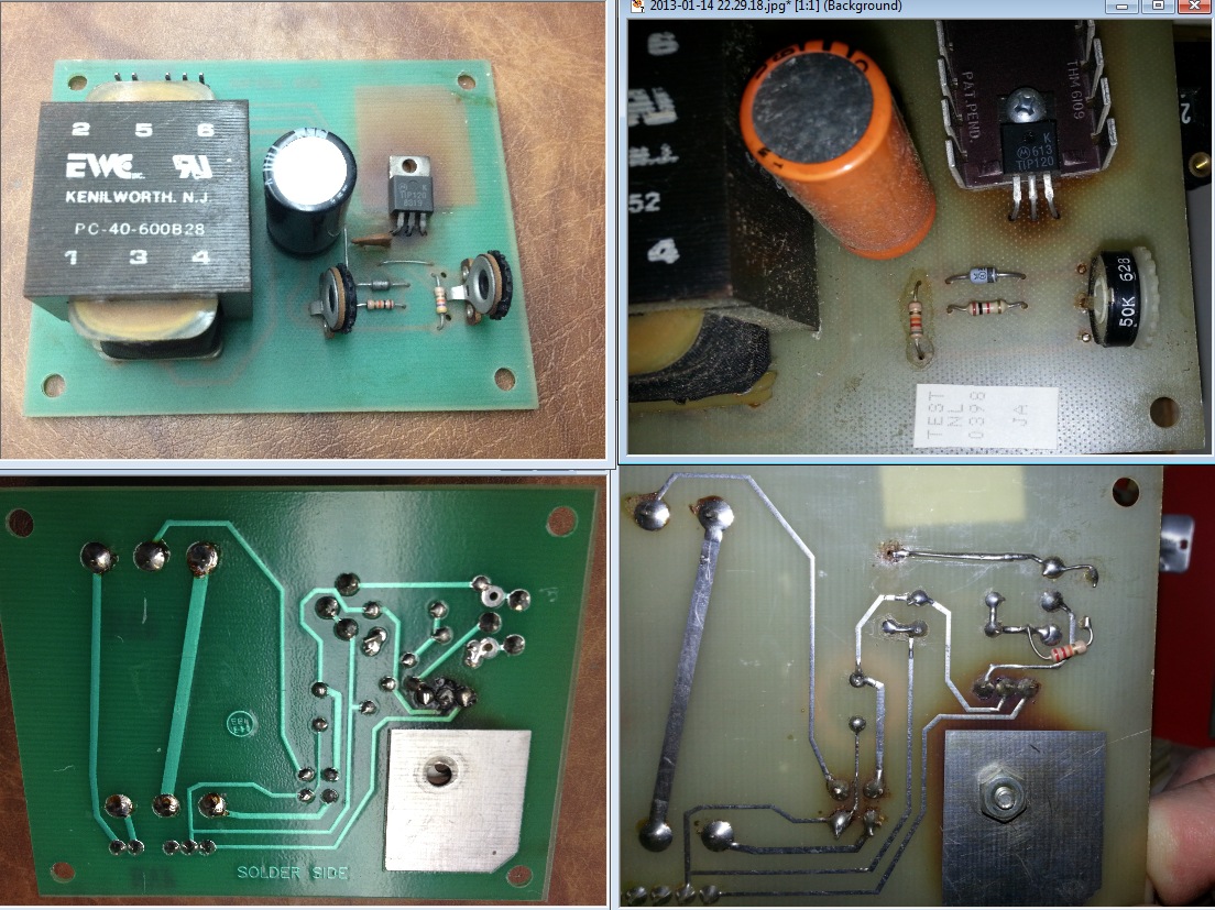

Hi folks,
Does anyone know what ratings the thumbwheel pots should be on the old 2-button / 3-board Grayhound cranes? I have a modified crane, with a missing back pot. The front pot is 50k and even at max setting, the claw is a bit weak. The back pot has been replaced with a regular resistor. I'm trying to find out what rating the back pot needs to be, and whether the front 50k pot should be replaced as well.
Thanks in advance!

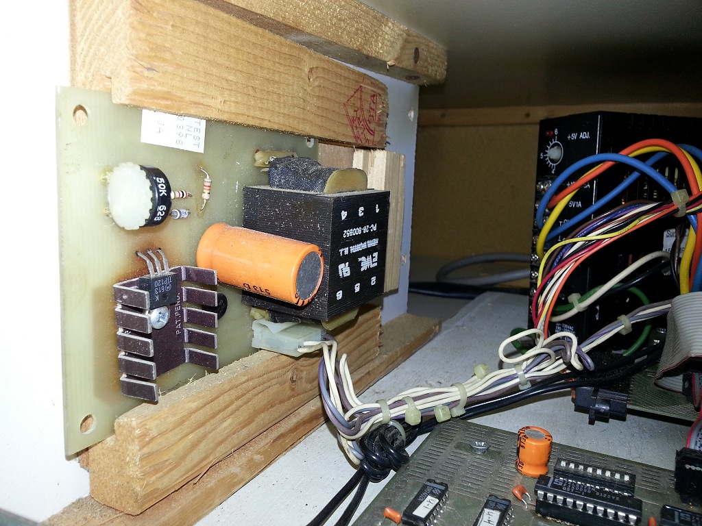

Thanks... I actually tried getting a reading through the two white wires coming out of the plastic connector as mentioned in the manual, but it caused my whole machine to act really weird for a while, so I'm kinda scared to touch it again...  :-\
The resistor labeled #2 is actually supposed to be a another thumbwheel potentiometer. Someone replaced it with a resistor, so it's no longer adjustable. I was just wondering what rating another pot would have to be if I replaced that resistor with another thumbwheel pot.  Not sure if I really need to do this, but it would be a nice to have an option to adjust it.

well if that resistor is grey/red/orange it's 82k
if it's too weak, i'm pretty sure its supposed to be another 50k pot.

to be sure, i'd have to see the backside of the board and see how everything is connected. you have a MOSFET there, so there is a possibility it's being used as a PWM switch to regulate the power output.
not the best way of doing it, but i suppose it works.
the modern equivelent is using a pot hooked to regulate the speed of a 555 timer. the 555 switches a transistor or MOSFET to regulate the claw strength via what is called "duty cycle". faster pulse means more power slower pulses means a weaker pull.

Thanks for the info. I actually spoke with one of the Grayhound techs and he's sending me a replacement board with both original pots.

lol.. I hear ya. Actually, I misunderstood. He sent me the missing pot, rather than the whole board. However, looking at my board, it seems to be somehow different. If there was a pot in place of my current fixed resistor, there should've been 3 holes in the board, but there's only two. And there is another resistor soldered on the back of the board. So I'm not sure how exactly to go about soldering on the pot he sent me. I have asked for a quote on a new board. It might be easier just to swap it out rather than try to mess with this one and keep it as a spare. Here's my board...
Front

Looks like a replacement board might be the best way.

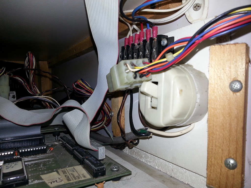

Sure.  It's button type, but I'm pretty sure it can be rewired for joystick and operation can be selected via dip switches.

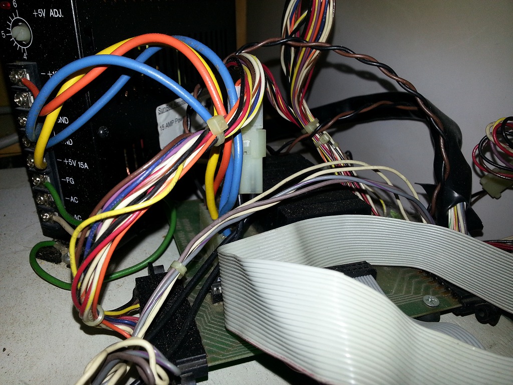

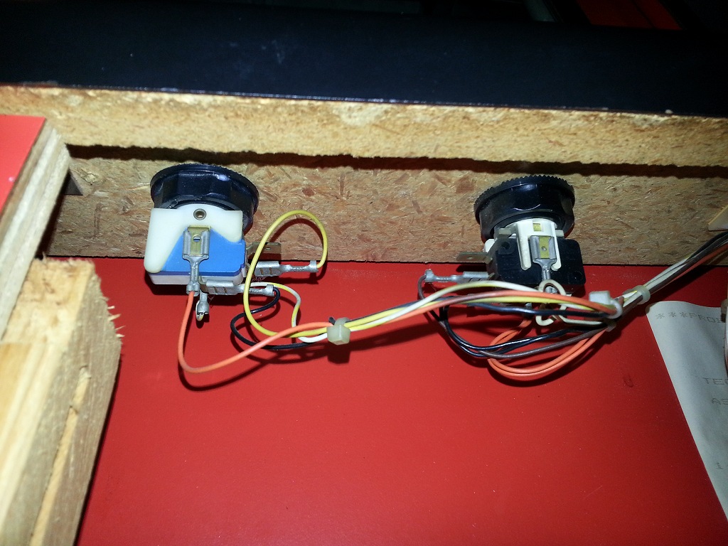

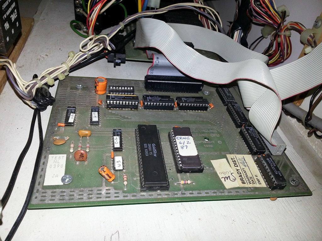

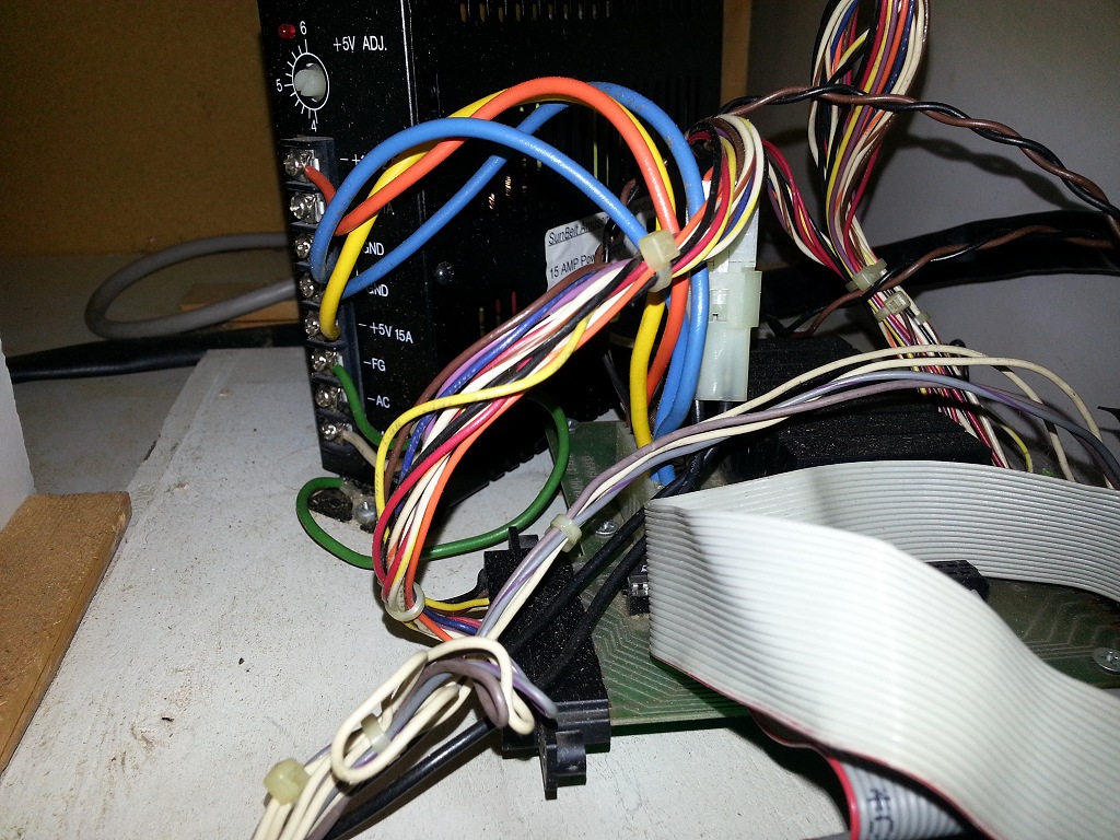

Sorry about that. Here are the pictures:
http://www.betheclaw.com/images/grayhound/wiring/1.jpg
http://www.betheclaw.com/images/grayhound/wiring/2.jpg
http://www.betheclaw.com/images/grayhound/wiring/3.jpg
http://www.betheclaw.com/images/grayhound/wiring/4.jpg
http://www.betheclaw.com/images/grayhound/wiring/5.jpg
http://www.betheclaw.com/images/grayhound/wiring/6.jpg
http://www.betheclaw.com/images/grayhound/wiring/7.jpg
Let me know if you need anything else. I'm glad you were able to talk to Scott. He seems like a genuinely nice man and very knowledgeable about these machines. Yes, he does have replacement boards and you may even be able to swap 3 boards with a single newer one (not the cheapest option, but I'm considering it).
I'll look into the joystick wiring option, although on this particular crane, the front door opens right above the button panel, so if there was a joystick sticking out the top, I wouldn't be able to open the door to access the play field. I'd have to figure something out about that. Maybe wiring 2 additional buttons for left and back, and a drop claw button instead of a joystick is a better option.

Great, thanks for the pictures.
My CPU board does not have sockets like yours does for the IC chips. That is a nice feature. I'm at the point now of changing all the IC's since I don't know what is wrong with my unit. I fear the actual programmed ROM has gone bad but I have no way of checking it against a working board. I purchased a full set of replacement IC chips including the Z80A CPU chip but don't really know which (if any) IC's are bad. We will see what happens when they get here.
The only IC's that are socketed on my board are the CPU and ROM chips. I will swap out the CPU chip when I get it to see if that fixes the problem. Its worth a shot. Bottom line is I would really need a working spare CPU board to test against. Just for reference below is what I am experiencing with my cabinet:

Also as far as the crane power board with the fixed resister, he sent you a replacement 50K resistor right? there’s no way install this resister to your board?
I believe he said replacement claw board is about $50 (used). There probably is a way to install it, but it seems that resistor wasn't the only thing modified on that board, and solder points are different, so just soldering the resistor on the board may short / fry something. I'd rather not take any chances. I could always mail the board to him, but in the end it may be cheaper just to buy another board and keep this one as a spare.

« Reply #24 on: January 18, 2013, 03:11:58 pm »
Actually, yes, if you wouldn't mind showing the bottom of the smaller claw board - that would be great. He might be willing to work out a deal with you if you have to replace it... maybe take yours as trade, not really sure. Worth asking.

Here are the pictures.
I think if you attach the two outside leads of the variable resistor into the circuit where those fixed resistors are then connect the middle lead to either one of the outside leads it should be fine.
Oh boy... I compared the boards - maybe I'm a little unsavvy in the PCB department, but I couldn't make any sense out of this whatsoever. Looks like a bunch of stuff needs to be moved around and even new holes made in the board, and I seem to be missing one resistor that you have on your board. I think I'm just going to get another board from Scott... that way I don't risk messing something up.

hi
btw thats called a buck board
the 2 post's set a current b power
if your look's nothing like that ? then do not mess with it
ed

Also have you tried to trace out the pics of my board I posted? You can definitely solder a variable resistor in there. Any luck?
I did try, but it seems more modified / different from yours so I couldn't make much sense out of it... :(

Just an update to my situation:
I ordered one of every IC chip on the CPU board and they arrived the other day. I swapped out the Z80 CPU chip first since it was one of the few socketed chips on my board.
After swapping it out I turned the machine on and the revision codes flashed quick, '06 02 19 87' then the machine attempted to home it self. It began moving forward but when it reaches the front the limit switch clicks and it doesnt stop.
I tested the continuity of the front switch and the continuity from the switch down to the board and everything is making connection. I also checked continuity from the switch to the CPU board.
I decided to change the IC that controlled the crane limit switches. This IC was U9.
After replacing this IC the crane was homing correctly and the coin light and coin lockout would activate.
The machine coins up fine then while playing the crane would automatically go left. If I pressed right on the joystick the crane would automatically go back to the left upon release. After verifying the wiring I decided to replace the ICs which controlled the joystick inputs and crane motors. These ICs are U8 and U11. After replacing these ICs the crane was moving properly during play.
Now during play when I press the crane button the crane drops down but when it reaches the bottom of its movement the claws do not close. I tested the input line voltage to the board with the transformer on it and it read 115 V but I could not get a reading between the two white lines going to the solenoid.
Can you tell me the voltage of your 'white to white' wires going from that transformer board to the solenoid when the claw is moving up and returning home after grabbing a plush?
Thanks for the help.
Wow... very impressive. I'm glad you were able to get it to work, mostly. I'll check it for you within the next day or so and let you know. Have you checked the voltage at the point where the black telephone handset style claw wire connects to the coil in the claw cylinder? That wire may have a break in it.

I put the multimeter leads on the white connector located on the transformer board and it read nothing. I will try to test continuity of the black stretchy coil wire later to see if there is a break.
My CPU board is REV-2 also and the ICs are not socketed. As I replaced the ICs I added sockets so I can swap them out down the road if I need to. I will post a pic when I can.
Are you referring to the green wire located in the bottom left corner?
BeTheClaw.com
  • Posts: 38
  • Last login:February 27, 2013, 03:31:54 pm
Re: Grayhound Skill Crane - potentiometer ratings question
« Reply #46 on: January 28, 2013, 02:51:27 pm »
Yeah.. this one:
Metalman1661
  • Posts: 32
  • Last login:October 15, 2019, 01:07:02 pm
  • I have experience with building MAME cabinets.
« Reply #47 on: January 28, 2013, 03:07:40 pm »
Yup thats the one I have too. Connect it to the FG terminal on the power supply:
BeTheClaw.com
  • Posts: 38
« Reply #48 on: January 28, 2013, 03:13:32 pm »
Thanks!!! Looks like ground, I guess...
Sorry, I tried, but for some reason, I'm only getting "1" on display of the multimeter. I have it set to 20VDC. Not sure if it needs to be something else, but according to the manual, good setting should put out around 12V.
On a side note, I got some claws from Rainbow to simulate a Sugarloaf Toy Shoppe crane. Quite fun :)
This is the largest one. I have a couple of smaller ones as well. One medium plush and one jewelry. The original Grayhound claw is way too small for my taste.

not 100% sure, but by the looks of that power supply board design, you might need to read AC not DC  :dunno
can't hurt to try it.
True.. but manual does say it needs to be set to VDC...

Did you measure the voltage when the claw was closed/returning to home after a play? That should be the only time you will get a reading to the solenoid.
I looked up the datasheet for this transformer and it does say the secondary is in volts RMS although I distinctly remember measuring DC voltage across a resistor at some point.
I'm just a little lost on how I can test to see if my solenoid is bad or not or to see if that coiled wire is no good.
BeTheClaw.com
  • Posts: 38
« Reply #53 on: January 29, 2013, 11:59:51 am »
Yeah, it was reading 0 at idle, and 1.0 when claw was closed. Grayhound manual says you should aim to set the rear pot at 10V and then add 2V with the front one for a total of 12V. Are you not getting any reading at all from the white terminals? Maybe you could try measuring current into from the other two wires to make sure power is being supplied to the claw board in the first place. If you run out of options, I could send you my original board (temporarily) for testing purposes.

I unplugged the terminal from the transformer board and measured voltage across the black and grey wires (AC input) and it read around 115 Vac so I know power is getting to the board.
Which manual are you using? I ask since the two manuals I have stats the voltage should be 0-30 Vdc or 10-25 Vdc.
Attached are the two manuals I have been looking through.
BeTheClaw.com
  • Posts: 38
« Reply #55 on: January 29, 2013, 01:32:59 pm »
The 2nd manual, Grayhound_Crane_Schematics.pdf, on page 3 says to set the rear pot on 10 VDC and then add 2 on the front. Thanks for the supplement! That will come in handy someday.

I also noticed we have different transformers on our boards. I'm referring to your old board. This may have been a reason why we had a different amount of components from each other.
Hmm.. really? They look the same to me  ???
Metalman1661
  • Posts: 32
« Reply #58 on: January 29, 2013, 02:11:43 pm »
The model number on mine is "PC-40-600B28." Your model is "PC-28-800B52."
According to the datasheet I posted earlier they have the same output but are different.
EDIT - Actually after looking at the datasheet aain it says the secondary output for mine is around 40 V while yours is around 28 V.
Also I can confirm the output to the coil is DC since there is the bridge rectifier in the circuit directly after the transformer output. I totally forgot that was there haha.
I will post my finding later.
« Last Edit: January 29, 2013, 02:25:35 pm by Metalman1661 »
BeTheClaw.com
  • Posts: 38
« Reply #59 on: January 29, 2013, 02:26:57 pm »
Ah.. yeah, not quite sure why I wasn't getting a reading on mine. I had the multimeter set as shown below... the only thing I can think of is that my black terminal is missing its end, so it's just bare wire, but I doubt that could make a difference.

I see you have the red lead coming from the amperage terminal. To test voltage you must have the red lead coming from the Voltage terminal below that one. The black terminal is fine as well as the dial setting (20Vdc).
After swapping the terminal on the meter, measure the voltage drop across the two white wires (DC + and DC -). You should get a value as the claw closes (either positive or negative but the same number regardless)
If you connected the meter to the circuit as you described with the red lead in the amperage terminal I would expect the reading to be zero or close to it.

Ok so I tested continuity between the two input wire to the solenoid and I got nothing. I did get some beeping as I opened and closed te claws by hand.
I read the voltage drop across pin 1 and 2 on the transformer and it was only around 30 volts. I'm assuming that is since there is no load(the coil) on the secondary side.
Can you test a few things with your setup? Can you test the continuity of the claw coil? Also can you test the continuity between pins 1 and 2 of the transformer?
Did you manage to read the voltages?

Put the meter on continuity setting (looks like a sound symbol). Test to see if it works by touchin the two leads together , a beep should sound.
Touch the two input leads to the claw coil (on the white connector that starts the coiled wire". See if you have continuity.
On the transformer, touch pin 1 and pin 2 in the same matter (transformer labeled on the top). Does it beep?

My meter doesn't beep for some reason.. but when it's set to the continuity, it shows 1. When I touch the wires, the number starts fluctuating, which I guess is an indication of continuity. That said, there's definitely fluctuation of numbers between transformer pins 1 and 2, and the two wires of the coil...which I assume means continuity. And for the life of me, still can't get a voltage reading to the claw. I actually had the red lead connected to the other port (not how I showed it in the picture). And that's the one that gives me a reading of 1 or less. When connected to the other port (like in the picture), no reading at all.

I figured the coil of the claw (solenoid) would have continuity from one lead to the other since it is just a coil. Mine does not however and I thought possibly the coil was not good.
Similar situation with my transformer. pins 1 and 2 are the two input pins for the primary side o the transformer (primary coil). I think this may be due to the transformer is in the circuit though.
It would be great to have a spare transformer board that I know works.
