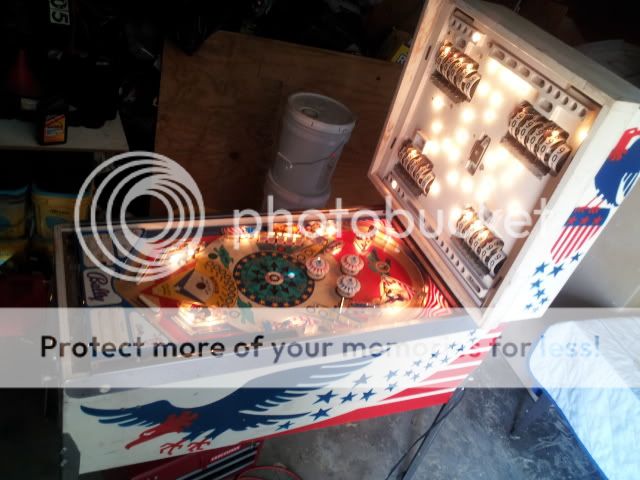

Well yesterday I bought my first official pinball machine off Craigslist.  It's a Bally Freedom pinball machine.  Purchased for $150.  I figured it's cheap enough (to my thinking anyway) and would be a good project/learning machine.  If I can't get it to work I'm not gonna be out a grand or more on a newer pin.
I purchased it in unknown working condition but from what I could see the cabinet and backbox artwork were in good shape as well as the playfield and the plastics were in great shape.  Not sure if they were replaced previously or not.  The backglass is missing though.  Gonna be a problem finding one I bet.   But I brought it home, opened it up, and did some light cleaning.  Nothing special just getting the layout of everything and making sure there wasn't any loose pieces that could cause bigger problems later on.
Today I went and purchased some 3/8" bolts to hold the backbox on (since those were missing), plugged it in, and hit the power button.  To my suprise the ligths came on and didn't see or smell smoke.  Good sighn I thought to myself.  Then I hit the start button.  The machine went through it's reset phase but wouldn't stop.  Found out it had to do with the player 1 score reel.  One of them wasn't resetting like it was supposed too.  Got that working and the machine seems to play perfectly.
I need to clean it up, replace the rubber and drop targets, find some coin mechs and a back door, and do some slight cleaning of various contacts, etc and it will be at least a playable machine.  I say at least because it will still be missing the backglass.  Might take me awhile, if not forever, to find one.
Anyway onto pics.

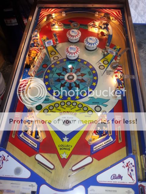

Haven't posted a picture of it in awhile either so here's a current pic.
Don't know why the picture is rotated. It doesn't look that way on my phone. Hmmm.

TopJimmyCooks
  • Posts: 2097
  • Last login:February 06, 2024, 12:19:16 pm
Re: Bally Freedom - My 1st pin + restoration
« Reply #12 on: January 03, 2013, 02:30:28 pm »
you got a backglass!  nice!
