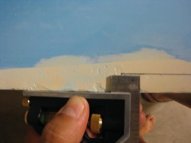

Ok, After coming up with 3 ideas,
1. Replacing the whole sides of the arcades. (costs $300 materials included quote from a woodshop in town.) Due to size and glueing and stapling the side back with the other wood parts.
2. Using a "L" shape angle aluminum to go over the entire back side, it would be attached to the back door and would cover the corroded edge with the aluminum. (I would of painted the "L"shape black to match the entire backing ) cost: $5.99 for a long L shape aluminum at LOWES
3. Cut the 1/2 inch edge off and make a whole new back door. The back door needs to have enough length now to cover the 1/2 centimeter width no both sides..
I chose the third, cause it would not only look better it would be a perfect fit for cabinet. Although I do have to replace the whole back door it would look much nicer. Ill also need to make a groove on the bottom so it can fit inside the lip near the AC cord is.
take a look below and tell em what ya think..
First the measurement. 1/2 inch edge will be coming off. Time to get a jigsaw
This has to be evenly straight down all the way.
This is after the edge was cut and sanded with a 220. This edge needs to be smooth to it can be even, so the back door will sit in properly.

I hope you wore shoes while cutting.

 :lol Yeah I wore shoes, I believe it was just for pictures ,also my girlfriend wanting to see the progress of the cabinet.

Im posting a message from ckong and I in defense of my edge work. I felt the compliment should be on here as well.. :angel:
UPDATE
I added the wheels to the base of the cabinet. I went to OSH and got em
2 swivel wheels in the front for turning and moving the cab.
2 stationary wheels in the rear to keep it steady.
Also the base board on the bottom is cut to specification and reinforced with screws and glue.
We had to add a 1/2 board to the bottom of the wheel frame so it would provide reinforcement to support the wheels and wont weaken the nintendo cabinet.
Also so the wheels can sit lower than the baseboard and move freely.
I am proud of the way it came out. Very sleek and you can barely see anything under there.
With much respect to Sirpeale to not add em, I believe the "Right" way to move cabinets are "carefully".
Although arcade companys added 2 wheels on the rear to tilt em back and roll em. I think it was part of a manufacturing design for warehouses /stores/ arcades and the productive way to maneuver them.
Handtruck is a very good idea and it does take alot of weight out of moving it alone....
Ill roll it..
Take a look..
Special Thanks to "MAC" of Quality Woodworks for helping me out ! :applaud:
After sanding the cabinet, I primered the whole cabinet with Bin Zinsser Primer.
I sanded it twice and smoothed it out again.
After smoothing this out with a 220 grit. OVER AND OVER. It finally was ready to be painted.
I want to give a "Special Thanks to Neilyboy" for doing a awesome job on his Donkey Kong.
His blog provided the color code to get a exact color on the cabinet.
She painted the blue, I did the black paint ! TEAMWORK !!
My girlfriend is stoked about this project and always gives a hand, Shes the freakin awesome'est !!!
I was doing the black on top and the side edges.
Not bad at all, The speaker grill was painted along the inside ridges.
You can get a better idea of where the back door cover will fit into the back. Also you can barely see it. YAY !
I taped the wood monitor base so it wouldnt get black paint all over it.
I sanded the insideof the cab, I didnt primer it cause it wasnt that bad at all. Just a lil 220 sandpaper and it was smooth and ready for 2 coats of black.
My edge painted ...... :)
Ah at last the nintendo label... This makes it authentic...

Nice job. On the sides where the T-molding will be, did you (roller)paint about two mm's over the edges? I ask because else you might end up seeing a visible very thin white line of the primer after you applied the T-molding. I had this 'problem' on some parts where the T-molding was, so I  applied some paint at the wood on the T-molding areas as well, and everything at the T-molding edge is now smooth blue (or black).
Crabboy
  • Posts: 46
  • Last login:October 03, 2012, 04:29:24 pm
Re: -----------"DONKEY KONG RESTORATION"------------------
« Reply #28 on: December 16, 2009, 02:19:57 pm »
Thanks Ckong  :) When my gf rolled the blue I asked her not to go over the edge. Just so she wouldn't accidentally roll the blue on the black etc etc..
After it was done, I dabbed it with a foam brush lightly. Since the T-molding would go over it. On the inside, I did it with the black..
I didnt think we would all have the same ideas in making it look good in any angle. Good to know, were all pretty anal about our machines looking good .. :applaud:
