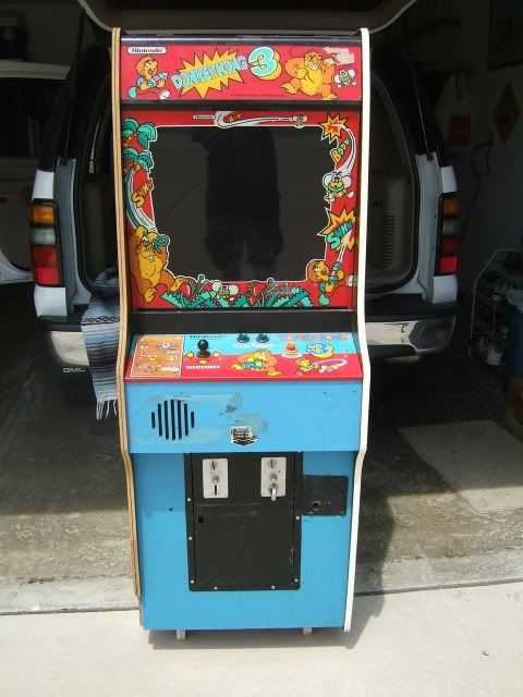

So after some wheelin' and dealin', I bought this Donkey Kong 3 cab for $100. Didn't even see it until I picked it up and oh boy! Its got all original wiring, joystick, buttons, monitor, and coin door. The coin door even still has the duct tape blocking the "straw trick" on the hinges!
The GOOD!
I bought it with the understanding the the monitor had been screwed up in a botched attempt at a cap kit. The guy capped it, then it stopped working. I brought it home, fired it up and saw some pretty color streaks. Looked at the FULL adjustment sheets still stapled to the back door to locate the horizontal hold and brought the monitor to a nice crisp picture. Guess the cap kit wasn't really botched.
Also, the controls are all original (original DK colored buttons!!) and work great. Need new switch leafs for the joystick, but great otherwise.
All of the wiring is stock 2 board Donkey Kong and nicely in place.
The BAD
No sound, probably an audio cap kit in need.
Bezel and marquee brackets rusty as well as the coin door.
Coin door is a little bent (READ ON)
The UGLY
Theres a corner missing with foot tall split up the side.
No base.

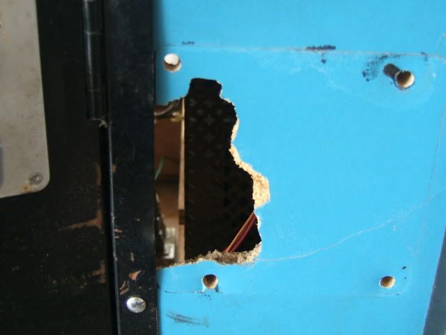

Hand size hole next to coin door under plate next to coin door. I figure the machine was broken into.
QUESTIONS!!
What type of bondo should I be using?
How should I go about fixing that hole? Its way bigger on the inside than it is on the inside. Wood patch first?

Don't use wood filler.  Stick with straight up bondo body filler.  Screw a piece of plexiglass on the outside and lay the cab on it's front filling it from the back, slowly filling the whole building it up.  You may add some fiberglass tape (on the inside) to add some structural support. When it's cured, remove the plexi and do a quick touch up on the front.

Yes, it's the same Bondo for use on a vehicle. You can probably repair the damage on the side of the cab with it, but it will be a job to repair that fist sized hole with it. I seriously doubt it would hold up very well on that, there is only so far you can go with bondo. Seems to me the easiest thing to do with that section would be to simply replace that entire panel with new wood. You have the old piece you can use as a template, simply route a new one using a flush bit. The other option is to cut out the bad section around the hole and make a patch out of some new wood, then use the bondo to blend the old wood with the new... kinda like how you patch holes in drywall. Hope this helps.

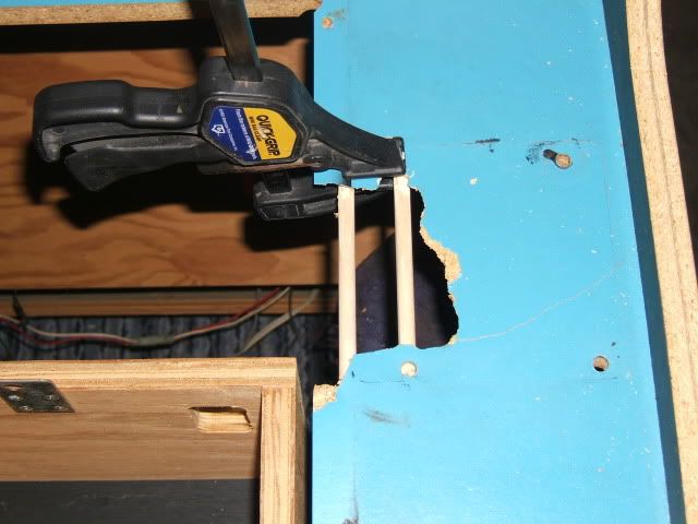

If you want something for the Bondo to grab onto, here's what I'd do:
1) Cut even more of the hole out so the edges are flat.
2) Get some dowels.  Something pretty small, of course.
3) drill holes in the hole edge the size of the dowel.
4) insert dowels into holes.
5) Start with the Bondo.

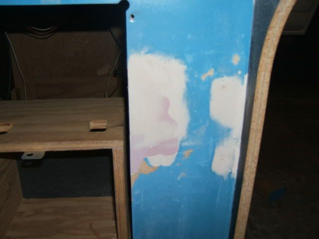

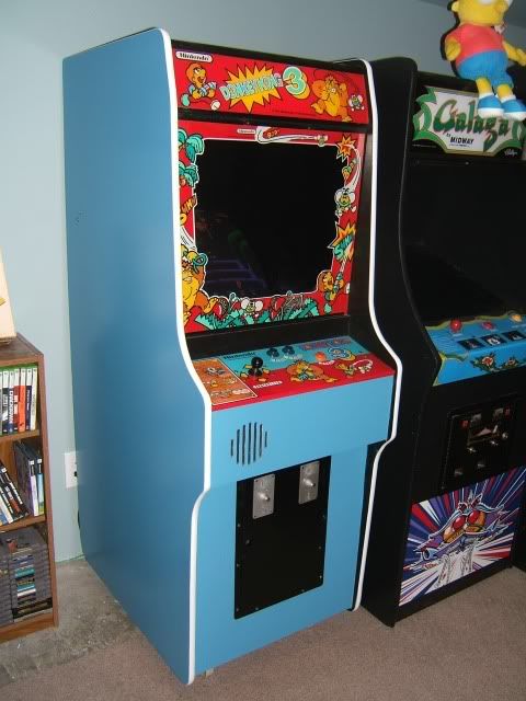

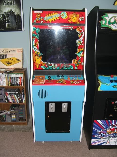

Over the past week, I got the hole and corner fixed (though through getting the pics for this post I realized I forgot to round off the corner...) and I hope that by this afternoon the cab will have at least the first coat of primer on it.
Now for something I don''t need now but will soon, I need to know how THICK the original Donkey Kong control panel is WITHOUT the overlay on it (i.e. just the wood.) as I will need to build one.
ALSO in gutting the cabinet to move everything heavy into the game room, i realized the monitor has some faint DK burn. It seems that this machine is completely original DK from the factory. Excellent.
Oh. Heres some before and after of the bondo procedure.
BEFORE:
AFTER:
BEFORE:
AFTER:
Most excellent.

According to the subject line, you're not keeping this a DK3?? Why not?
NO MORE!!
Mauzy
  • Posts: 1191
Re: Mauzy's DK3 to Donkey Kong A.K.A. I LOVE BONDO!
« Reply #21 on: May 25, 2009, 12:00:15 pm »
It's a Donkey Kong cabinet. TKG-UP according to the docs on the back door. I like DK3, so I'm keeping the guts in case I stumble upon another Nintendo cabinet or wire up a board switch, but I've always been a fan of the original DK.
I haven't started buying DK parts yet though, so
it may end up staying a DK3 for a while. I'm not buying any art until I have a functional board.

My plywood DK control panel is 19/32" without the overlay.
Bondo came out great!  Did you add any "structure" to the missing material...or did it work well without?
« Last Edit: May 25, 2009, 06:32:51 pm by RetroACTIVE »
Happy Gaming!
Mauzy
  • Posts: 1191
« Reply #23 on: May 25, 2009, 06:38:13 pm »
Thanks. On the coin door hole I did, but after the results I've seen from this I don't believe it was necessary:
For the corner, I put together a box out of plexi-glass:
RetroACTIVE
  • Posts: 1429
  • Last login:January 28, 2024, 04:27:52 pm
  • Gramps
« Reply #24 on: May 25, 2009, 06:53:07 pm »
Looks good, those dowels certainly don't hurt ;)
Happy Gaming!
Mauzy
  • Posts: 1191
« Reply #25 on: May 25, 2009, 06:55:35 pm »
Very true. More than anything, they gave a little peace of mind. That was my very first time using bondo, the corner was second.

Went and had paint matched from a small chip I took out of the hole in the front. Came out PERFECT! For any restorers in the midwest, I got my paint at Menards. I used Pittsburgh Paints Interior Latex Semi Gloss Enamel. The code will be shown below in a picture.
BTW, a gallon is WAY too much paint... I could've gotten by with a little over a quart, but it was the same for the money and I may end up picking up another DK...
Two coats primer, two coats blue. light hand sand in between with Super fine foam rollers. Moved it back to the basement so I could park in the garage. This will be it's final spot here.

I made an executive decision yesterday: this machine will stay Donkey Kong 3. Theres enough DKs in the world, this one can stay how it is.

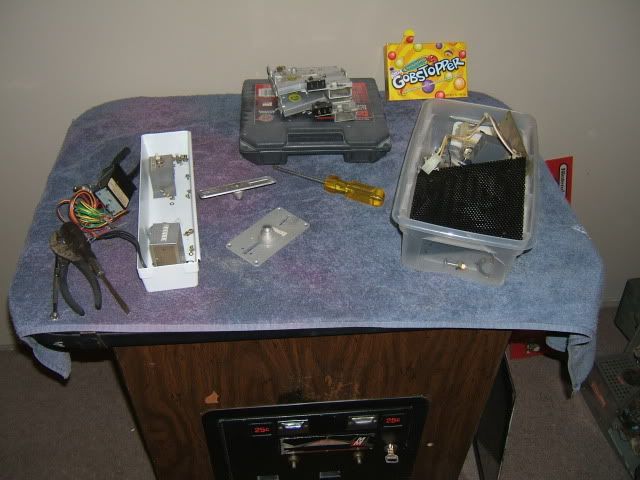

Anyway, I finally finished the coin door. In doing so, I found that the mechs have conscutive serial numbers. I love finding little stuff like that.
Still need to put a lock on the coin door.
