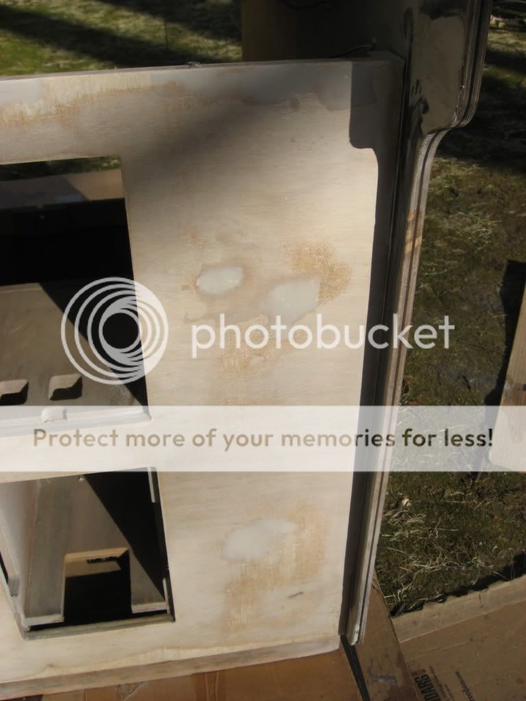

I had my brothers come over to help me lift the cabinet out of the basement. I laid the cabinet onto some cardboard boxes to keep it off of the grass.
As you can see the cabinet is in some rough shape, but I am ready for the challenge  :D
I used a 5 inch sander with some 60 grit sandpaper to remove the old paint.
After two and a half hours of taking my time ........ waalaaa!!! one side finished. I will do the other side tommorrow weather permitting  :D
My brother stopped over to help me lift the cabinet back into the basement. One side finished  :) I used a tack cloth to remove any excess dust and debris from the freshly sanded side  Tommorrow I would like to add the wood hardener to some of the corners to prepare for wood bondo.

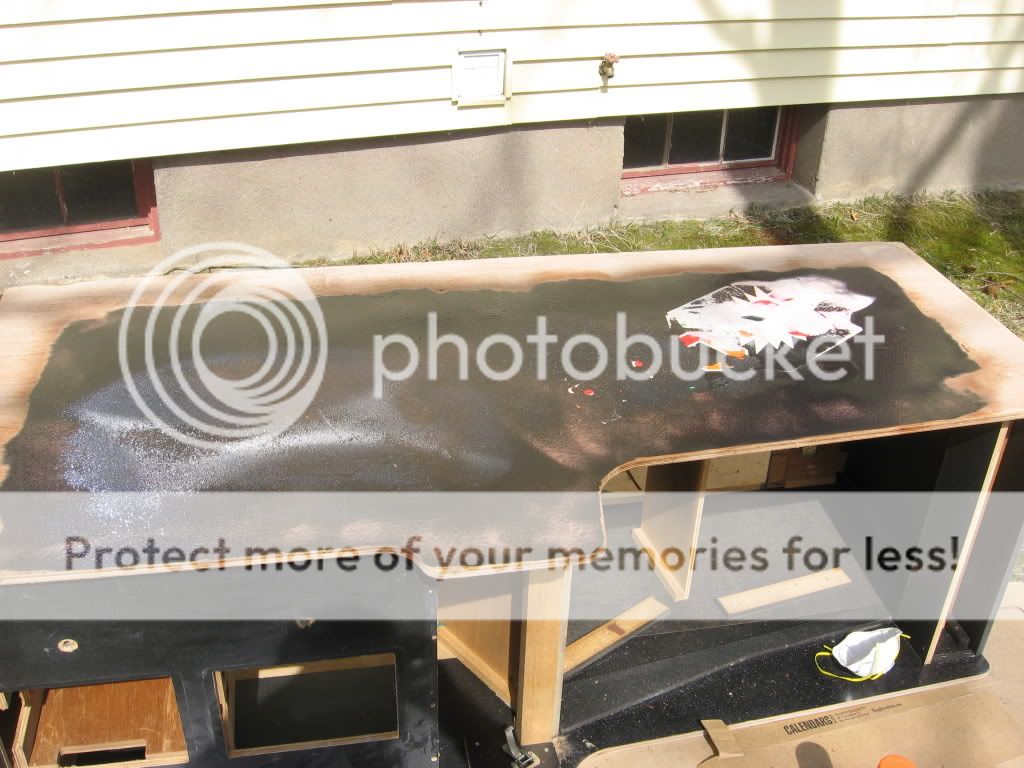

I did not have all day like yesterday, so I decided to work on the back panel
Looks crappy, but with a little sandpaper it will look a lot better.
First coat of Rustoleum textured black spray paint.
Another shot of textured paint.
After sanding painted side, I doused the edges in Minwax wood hardener.
I am fixing control panel wood edges with the minwax liquid wood.
After this dries, I will shape edges to perfect squares. I am determined to fix every crappy wooden edge to be perfect. I will not cut any corners (no pun intended) to make this machine look like brand new when I am finished. Stay tuned for more  :)

Another day of sanding.... yay
Right now I am thinking I should have used paint stripper : )
I put some citristip on to help with a few of the layers of paint.
After a couple hours....side two finished
Now I just have the front left to sand, then I will add wood hardener and bondo to all crappy edges : )
