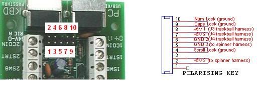

I'm still a bit unclear on this -- I'm looking at the diagrams on Andy's site, and I'm confused. He told me that the minipac has the same header that the IPAC does, but the wiring diagrams have confused me.
Here's the wiring diagram:
Here's the IPAC, with a clear view of the header plug pins, near the ps2 connectors:
Can anyone help me identify which orientation the wiring layout refers to? Should I view the IPAC header with the ps2 connectors on top, or on bottom?

Each of these were connected to 5v coming from the header on the minipac. I got my power from pin 7 (see later pic for diagram). I split the power line into 2 lines, and then connected each of my 'resistor assemblies' to the line.
Now that each LED had power going to it, I needed to ground them. This is where I got stuck for a looooong time. After doing lots of reading and asking a few key questions, I finally got the info I needed: pins 4, 9, and 10 act as the grounds you need for your LED's. The mini-pac (or IPAC) 'flashes' those grounds when it captures LED actions from ledutil.exe, a partner program for mame. Now that I finally figured out which pins created the proper ground contacts for which LED, I set  to getting a cable to bring my numlock and capslock grounds to my 2 LEDs. Since I was already using the wiring harness on my mini-pac, I decided to cannibalize a USB cable from my boneyard:

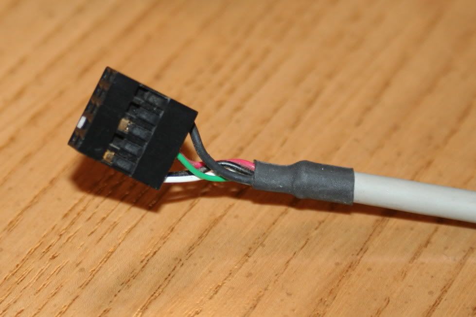

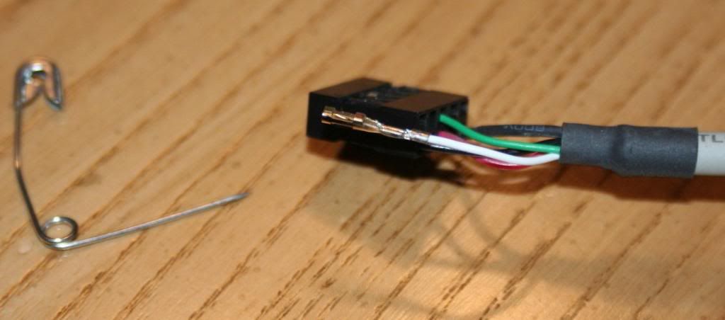

This internal USB cable uses the same pin connector as the mini-pac. I'm going to pull 2 wires out of the connector with my trusty safety pin:
Showing one of the pins removed...
And here's the final result: the Ultimarc mini-pac wiring harness header, with 2 additional wires plugged in. The bottom 2 wires, red & white, are the ones I added to the header block. The wiring harness only makes use of about 4 of the 9 available holes in the block, so adding additional wires to this block would be very easy with more old USB cables lying around, which I have tons of.
Andy's website (www.ultimarc.com) does a good job explaining the wiring setup for LED's, but his wiring diagram for the minipac left me very confused. I've added a few more words and explanations to help aid in understanding which pins do what on the header:
I used pin 8 as the power line for my trackball. Pin 7 was the line I used to power my LED's. Pin 2 carries the other 5v line, and I left that one alone, because it went to the spinner connector. That way if I ever want to install a spinner, I can use the connector.
