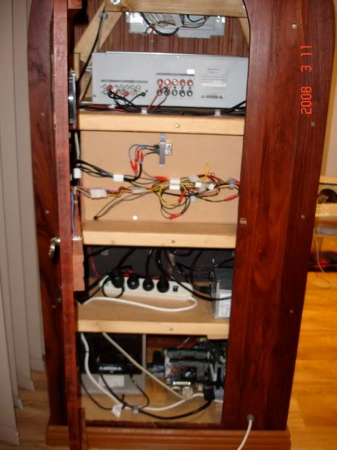

View from behind with the JB comlpeted. Two fans from the old server fitted to the door, latch and deadbolt as well. Also a recessed switch to turn everything on in the top RH corner (yet to have button cover fitted).
Back door open.
Close up of the guts of it.
- Lower shelf = subwoofer to the left with PC board on the right.
- next shelf up = Speaker boxes with power board
- next shelf up = record player alcove + relay to turn on everything.
- top shelf = amplifier + touchscreen.

we have this stuff over here (Australia) called MDF (Medium Density Fibreboard), I used 3mm thickness in the longest length I could find (you can see about 1/4 the way up I have used some strips of wood to hide the joins). I hung it over a wooden beam in my garage for 2 weeks to get it to bend to the right shape under its own weight.
Did you use hardboard for the arched top like Welshmark? What are your buttons?  How'd you get the wood tone on them?
You might check out woodworking supply stores for finials or decorations for the top.  You might also consider making a bezel around your controls and control display.  That might work out well.
I cut out a channel using a 4mm router bit for the 3mm thick MDF to slot into, such a nice fit (and strong) that I didnt need to use any re-inforcing. The buttons I used - if your referrring to the interface I used a touch-screen, however if your referring to the buttons that interface with the amplifier buttons then:
1. I used old style wooden knobs grinded down to the right size.
2. The stalk of the knob was glued into a plastic pipe (hobby shop kinda stuff).
3. Then a larger plastiic pipe (again from hobby shop) was split along its length, heated up and fitted to a screwdriver to 'open' it up a little.
4. The larger plastic pipe was fitted and glued to the drill holes that line up with the push buttons of the amplifier
5. The smaller pipe (fitted to the stalk of the knob) was greased up and inserted into  the larger pipe (so it slightley pokes out the back of it)
6. To each of the smaller plastic pipe ends poking out of the back of the larger pipe, a small circular plastic (cut out from a tuppaware lid, shhh dont tell my GF lol) is glued. This stops the knob from sliding out, but provides enough surface to make contact with the amplifier buttons (which happen to be spring loaded).
In regards to the wood tone, I used two coats of some "Jarrah' colour rubbing compound (oil + bee's wax). I applied two coats after I had sanded the wood with 60 grit, then 120 grit, then 600 grit to give it a slight shine so that it looks like a "unit once shiny but now worn from use" kinda look.
