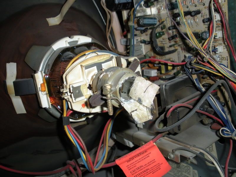

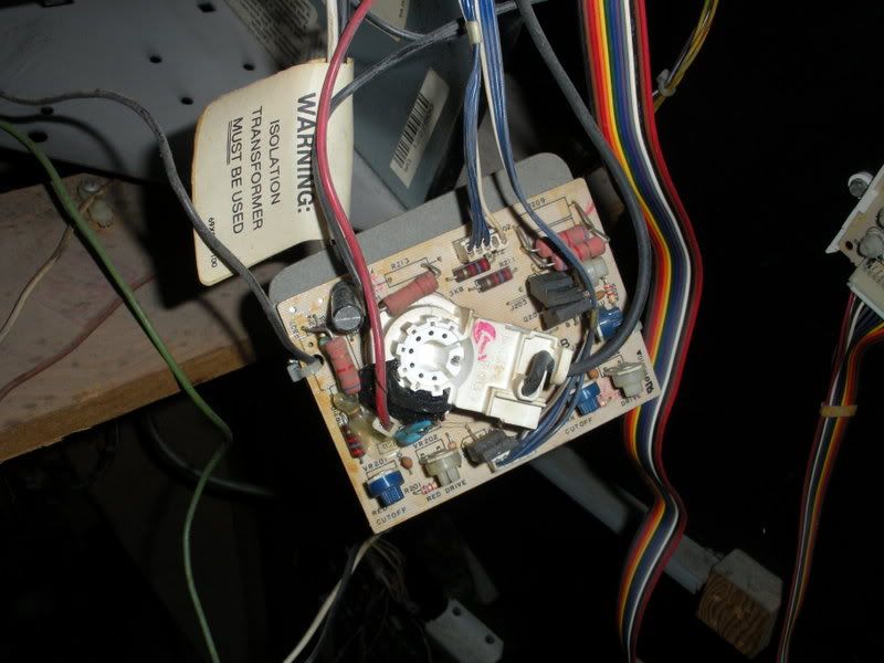

Hi.
I'm afraid this could be a big problem :(
When we first turned on the Cruis'n USA there was only a horizontal bright thin line in the middle of the screen. Games can be started, sound is ok and you see the colors and pictures changing within the thin line.
We've been told to replace TDA 1771 that controls the vertical deflection. We did and it worked for a few days. Then it was the same problem again....and again.
We now have replaced the TDA three times, the last time (sunday) we replaced the large resistor, too and reduced the voltage. It was always 33-34V and now it is around 29V. It worked 3-4 hours on sunday until we swtiched it off.
Yesterday evening we powered it up and the TDA blew again....again the thin bright line  :hissy:
Has anybody ever had the same problem nad knows how to save it? We're running out of TDAs.....only one left and this time it should run stable :)
Would be great if anyone could help us.
The pictures show the good days when the machine was running......  :cry:
