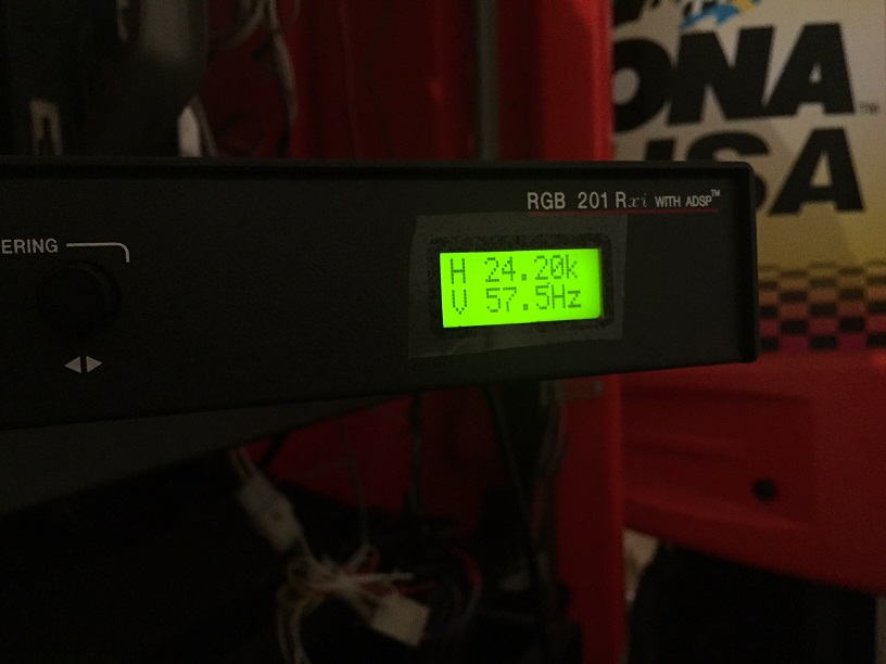

40" plasmas... 640x480 native xD
« Last Edit: June 05, 2015, 07:41:41 pm by SailorSat »

Interesting note: the m2emulator is running too fast! If I run daytona on real hardware and the emulation side by side, the emulator is slightly faster. I suspect that is a 58Hz (original) vs. 60Hz (emulation) thing. Even the music plays slightly faster.
I have made a video to show the problem:
« Last Edit: December 07, 2015, 04:04:20 pm by BigPanik »
Could you use something like Calamity's CRT_EMUDRIVER to set the vertical refresh rate to 58Hz to fix the speed issue?
You'll get sound problems then :(

I did a bit of investigating on the vertical refresh rate of model 2 games myself.  I plugged in my Extron RGB interface to the video signal of one of my Daytona cabinets and got the following result :
I then tried loading the Daytona rom in Groovymame and that detected the vertical refresh rate at 57.524160Hz (Sega Rally Championship displayed the exact same result too).  If the Model 2 Emulator is displaying model 2 games at 60Hz, that is over 4% faster than the original arcade hardware, quite a significant difference in my opinion.
If setting the default resolution and vertical refresh rate of the computer with CRT_EMUDRIVER to 496x384 @ 57.524160Hz causes the game to operate at the correct speed but the sound to be messed up, what are the options to fix this?  Would it require the Model 2 Emulator developer to add support for the correct vertical refresh rate so that the game runs at it's original speed?
« Last Edit: December 08, 2015, 08:15:52 am by xga »
Hm... A "hack" to change the playback speed of the audio from 48000hz to 46000hz (48000 / 60 * 57,5) may fix the sounds buffer underrun. However, thats just a hack, not a correct fix :)
As long as the m2em source code is not available (to the public), we most likely will not see a fix for that issue anytime soon.
There are other issues too - at least two in the network code - that need to be fixed :(
