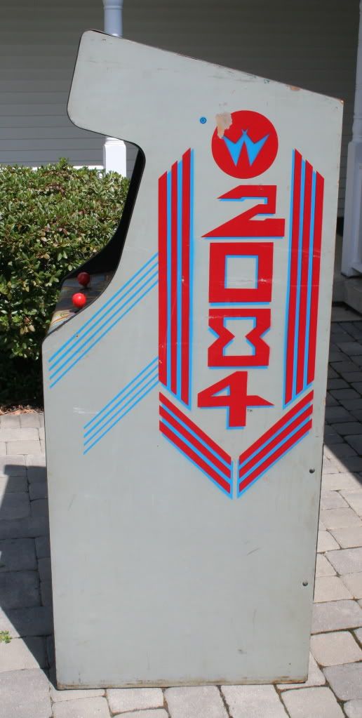

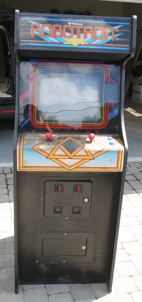

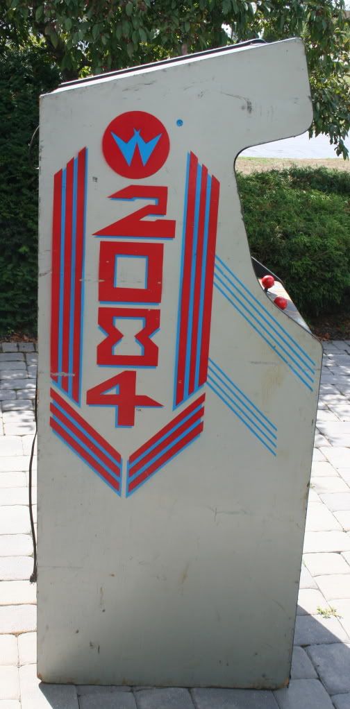

Just got back with the next restore candidate.  Unfortunately, this one won't be staying as it is a commission job.
The good news is that the cabinet is solid and after some bondo will clean up nicely.  The bad news is the game does not work (but at least is complete)

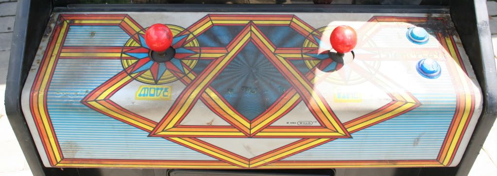

The ugly Willis control panel has got to go

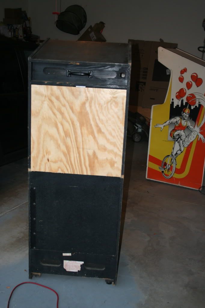

No top back door on the cab so I'll have to make one.  Luckily, I have a Multi-Williams in a Robotron cab so I have one to match

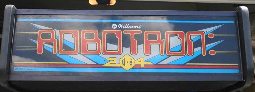

Marquee may clean up, if not replicas are available.
Bezel has some flaking and no instruction sticker

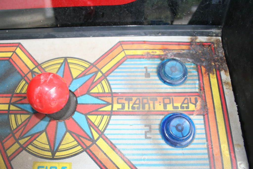

Cigarette burns everywhere, but the blue buttons may be salvageable.

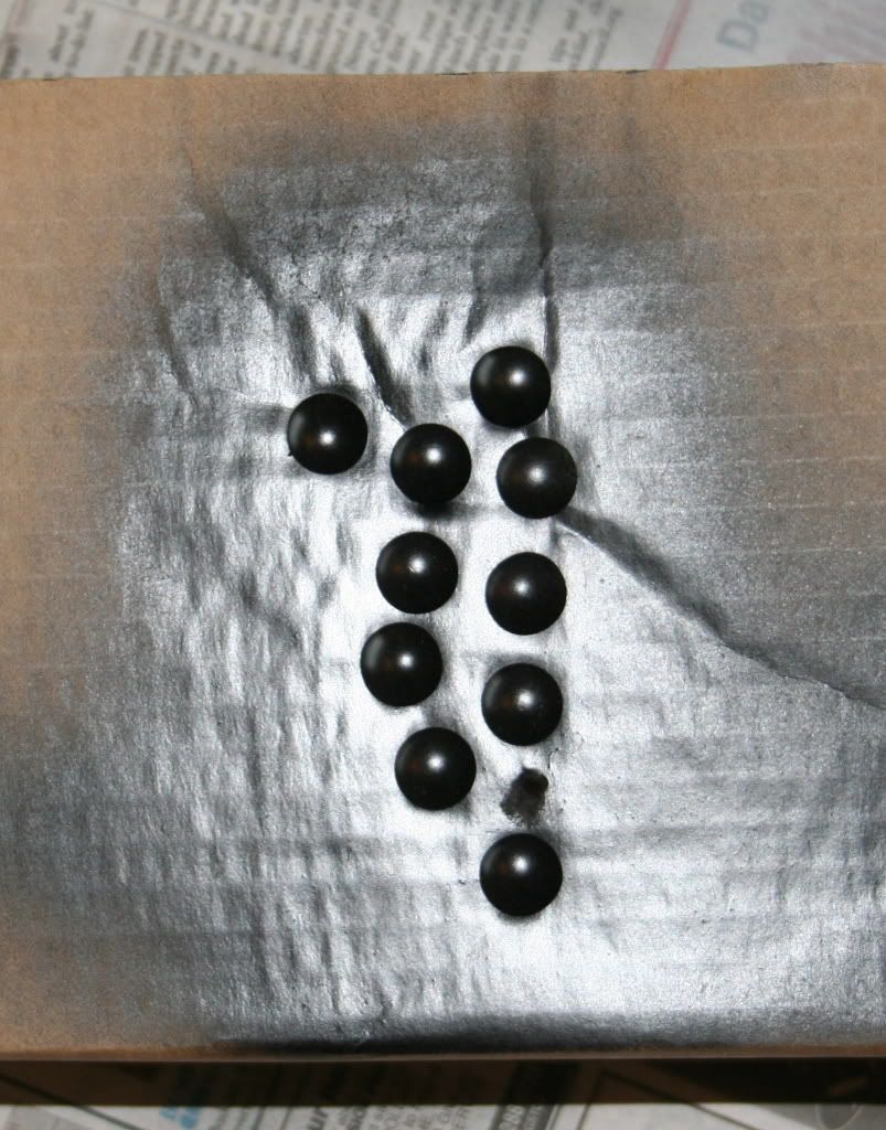

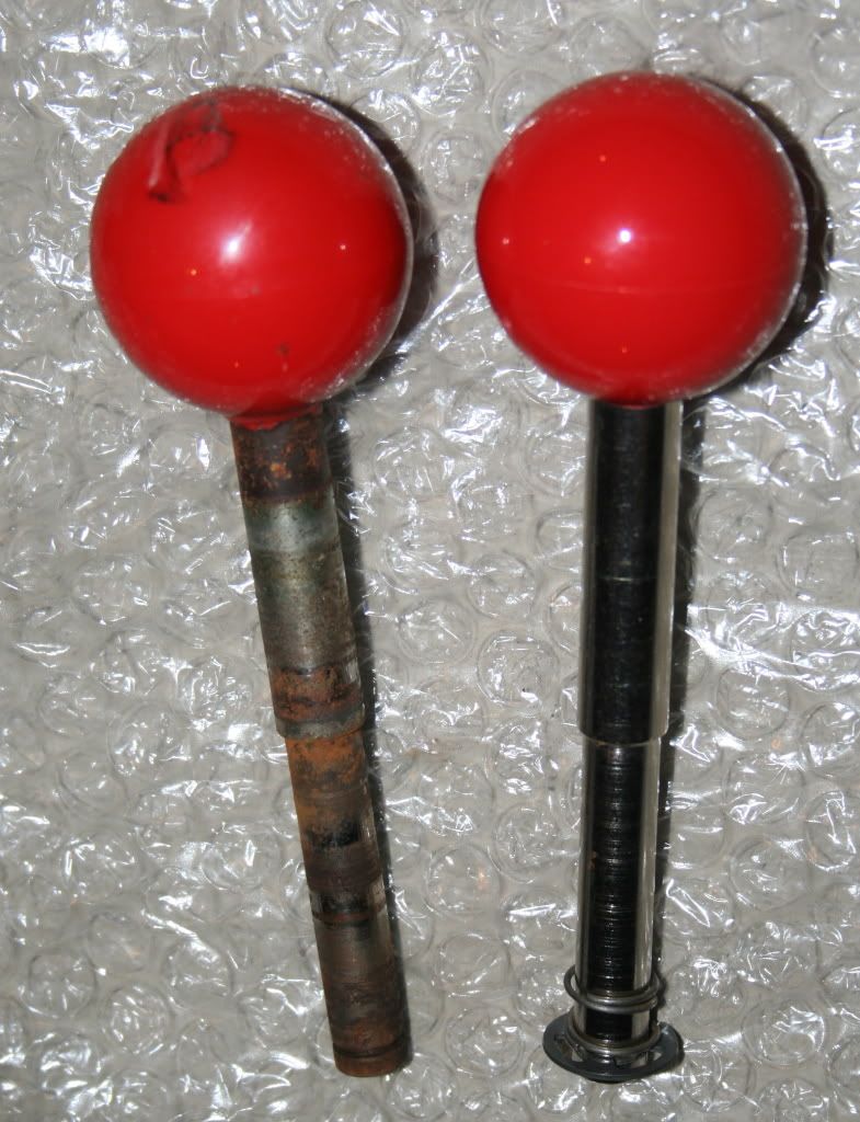

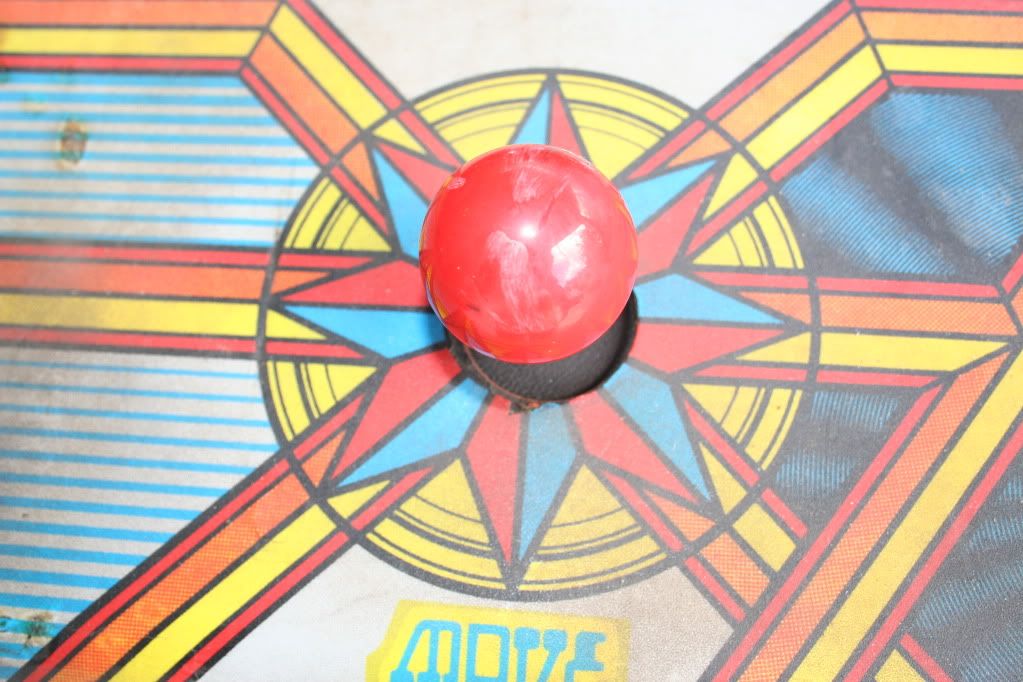

Both joystick balls are pretty banged up.  What's the best way to try and clean these up?

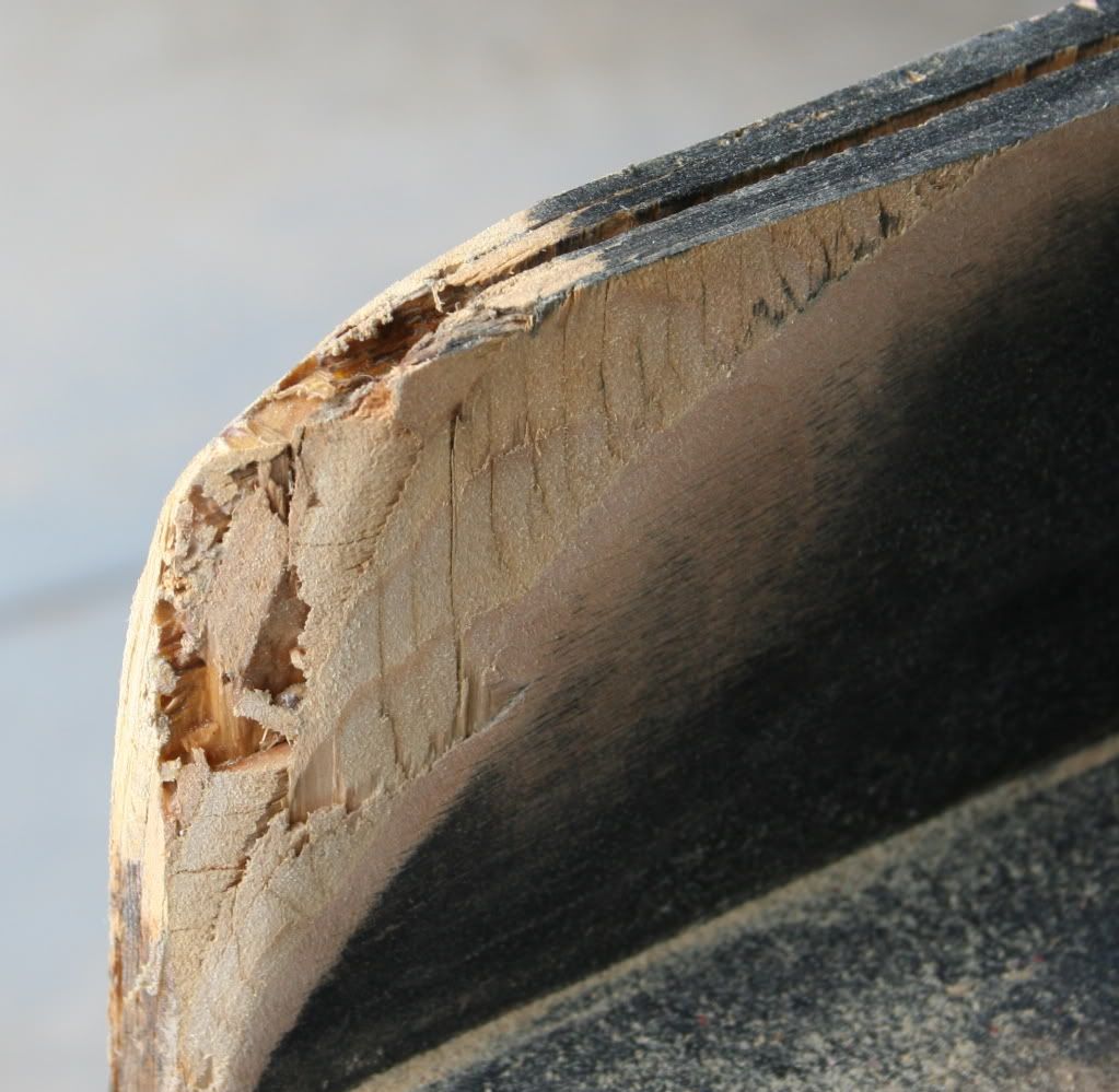

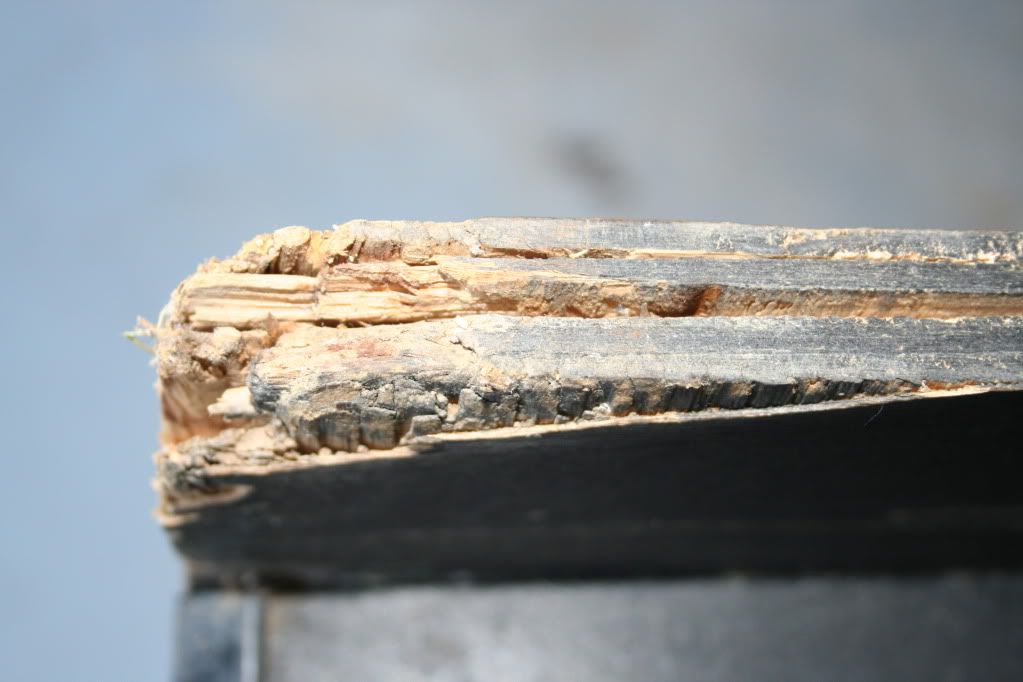

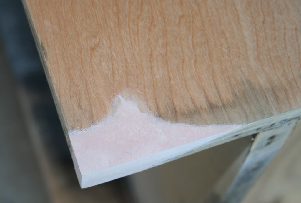

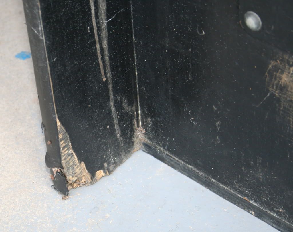

Worst part of the cab is the front corner.  A good healthy application of bondo will take care of it.

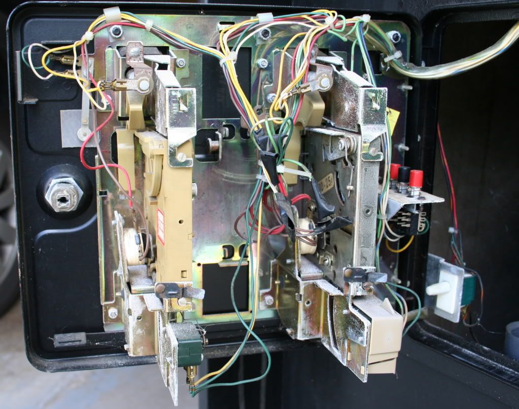

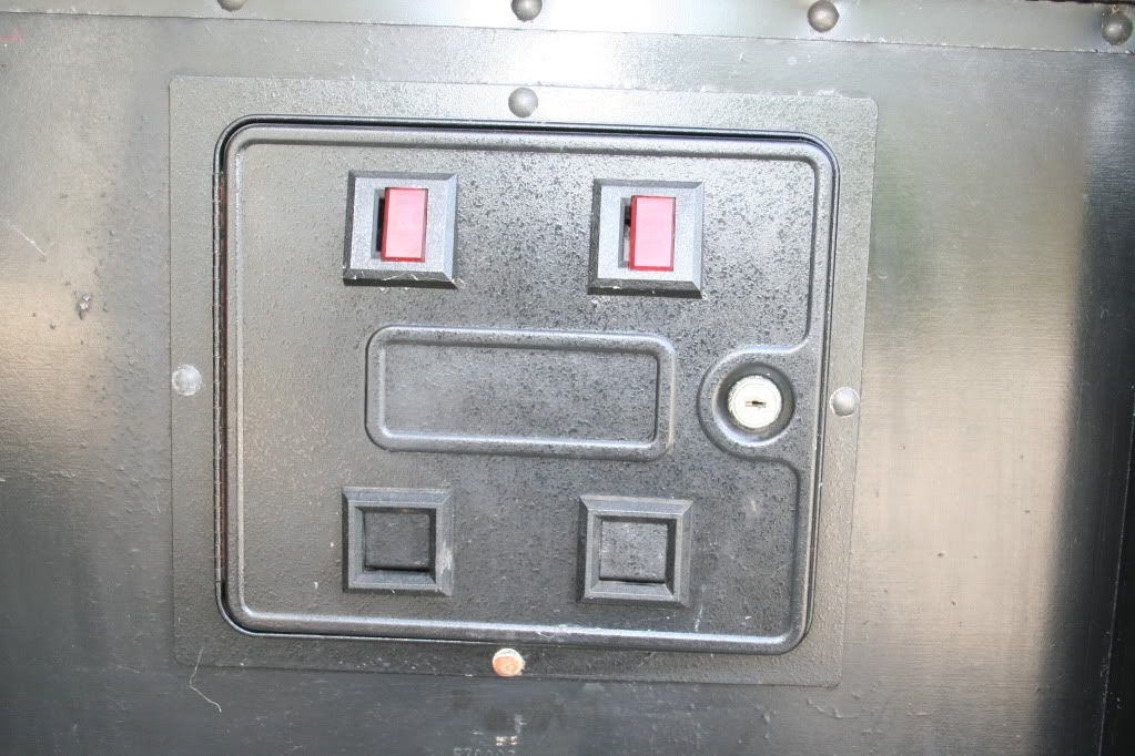

Coin door looks complete but no keys.
Not a problem on the top coin door, but the lower coin box may have to be drilled out.  unless I can get to it when I remove the carriage bolts holding it in place.

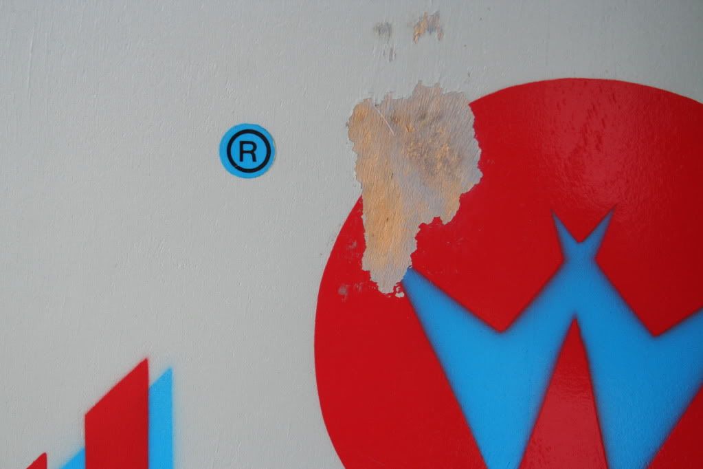

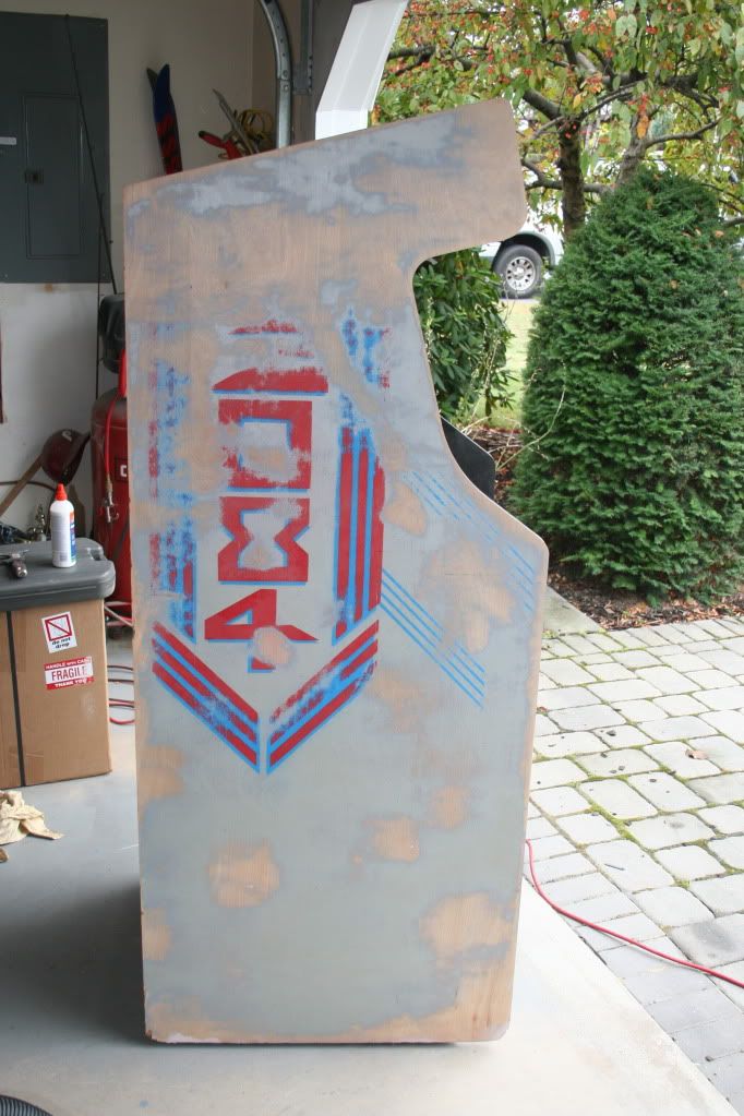

Outside will get stripped and repainted with stencils

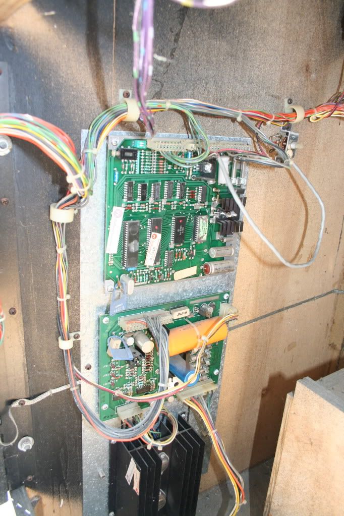

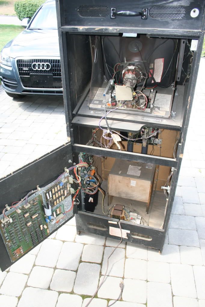

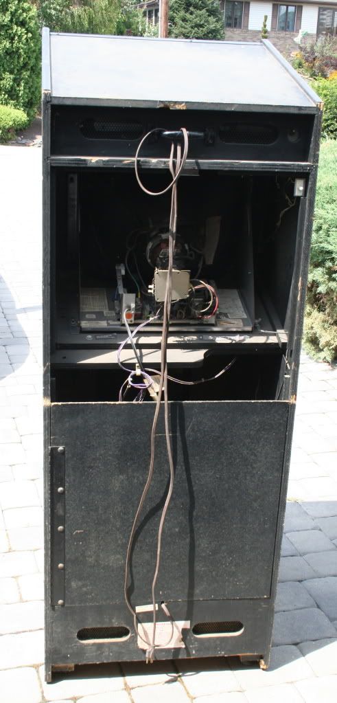

Let's take a look inside...

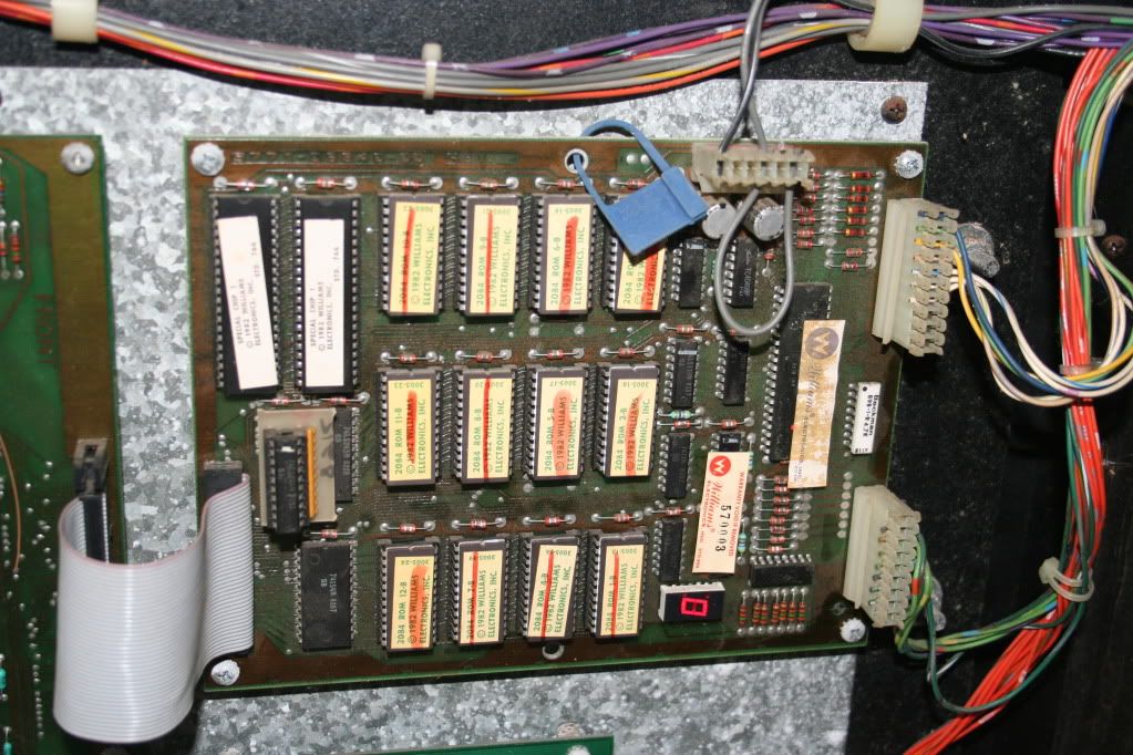

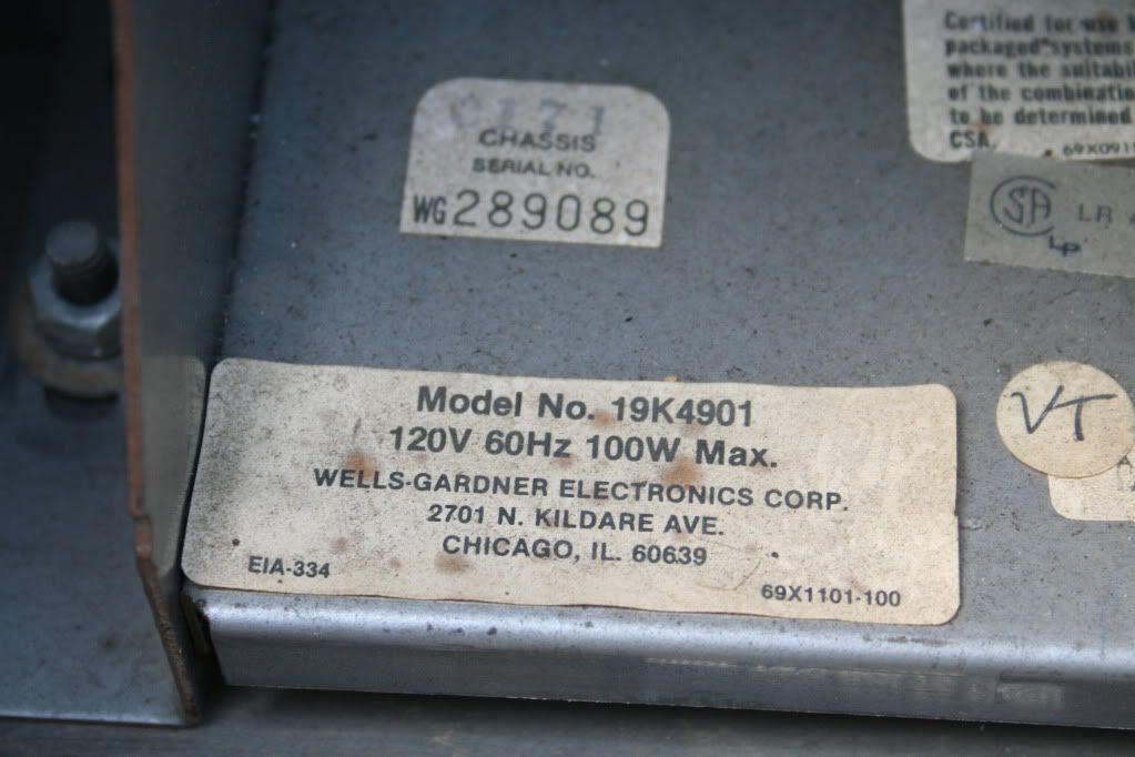

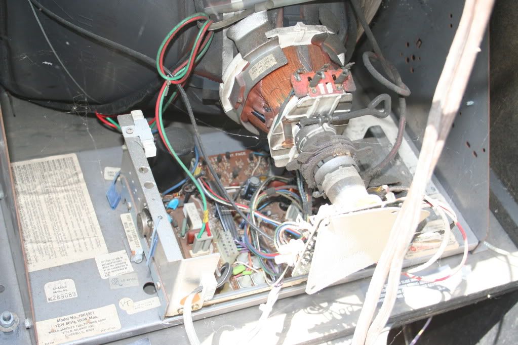

Monitor is a WGK4900.  Looks like an error code message is burned into it.  How bad the burn-in is I really can't tell until I get it out.
When I power it up, the monitor turns on but is just a solid whiteish/blue color.  I get an initial Robotron sound patter and that's it.  The number on the ROM board lights up with a 0 (which I think means it passes all the self tests?)
and all three led's are lit on the power supply.

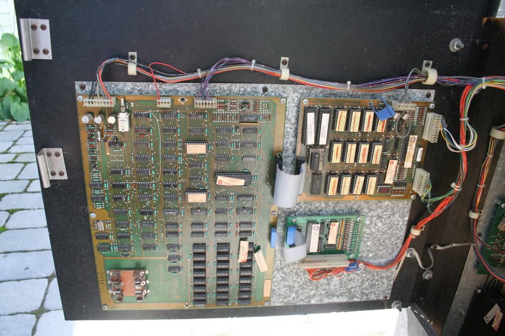

This is my first Williams game so I need to start figuring out what everything is on here.  Anyone recommend a place to start?

Okay, had some time this afternoon, so I started with the obvious first place to start looking...test the voltages.
-5V = -5.07
-12V = -14.39
+12V = 10.65
Looks like a power supply rebuild is a good first step.
Since my Moon Patrol was also in the garage, I pulled it over and plugged the Robotron into the Moon Patrol monitor.  Got the same thing as the Robotron screen, so at least at this point I can rule out the monitor as an issue (other than cap kit)
Since I'll be placing an order with Bob Roberts for the rebuild kit, anything else you would recommend ordering (besides a monitor cap kit) ?

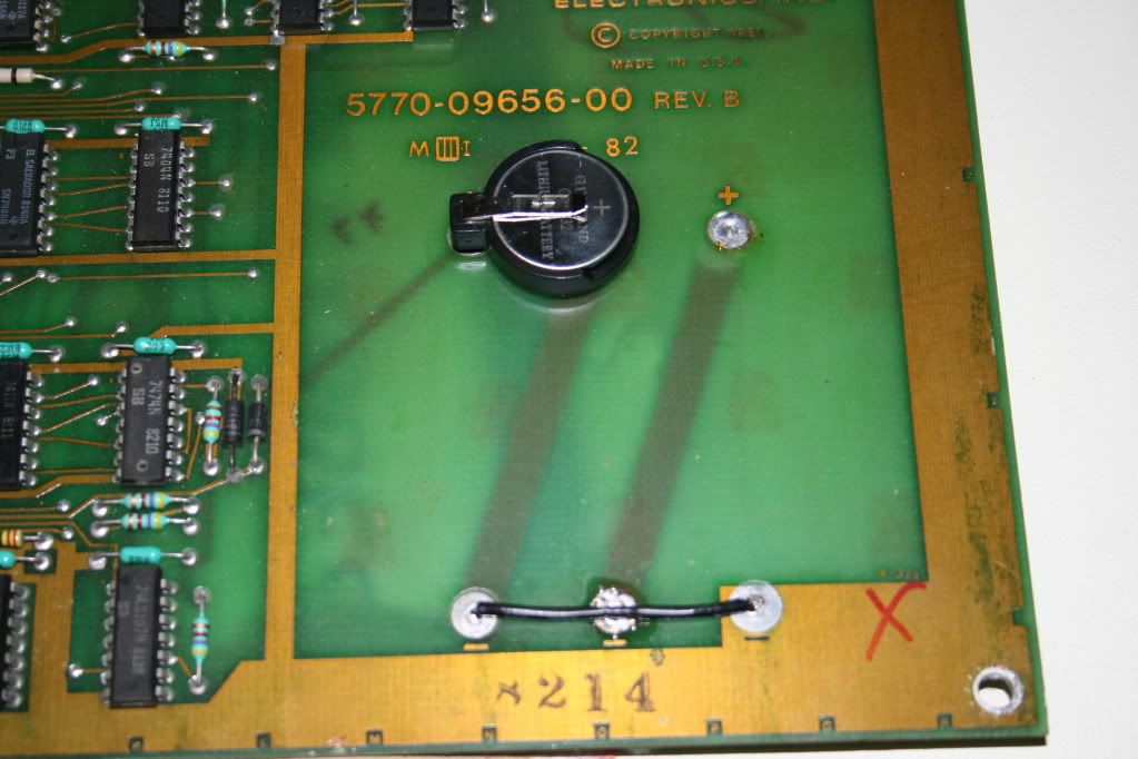

What do the batteries on the cpu board actually do?  I'm guessing some type of bookkeeping save?  High score save?  Anyway, I'll order a lithium battery replacement for them.
Definitely a good plan. Yes, the batteries are for the hi-score saves.
The lithium battery is what I'm going with. Really easy replacement, and well worth it.
That cabinet looks to be in pretty decent shape. Too bad it's not  staying with you, it's a classic!
Definitely rebuild the PS, williams games are notorious for their PS and connector problems.
As well, I would upgrade the RAM to the 4164's as well. It'll keep for longer, as they are more efficient than the current RAM chips.
If the monitor is fine, then it could be a problem with the RAM, or the connectors. Do a spot-check and see if any of the connectors are burnt, those could probably use a replacement. There could be a need to replace the headers as well (again, common problem with Williams games).

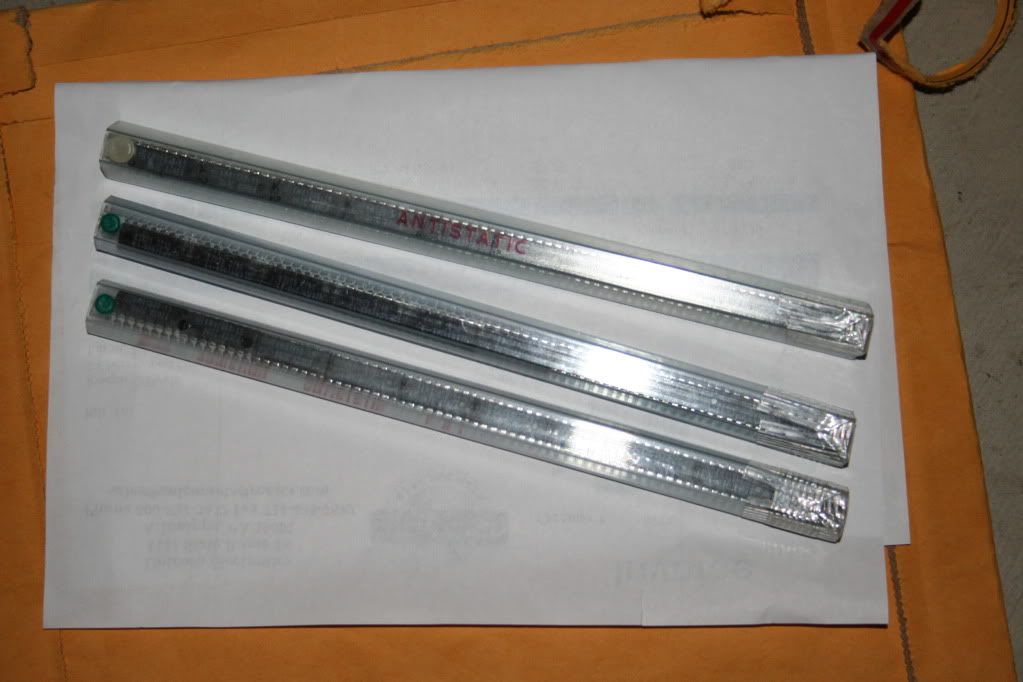

Ordered my 4164 chips today from here.  Good price even with the minimum order requirements.  Putting together a Bob Roberts order in the next day or so.

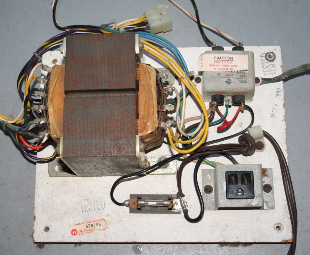

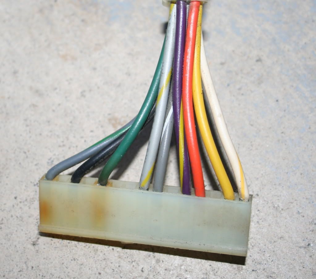

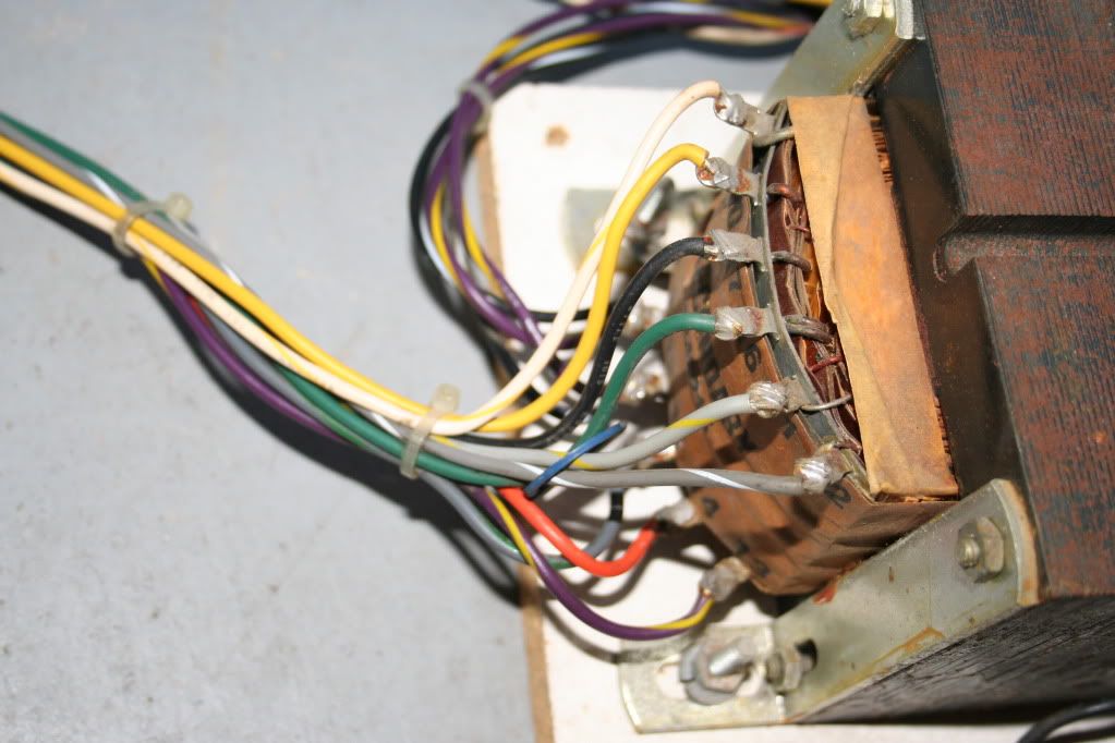

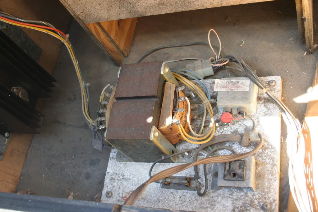

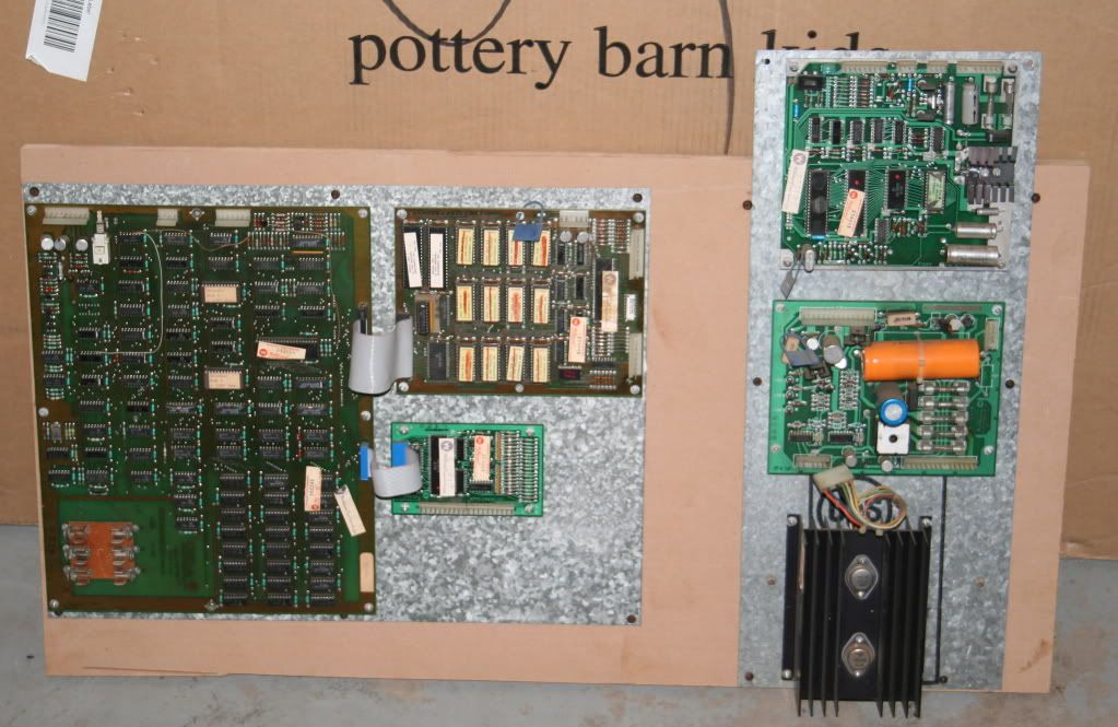

Pulled the boards out of the cab today and screwed them onto a piece of MDF to make it easy to work on outside the cab

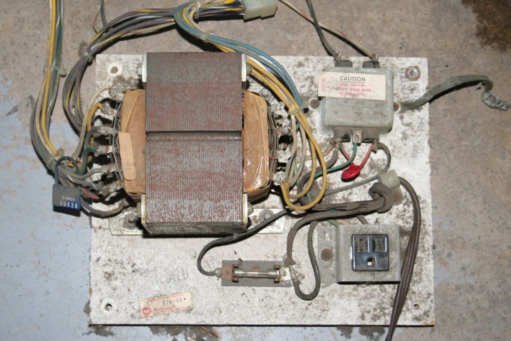

Also pulled the power block.  Looks like I'll be doing some cleanup in here:
Here is what it looked like right out of the cab:
and a little clean up latter:
It's nice to actually be able to see the color of the wires
I'll have to replace the molex on this one:

I don't know if you plan to repaint the transformer or not, but Rustoleum BBQ grill black paint works wonders...it's a high heat paint (over 600 degrees, IIRC), and a somewhat flat finish, so it looks close to the original finish.

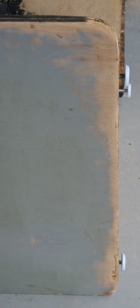

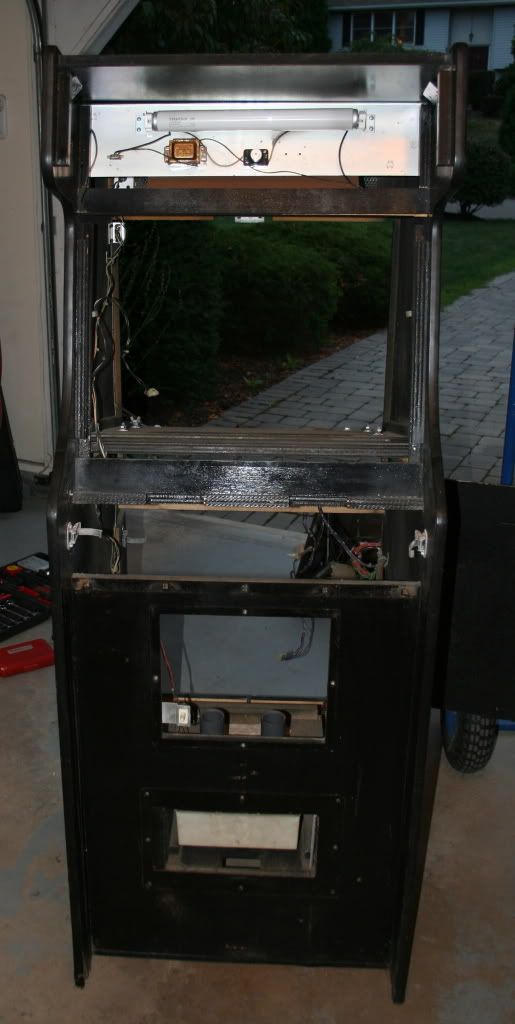

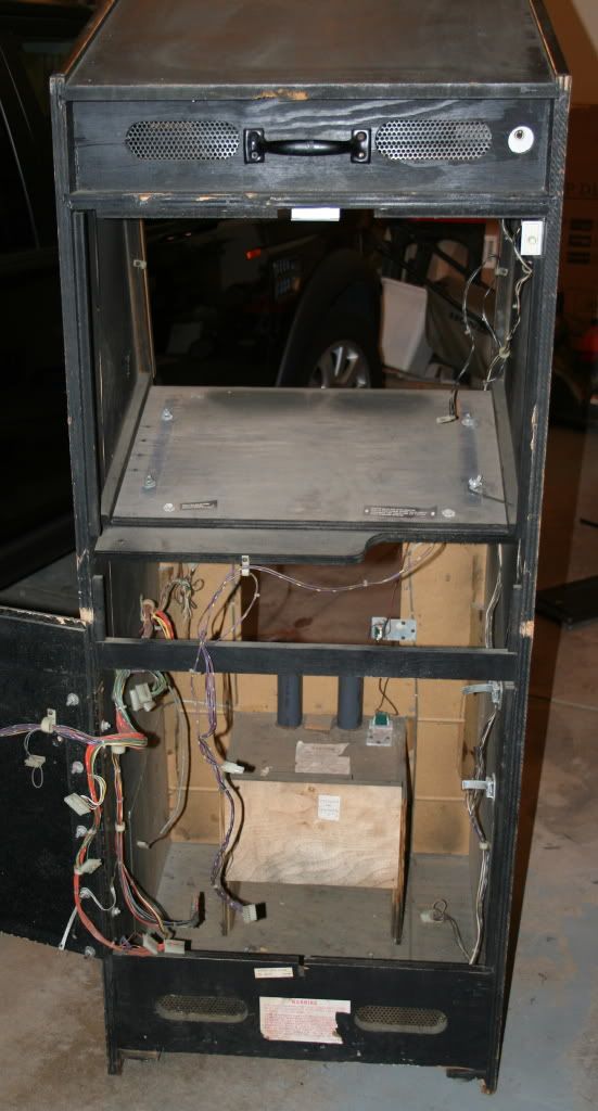

Continued to strip the cab tonight.

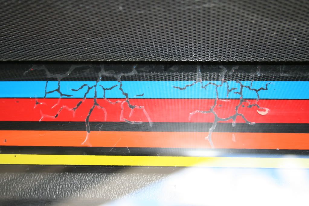

Monitor has a bit of burn in on it
Control panel may look ugly on top, but it is solid and will clean up well

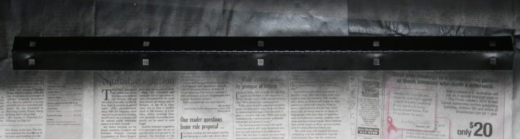

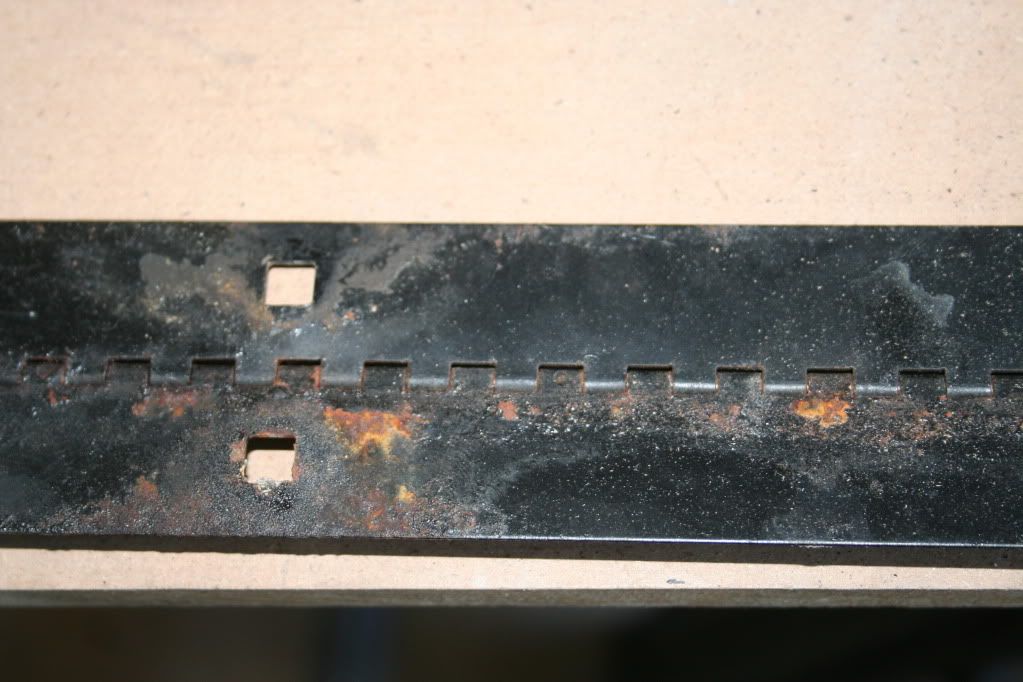

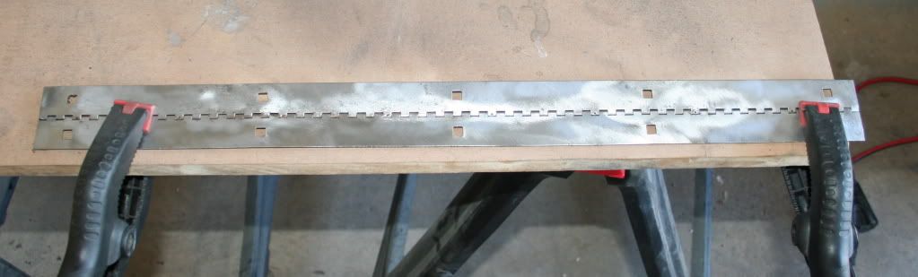

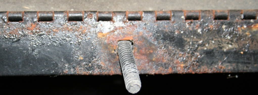

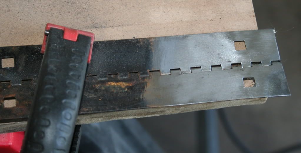

The hinge where the control panel hooks onto the cab is really rusted.  Will need to strip this down to the bare metal
I saw this on one of the other Robotron threads as well - looks like the couldn't get the serial numbering right and had to do it a few times

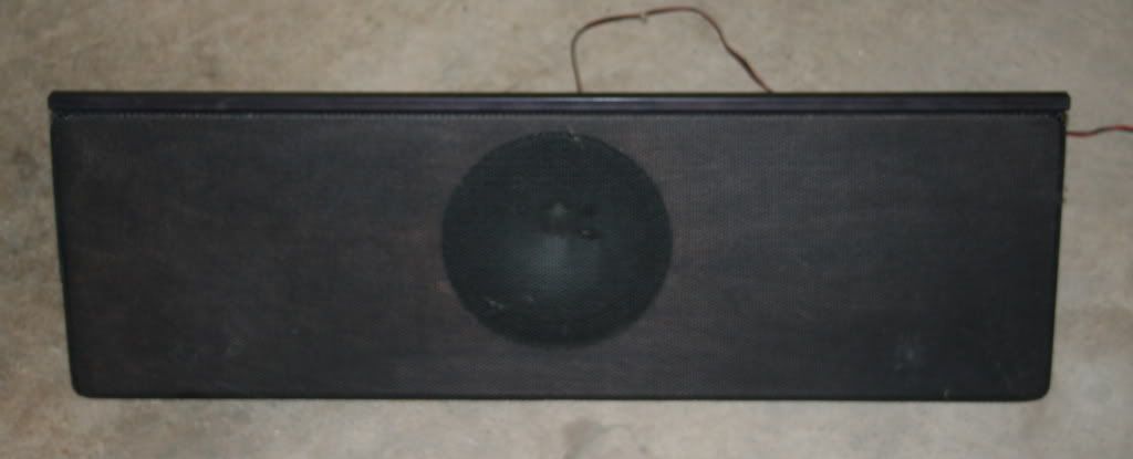

Luckily the speaker grill is in good shape.  Not an easy piece to find an exact replacement
That's it for tonight.  What I have is one mostly empty cab.

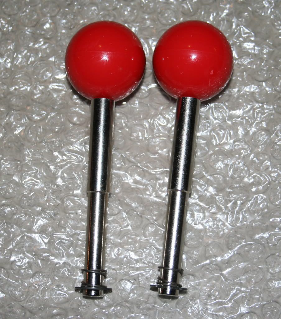

On a much better note, I got an awesome package in the mail today...
New Robotron joystick shafts!!!!    :applaud:
Here is a comparison between the old and the new.  Much nicer and saves me a lot of cleanup

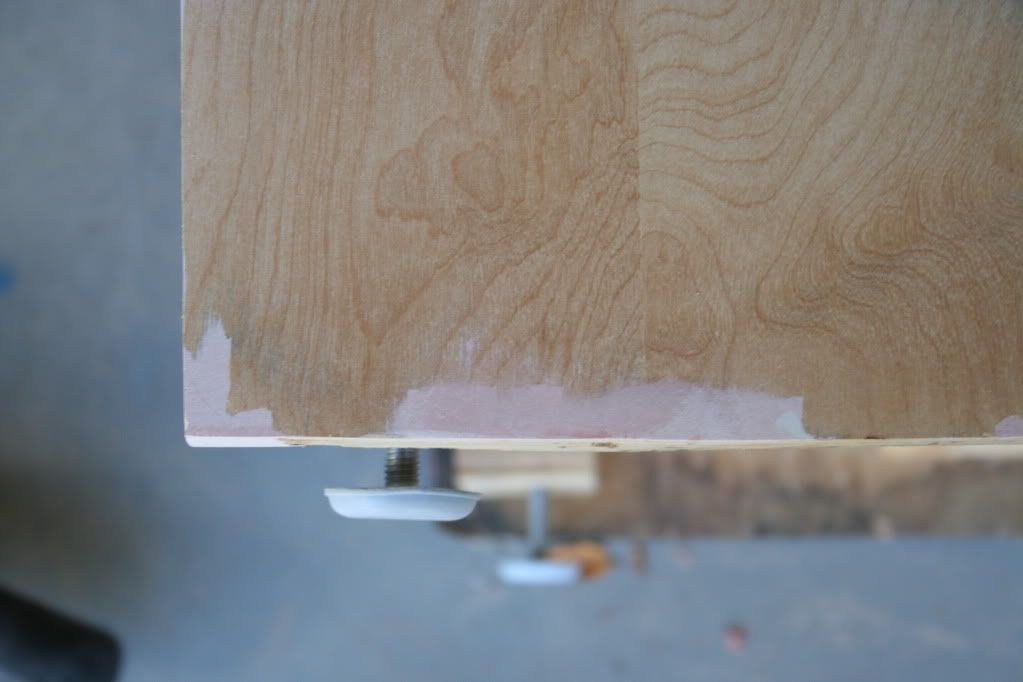

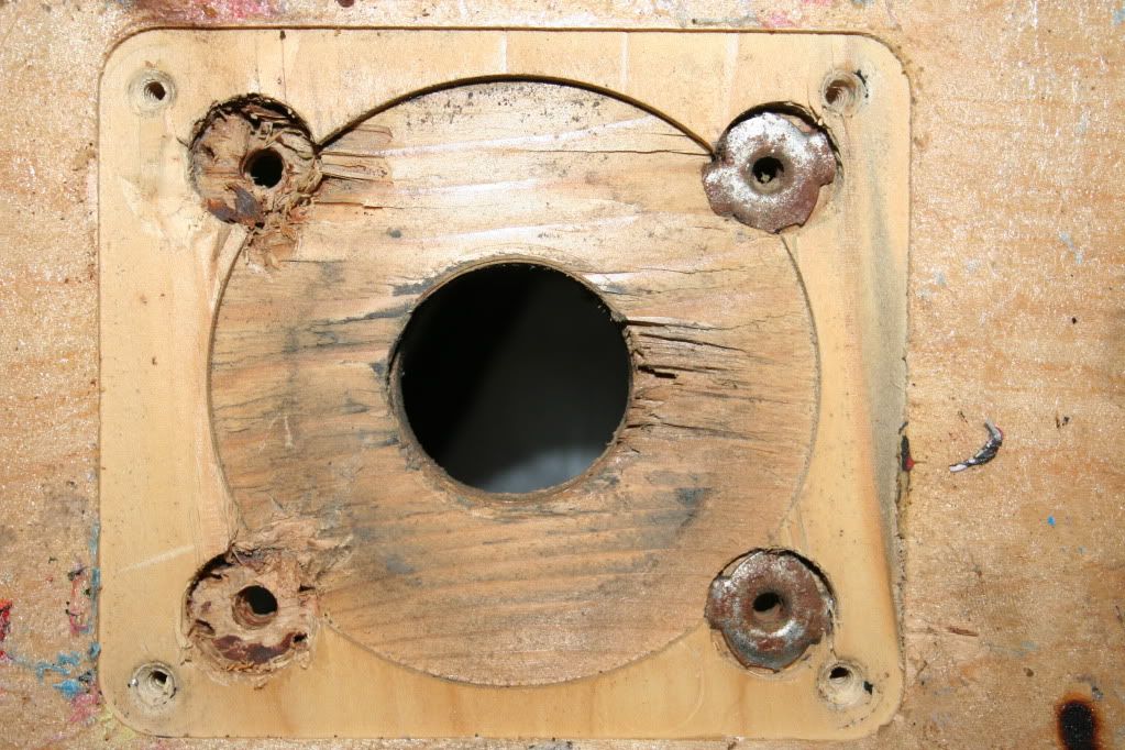

Picked up a new repro marquee today.  Here's a back-lit shot of it as it still has the protective paper on it

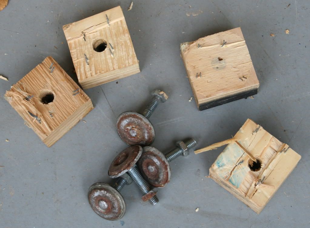

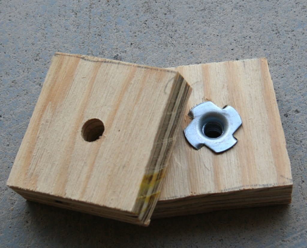

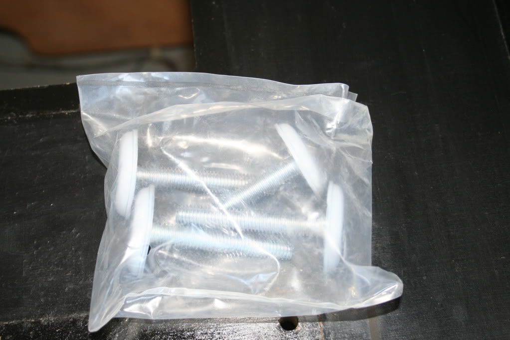

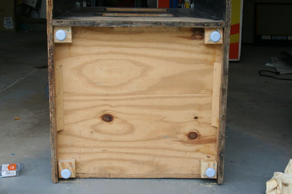

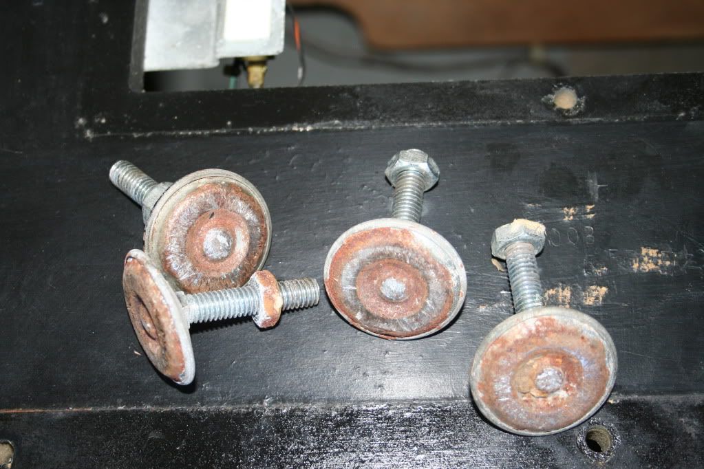

One of the first things I like to do to all my cabs is replace the original legs with nylon ones.  This makes moving the game around much easier as these things just glide on a concrete floor
Old legs removed
New ones ready to go

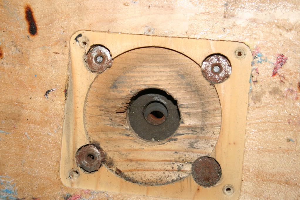

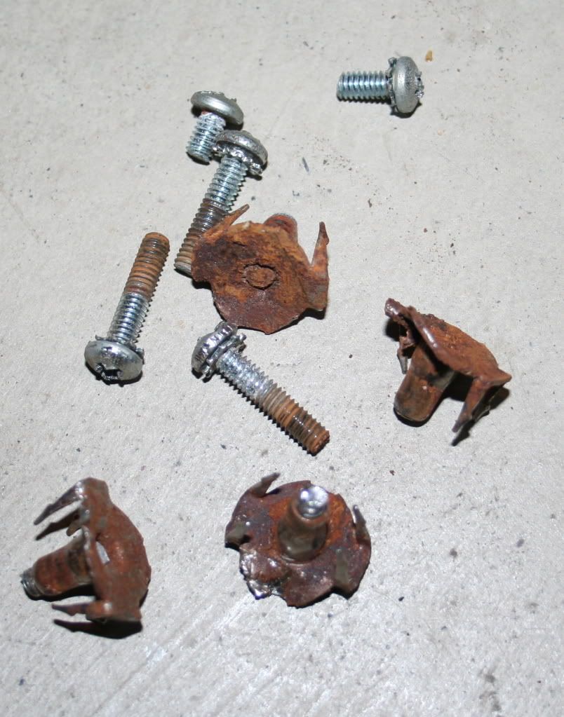

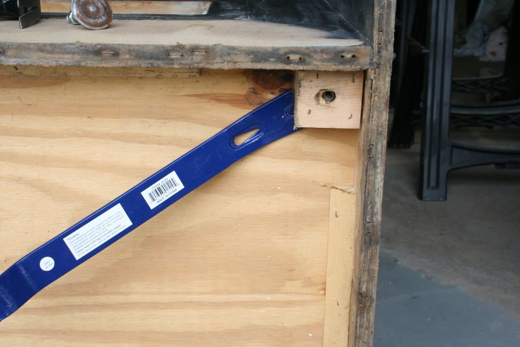

But I ran into a problem.  The old t-nuts were loose and at an angle so these legs just won't sit at the right angle.  I'll have to replace the wood base the legs screw into with new ones.

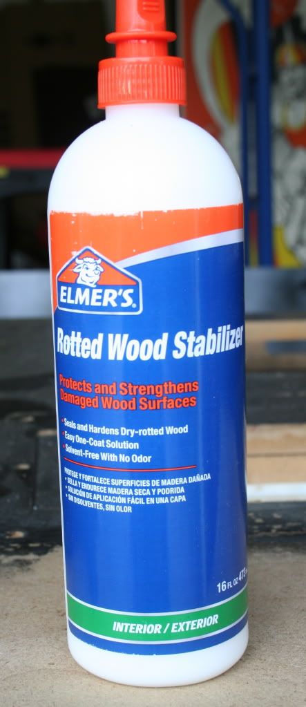

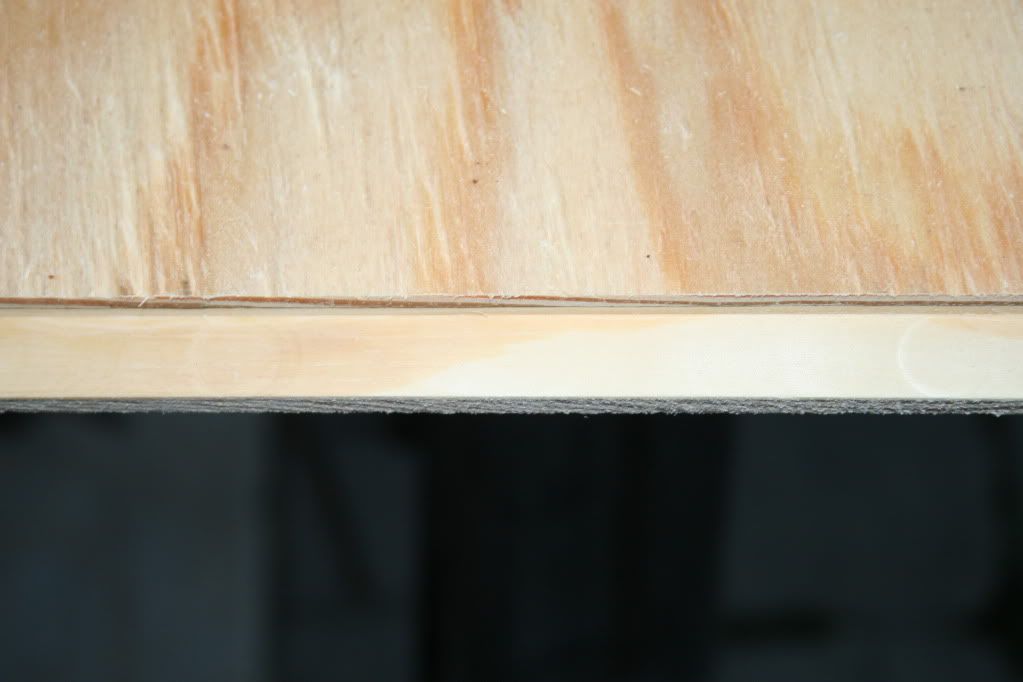

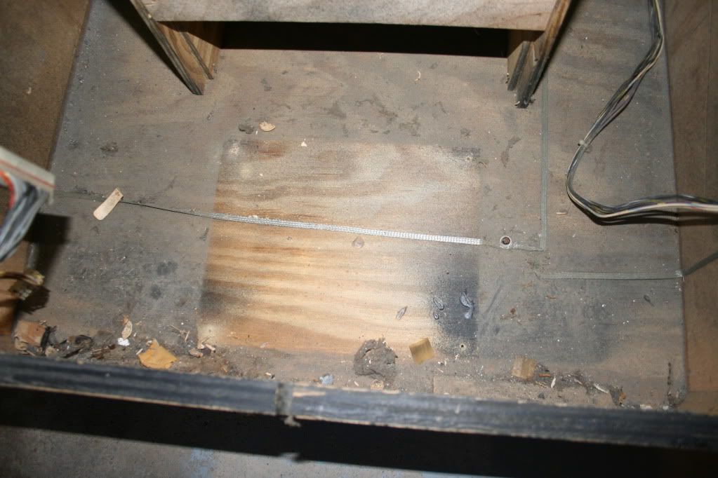

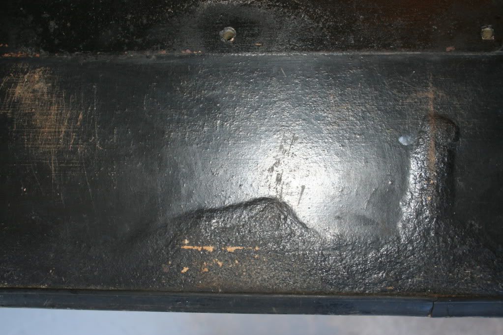

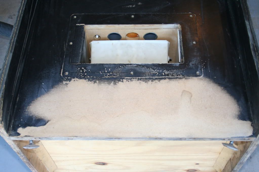

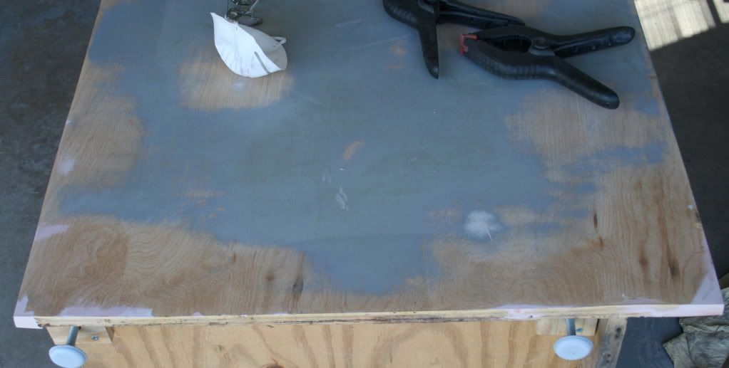

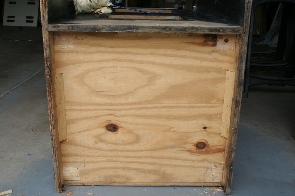

While I had the cab on it's back, I got a better look at the base of the cab.  It's a little worse than I though.  The corner will take some work to get back in shape
and I found some water damage at the very bottom
I broke out the sander and used it on the bottom area that had puffed out from some moisture.  Starting with 80 grit and working down to 220, I now have a nice smooth lower panel.
Once it's primed and painted, you'll never know there was a problem

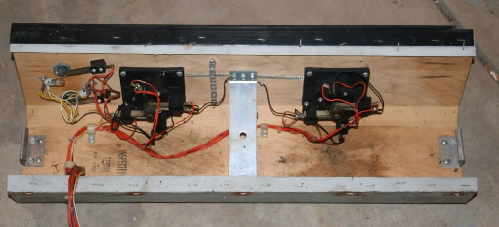

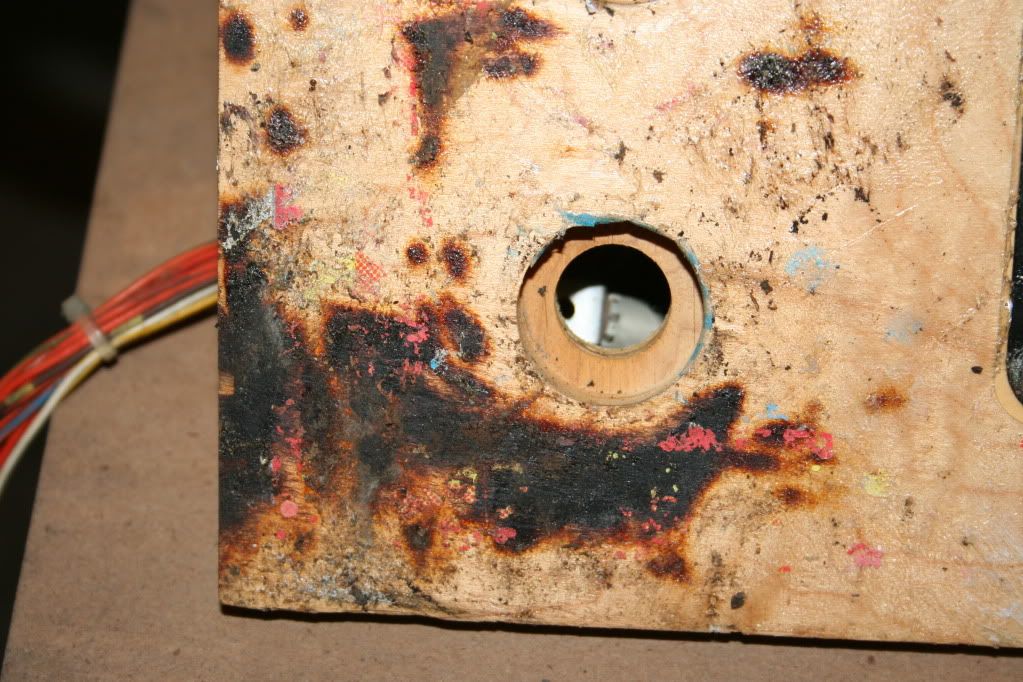

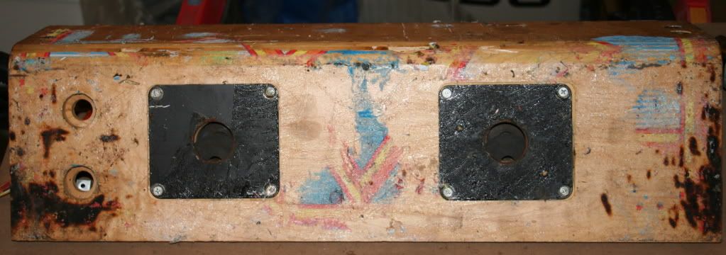

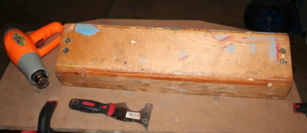

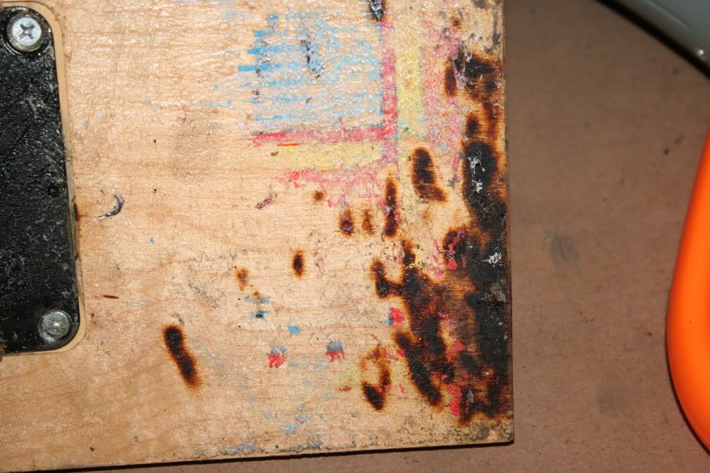

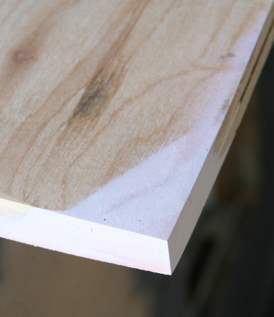

This is the second Roborton control panel I've done and I have come to the conclusion that Williams panels suck when it comes to new overlays.  Not easy to get the old off and tons of adhesive left.
The heat gun, a scraper, and some elbow grease were used to remove the old overlay
The bolts holding the joystick bases in place from the bottom are completely stripped on top so getting them out isn't easy.  I'll need to pry off the t-nuts from the top and replace with new ones.
Yuck...look at those cigarette burns
Next up is to remove the joysticks and then figure out what to use on the wood panel to remove some of the adhesive that is left over.

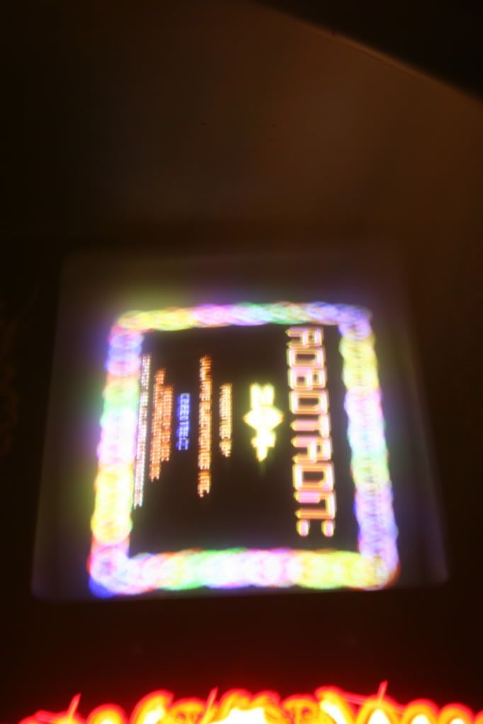

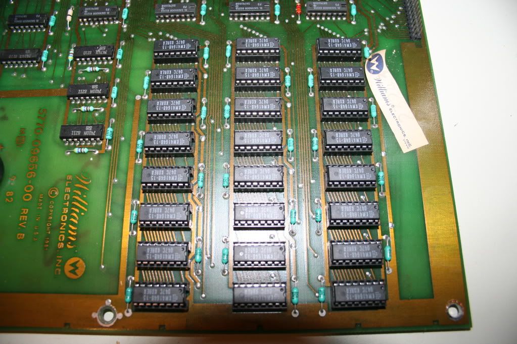

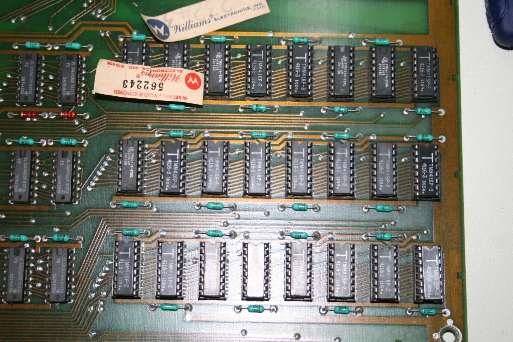

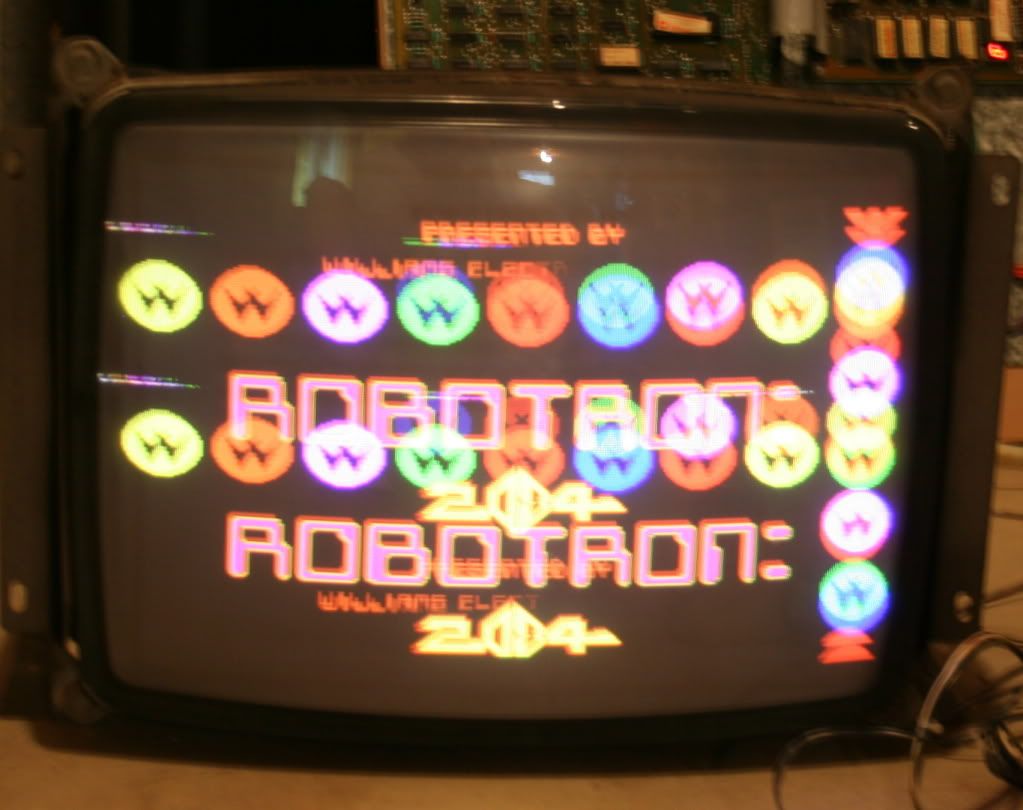

Progress today.  I recapped the sound board and the power supply.  All my voltages are in line and the game powers up  :applaud:
Only issue I have now is a double image on the screen

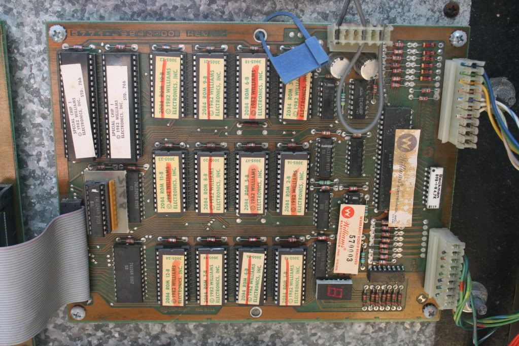

Not sure what is causing that, but up next is to replace all the RAM chips with 4164 chips and do the power mod to support them.  Not sure if that will fix the problem, but I'll tackle that before I try anything else.

Make sure before using the 4164 rams that you adjust the power wires going into the main board or you'll fry the ram chips and need the entire set.
Yep, already have that ready
If your getting a zero on the ROM board then the game is passing self-check and your video issues appear to be in the connectors or you wouldn't get a zero unless IIRC the only other possible problem could be the video decoder chip but most likely a connector has an issue in it for video.
Was definitely a power supply issue as now the game boots up.  Still have issues however.

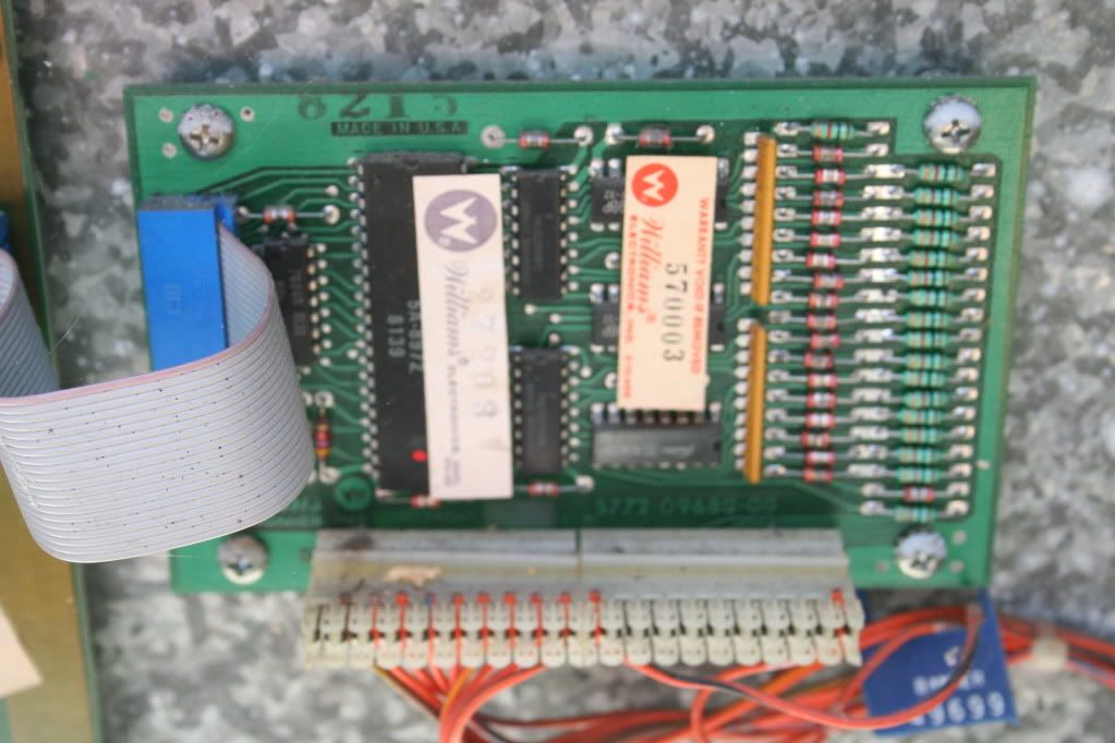

Worked on the main PCB a little today.  First I removed the old battery holder and did the lithium battery upgrade
Next, I replaced these 4116 Ram chips
with the new 4164 chips
and the result
Plugged the game back in with the power mod for the 4164 chips but I still have the same double image on the monitor.  At this point, I'm not sure if this is a board issue or monitor issue.  I did connect the game up to a G07 monitor I had nearby, but I couldn't get the game to sync up (and I didn't have time to mess with it)
Pinball Wizard
  • Posts: 482
Re: Robotron Restoration
« Reply #24 on: August 16, 2010, 07:44:11 am »
I have seen a similar issue with arcade monitors when vertical hold or horizontal hold needs adjusting. Could be something else but I have seen that to double and image similarly.
Where's my gold star :P

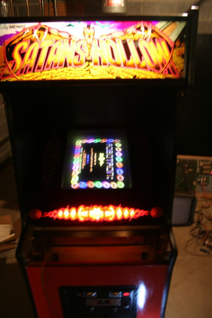

okay, good Great news.  I plugged the game into my Satan's Hollow to see if this was a board or monitor issue.  After initially having the same sync issue as my G07, I moved around a few wires, adjusted the vert hold and had a perfect picture.  That means I have a working boardset.   :woot
I was also able to cut the new top back door out tonight.

Where did you get these replacement shafts from?  I'm looking to do a multiwilliams on a joust or defender cab.  I have had zero luck locating leaf joysticks with the long shafts.
Boy, what a pain this old solder is on the power supply.  Very hard to get it going and I have one spot where I just can't get the solder out of the hole.  Gave up for tonight and will tackle it again tomorrow.

Worked on the underside of the cab a bit today.  Used a pry bar to remove the old leg leveler blocks
Next up, I'll need to cut some 3/4" plywood to size to create the new ones.
Unfortunately, these were his last ones.

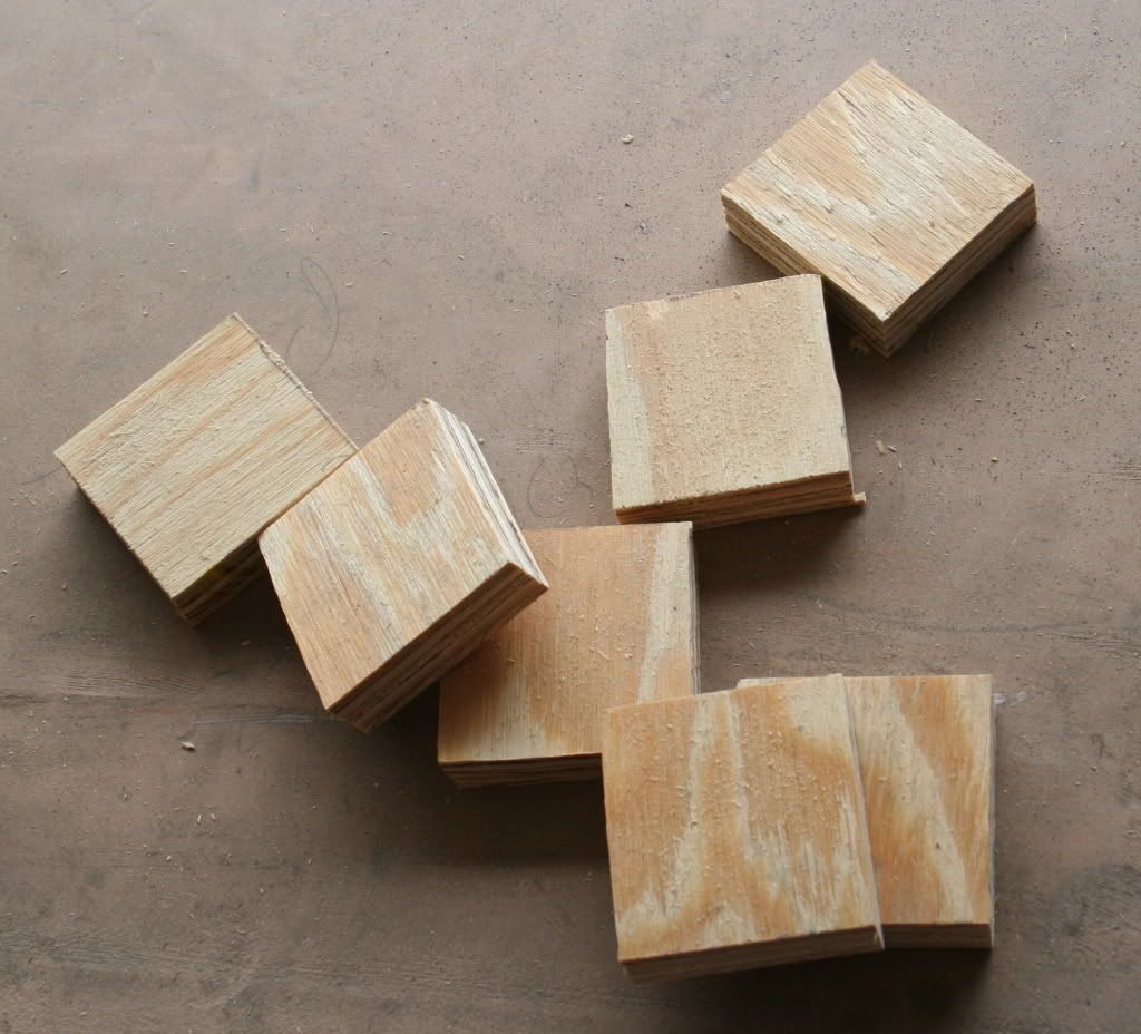

Continuing with the new leg sections...
New blocks cut from 3/4" plywood
Holes drilled and t-nuts inserted
Glued and screwed to the bottom and nylon legs added
I tried out a product I haven't used before on the rusted bolts.  Worked really well.
I also got started on the cab repair.  First I applied some wood glue where some of the plywood was separating.   After clamping tightly over night, I then used an orbital sander to remove all the loose pieces of wood.  There was quite a bit of rot around the corners.
Next, I added some wood stabilizer to strengthen it up.
Next up....Bondo!

« Reply #31 on: September 12, 2010, 08:38:21 pm »
Did some more work on the control panel this weekend.  The bolts holding the joysticks in place were a pain to remove.  I had to use a dremel to cut new holes on the top because they were stripped from trying to remove with a screwdriver.  They were so rusty that half of them snapped in half as I turned them.
I had to remove the t-nuts of the ones that broke off
I'll need to source some new ones and I will probably replace them all since I have to purchase new ones anyway.
Speaking of rust...
Once again the trusty wire wheel brush comes to the rescue
And a fresh coat of paint
Also did some body work on the main cab.  I used my orbital sander to smooth down the cab.  It felt very rough from the old cracking paint.  Now it's nice and smooth.
I also started the bondo work.  More to come...

It's amazing what you can do with bondo.
Before there was no corner, now...
Almost done with the final touches on bondo.  I picked up all the paint this weekend (about $150) so I should be ready to paint very soon.
I also painted all the carriage bolts black.

Finished up the other side of the cab with bondo.  Corners took a bit of work to rebuild, but they look good now
She is now ready to paint.  I took Friday off from work to get started on the first coat of primer.
