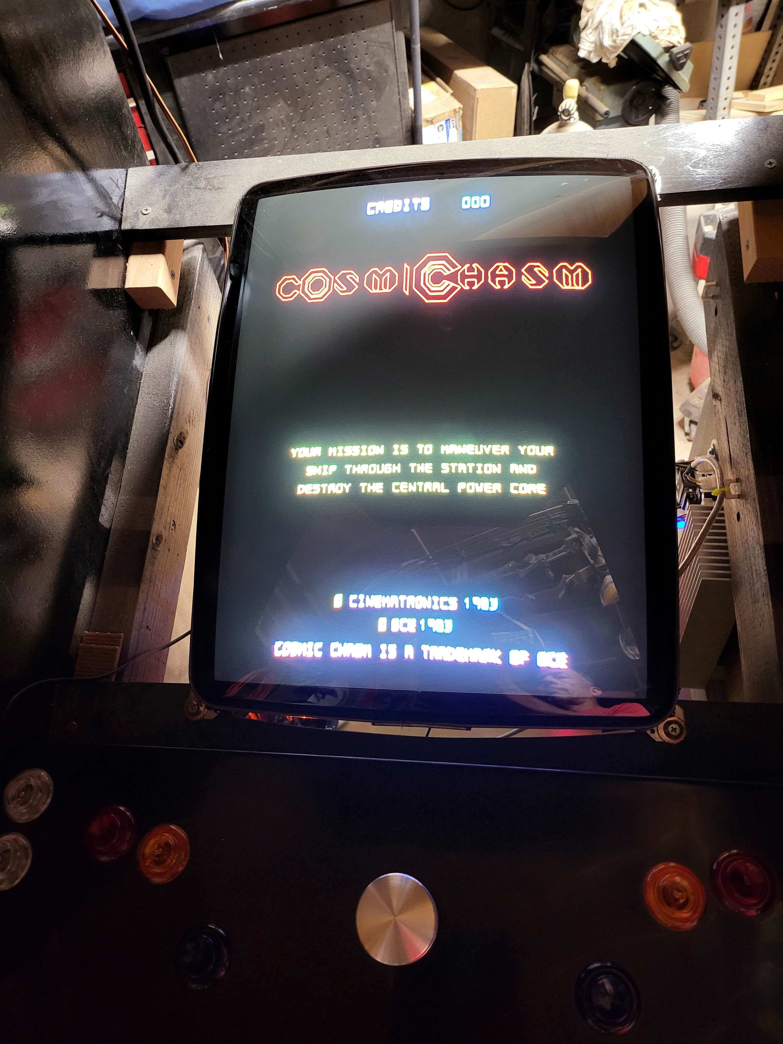

I spent a free morning rearranging components in this cabinet to suit some good cooling so I will update this again when I can get a chance here soon.
bobbyb13
  • Posts: 1995
  • Last login:November 10, 2025, 02:57:37 pm
Re: Vector-gasm... Cosmic Chasm!
« Reply #58 on: March 28, 2023, 08:22:15 pm »
Trying again.
Had a chance to get back to the machine and turn it on after rearranging things finally.
I pulled most of the parts out first to have a good uncluttered think on it.
The result is...
Wound up leaving the power supplies, DVG, and the Pi in the same places and swapped the HV unit and deflection board positions.
Makes for a better cooling layout, keeps those parts as far away from each other and the tube as possible and the parts still remain on the shelf I made for the stuff.
It also allowed me to turn the deflection board on its side and possibly gain a little in velocity as regards the heat being evacuated through the cooling fins.
The 120VAC fan I got is kind of noisy (and may get replaced if it is distracting once I have the bezel area built and in) but it certainly does what I wanted it to.
I drilled a hole in the shelf to allow the fan to draw from wherever it likes and gave it a good angle to shoot into but still across the heatsink.
The other bonus is I got to add a block of ply underneath the heatsink to carry the weight of it on its own.
Prior to component rearrangement and install of the fan I was seeing 185 F on the heat sink next to one of the transistors.
In that same spot the temp is now down to 95 F.
I expected a good drop in temp, but wasn't expecting one that dramatic.
Certainly worth the effort!
I'm stoked.
Audio amp should be here by the weekend I think and after that is done then it's time to start on the bezel extravaganza.
Still haven't decided if I care enough to bother sanding the cabinet again and getting a more proper coat of flatter finish paint on the outside.

With the thousand bpm shake managed it was time to address the broken vector weirdness which randomly appeared once I had nearly everything else sorted out.
Full disclosure:
I have tried three different rewound yokes on this thing so far.
They have very similar values in terms of resistance but produce different quality images for sure.
One was the original to the tube.
Sadly I pulled a bunch of correction strips off of it before I realized that maybe they should stay and I have had major convergence issues with that one since.
Maybe some day I can get it back to good, but dialing in a yoke is pretty heady stuff that I still know almost nothing about yet.
Many of the numerous documents I have found on purity and convergence tuning speak as if it is a very scientific and systematic process that is not difficult.
Ha-
Of all the esoteric themes in this hobby yoke gymnastics are easily the most arcane.
Another fellow CRT maniac here (who is far beyond me in knowledge and skill) has a bucket of old yokes from tubes he has scavenged and last I was at his house we dug through it with an inductance meter and found a few with promising values- so I rewound one of those.
The mounting collar is kinda beat up so it is hard to get the thing to stay seated really well but I tried it anyway.
It too produces a fairly un-converged image.
The kit that I bought second hand from a gent in Canada (although I don't believe it was used- maybe not even tested out) came with a rewound yoke- and that is what is currently (haha) on the tube.
The convergence still gets a bit wonky as you get to the outer perimeter of the screen, but during game play there is really no discernable issue thankfully.
And so even as good as I could get this last yoke to look there was still some weird stuff going on with the image on screen.
Such as....
What was really weird to me at first about these bizarre tails to some of the images is that they don't all head in the same direction or have any consistency to them at all really, but after I thought about it this makes sense.
The image is being drawn by the guns which are aimed at the center of the screen and then the beam is deflected to the proper position and then lit up when it is in the right spot, but it is not as if the beams need to draw one image, go back to center, and then get bent around again to draw the next.
If you crank up the screen adjustment on the HV unit (lower dial on the 'flyback transformer'- which it isn't in this case- even if it looks like one to you) you can actually see the path of the beams as they are flying around the screen- and then these weird tails on images make sense.
It is a pretty impressive sight really.
What I was looking at is the beam getting lit up ('Z' axis voltage in Atari-speak) before it actually got to the location it was supposed to be drawing something.
So the deflection board is (very!) slightly slower in bending the beam than it is in lighting it up- and hence the timing being off just that little bit makes for a line where you don't want one.
Enter Slew Rate.
The USB-DVG has a menu all on its own, accessed by a button on the board itself.
The first thing you see when you access it is this.
As my world expands here I am starting to figure out what all this crap is now.
The first line is an obvious one, as it lists all of the original vector monitors here (G-08, WG6100, Amplifone, etc...) and selecting one automatically loads the settings below for what works best with a healthy original monitor.
I selected the Amplifone one for this to begin with since that is what Barry cloned here with this kit but this is where the nuances of this hole thing begin to get tricky.
Note that I said that those default settings are for a "healthy original monitor."
My boards and tube are fine BUT, this is NOT an original yoke- and this is where it starts getting sticky and this is all finally making sense to me now.
My rewound yoke does not act EXACTLY like an original Amplifone one because the outer yoke coils, although having been rewound to get close, are still a slightly different inductance/resistance than original (so are the inner ones for that matter) and therefore they DO NOT deflect at exactly the same rate as original ones do.
Cranking up the Slew Rate allows the beam to get knocked around faster (it allows a faster rate of voltage change to the deflection to more precise) and therefore get to where it is supposed to be in time for the 'Z' axis to get lit up at the right time and draw the images properly.
Neat, yeah?!
Even just a few ticks of bumping up the rates yielded great results.
Behold!
I'm still trying to figure out exactly how the "Jump Rate" and "Beam Delay" settings affect what I am seeing.
Anyone who knows more about electronics here please chime in!

After all of my agonizing about using the original yoke the great irony is the one that's on it right now and looks the best is from a different tube, and I don't know exactly which tube even.
It's possible that in the future I may decide that it needs to be perfect but at this point it looks so good that this one may just remain as it is and what I have learned here will just be applied to the next ones.
Of course had I seen your caveat about not messing with the other magnets on the yoke in time to begin with I probably wouldn't even be in this spot!
There are still a few details for me to learn about how all this vector hardware works and how it can be adjusted but as a first run of sorting it out I can call this machine a success at least.
This thread may go quiet for a bit while I hope for bezel and shroud details to materialize (thank you again Mike for the offer of a shot at it.)
As this go round has a fairly exhaustive breakdown of getting the Pi and DVG as well as the controls working I may just leave this thread as a reference for that and use the next build for more monitor detail.
It's been a fun journey so far no matter what!
