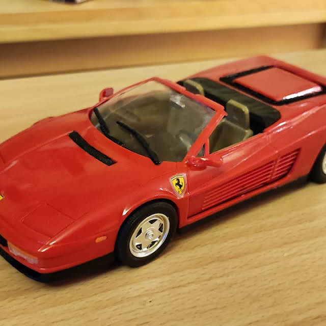

Thanks dude. I ordered a sheet of variable size Ferrari water transfer logos for models from eBay earlier in the week. Currently winging it's way in the post to me from China.

Oh, and the Ferrari logo transfers arrived from China. Whoop!

Some further progress today. I cut a hole in the area where the marquee was and replaced it with a bit of clear plastic (cut from a CD case) and then used a bit of plastic sprue (more leftover stuff from the model Ferrari kit) to create a mount for the LEDS and then hot glued them in place. I also cut the hole in the bottom of the cabinet for all the encoder wires and charging cable to pass through so they can sit in a separate base. I was also able to see how the phone would line up inside the case with everything in place and drill a tiny hole in the side to use another bit of plastic sprue as the 'on' button (physically pressing the on button on the phone) and I was able to see how it'd look going through the side art, with the stuff I was just using as mock ups. Some backwards progress as well unfortunately, the right directional input has stopped working, I think as I was manhandling the PCB through the hole I'd made in the base of the cabinet, the solder on that input got detached or something (it looks weird on the PCB), so going to be taking it back up to James' at the weekend (he reckons it might just be a bit of dodgy soldering on his part on that connection).

OK, back panel on. I probably could've tried to get it looking a bit prettier, but, ehhhh... As I said before, no one's going to be looking at the back of it.
So, the mini cabinet is now 100% finished at last. Here's a couple of before and after photos with the spare one I purchased off Amazon right before I started.
