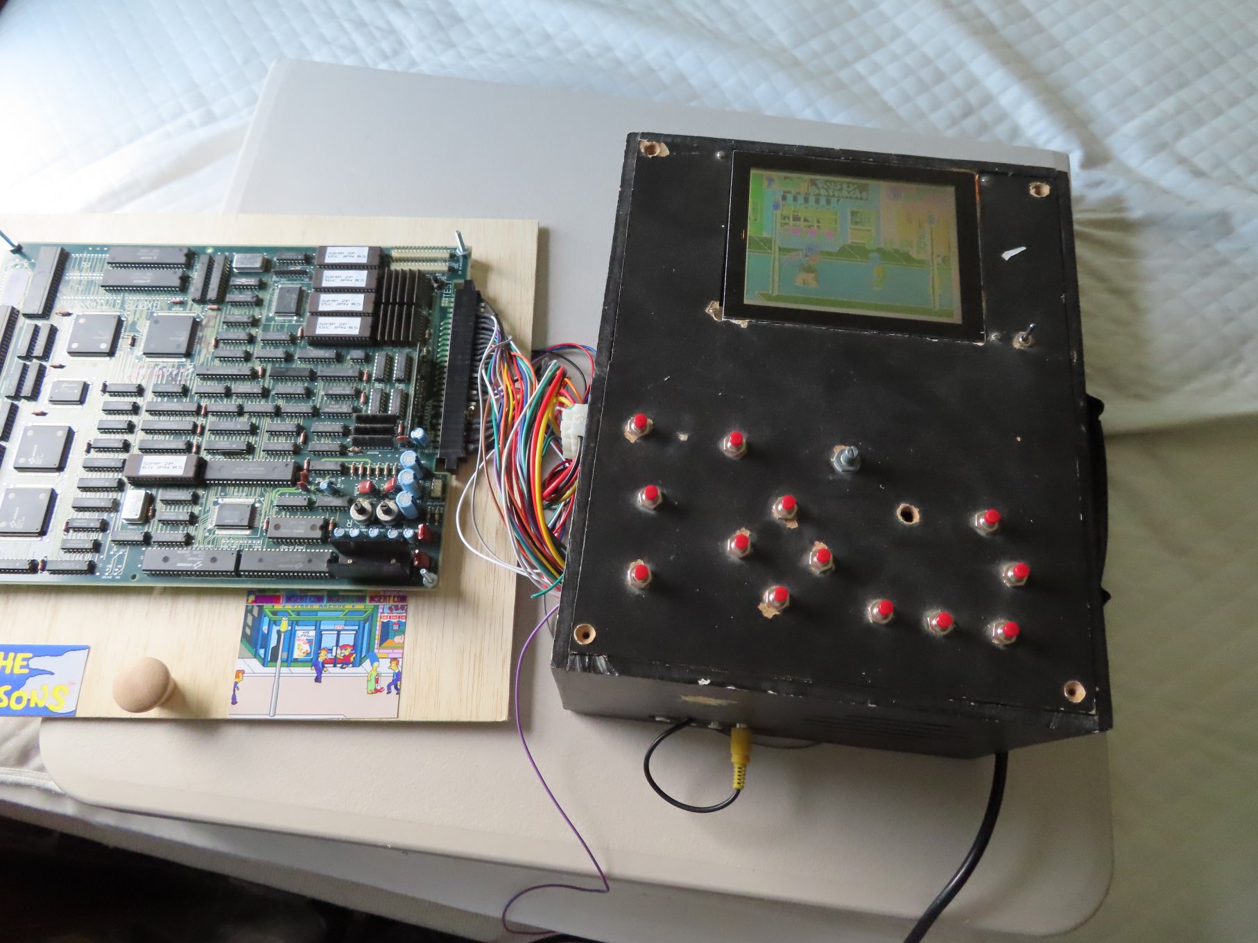

This build is not my first attempt at a “Supergun” device. Back in 2009, I made a small, crappy box for testing JAMMA PCBs.
Featuring a cheap LCD screen (originally designed to snap on to a Nintendo GameCube, making it more portable), the display is washed out if not looking at it at the perfect angle. It even had a row of pixels not working before I re-purposed it for this project. Video is converted by a Jrok Encoder, allowing for composite, component, and S-Video out. Sticking out near the bottom, the Jrok has a composite cable running back inside to the LCD, but could be disconnected to make way for an external display. Sound was limited to a small speaker that stopped working, and I never bothered to fix it.
Powering the whole thing was an old PC power supply. Meaning it had no adjustable +5 volts, and no -5 volts. The mess of pushbuttons on the top allowed for complete navigation in game service, mimicking Test, coin buttons, Service, P1 joystick directions, start, and first 3 action buttons, plus P2 start and action button 1. The P2 buttons were included for service menus that needed them (example “press P1 and P2 Start to exit”). The mess of pushbuttons was not meant for actual gameplay. The side offers 2 15-pin connectors for hooking up external controllers (using my controller pinout), as well as a single coin counter for both players.
This box never worked very well and collected dust over the years. Parts will be scavenged for the new testing unit.

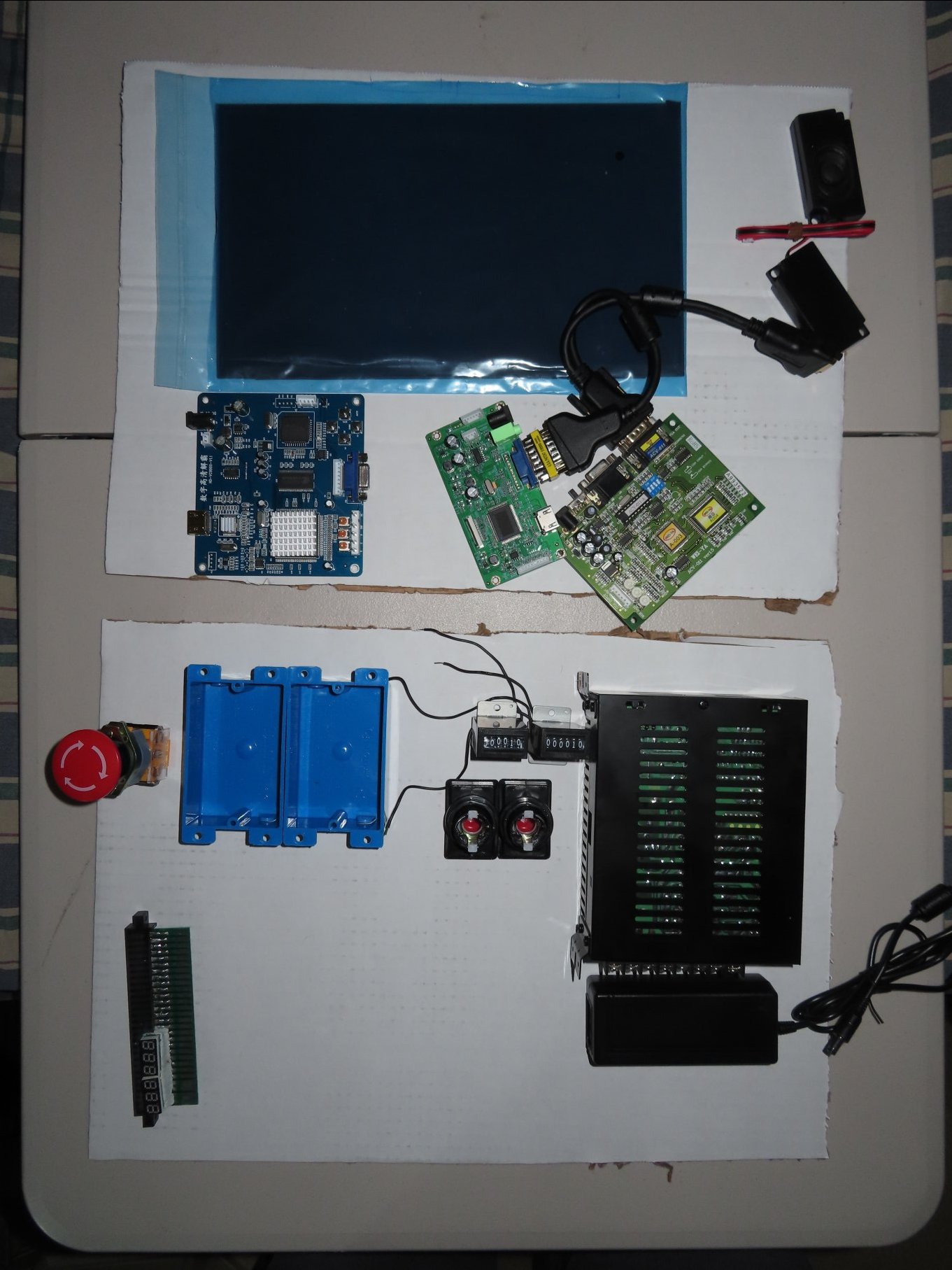

Part 0: Gathering the major components
Some of the parts I already have, but there were a few key things I needed. I started with the LCD. Purchased last year, I went with a VSDisplay 13.3” IPS LCD, with a resolution of 1920 x 1080, purchased off Amazon.  This board takes both VGA and HDMI inputs. I know it's widescreen, but I think it still suits my needs at an acceptable price.
(Don’t mind the red text at the bottom. It’s printed on the protective film that’s still on the screen).

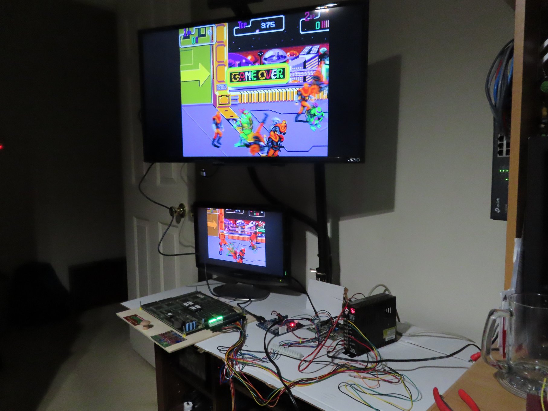

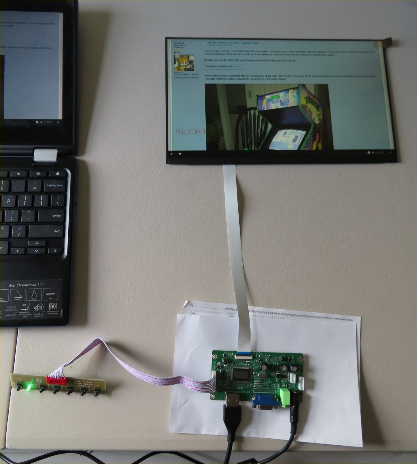

Amazingly, I was testing it with the Naomi (which can output 31 or 15 Khz), and the LCD worked with both settings. I then tried it with my Simpsons board and the LCD worked directly with it.
I do still plan on having convertor boards for external displays anyway, so I do plan to use one for the LCD. The specs for the controller on Amazon don’t mention 15 Khz or CGA, so I don’t want to rely on that working with every game.
I picked up some thin speakers. They’re actually made by the same company as the LCD, and designed to plug into the LCD controller. I plan to hook the speakers up differently though (so I don’t have to use an on screen display to adjust the volume.)
I also picked up a CGA to HDMI convertor. So in total I have the Jrok (outputs composite, component, and S-Video), a CGA to VGA convertor, and a CGA to HDMI convertor. For this project, I decided to use the VGA and HDMI boards, as those are the displays I’d more likely use when working on boards. HDMI would also work with my Elgato video capture unit. I may still have a way to use the Jrok plugged in as an external unit to this setup, but the HDMI and VGA boards will be built in.

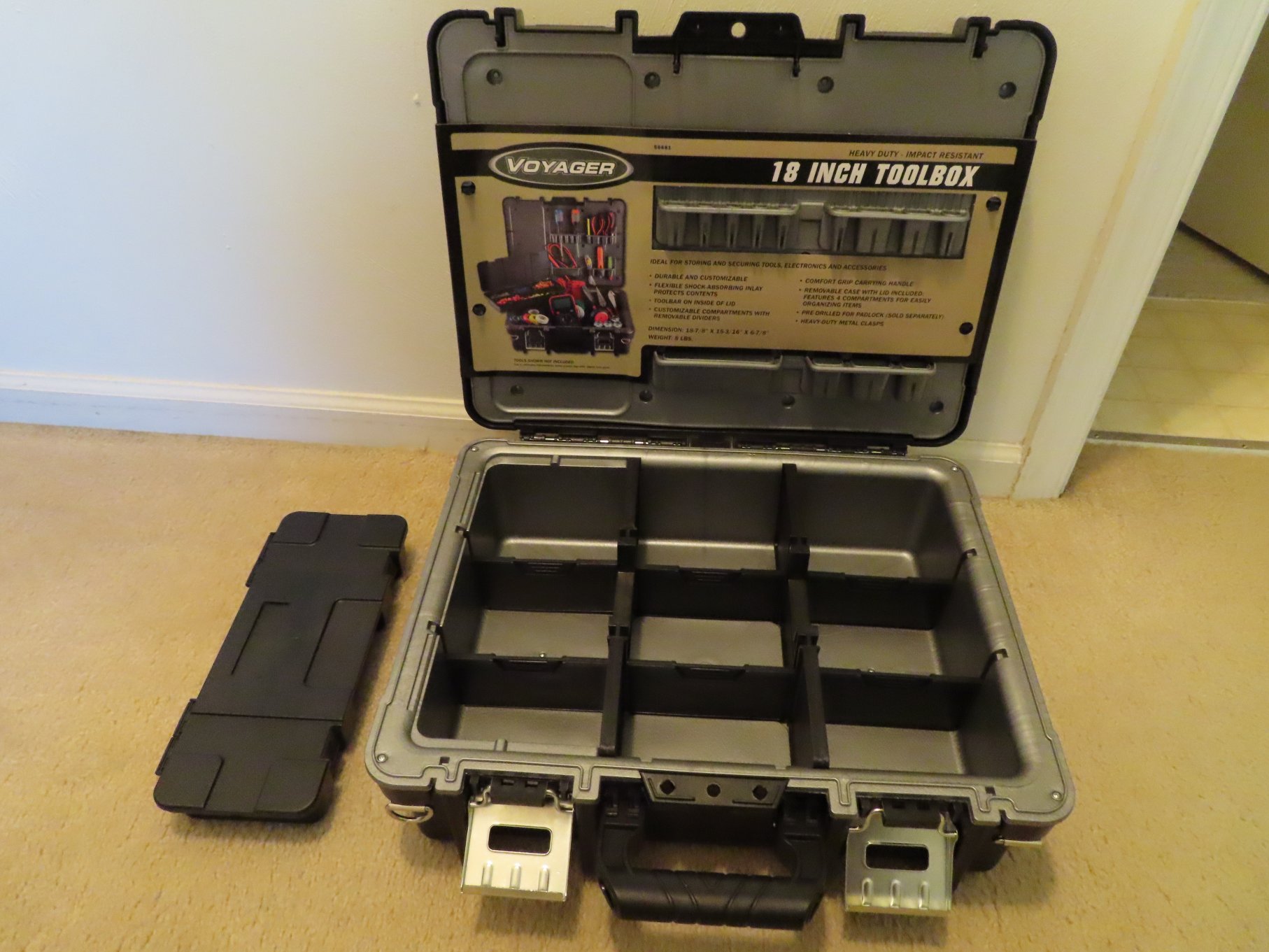

I looked for a case big enough for the LCD, and deep enough for the JAMMA power supply. I found this at Harbor Freight. I probably could have saved money by ordering online, but I wanted to get going on this project. The case just felt right anyway. The grey panels are screwed in and can be removed, making modifications a lot easier.
Oddly enough, I didn’t even realize the case name was “Voyager” until after I came up with the project name.  I came up with that name separately, while thinking of the portability of this setup.
Before doing anything, I cut some cardboard the same size is the case innards. I then figured out a rough layout of the major components. Things are still subject to change at this state, and I realize I forgot things like the audio amplifier. Also little things, like the LCD will be centered, the speakers will be one on each side of the LCD, and the VGA / LCD boards will be lined up better. Still, I now had a plan. Oh, the empty space on the bottom one is for holding the controllers and the JAMMA harness.

Getting close to finishing this project.  :cheers:
Here’s the upper panel, removed from the case.
Notice the holders for tools. Carefully cut those off, to make a flat surface to work with.
I decided to put the LCD mounts first, then put the other parts around it. I started by making wood standoffs, then cut some Kydex into “L” brackets (more like squares with notches cut out). You can see these bits plus the wood prototype for the Kydex brackets here. Not shown are the bolts for the LCD mounts. I cut a slot on the ends to fit a screwdriver, so I can keep the bolt from moving when tightening the nuts later (the head of the bolts is behind the panel, where I can't get to once the panel is installed.
I figured out where to put the mounts, test fitted the LCD, and drilled the correct holes.
Note that the LCD has a sticker I put on to mark “up” (when I was testing it once. Didn't want to mount it wrong), plus a piece of duct tape to mark the top center. These are on the protective shipping film on the screen, so it will all come off with the film later.
Now to mount the support electronics.
To the left and right of where the screen goes, there are small 8 ohm speakers (they look like the type you’d find in a laptop). They will be wired for mono though.
Bottom left is the CGI to HDMI convertor. Next is the LCD controller board. A terminal block is at the center bottom, which will connect just about everything to the main unit. Finally, the bottom right has the CGA to VGA convertor.
Also, two small wood standoffs were mounted to support the LCD from the back.
I wired everything up, including the VGA cables. This goes to a Y cable, which one end goes through a small VGA extension and to the LCD controller. The other end is open for external monitors. Cables and such were secured by zip ties.
On the main case, I used my moto-tool to grind down areas of the inside supports to allow cables to get though. This took some time, as I wanted to make sure that no cable got pinched. I had to grind down quite a bit for the VGA cables.
I bolted the top panel into place, put the screen in, and wired the top panel to the main unit. I tried some games, and…didn’t get anything on the LCD for some of them. Street Fighter II gave me an image, but games like NBA JAM and vs Super Mario Bros (using a Mikes Arcade JAMMA adapter) wouldn’t give me an image on the LCD or on an external VGA monitor. I did get an image on my HDMI TV though.
So, after some more testing, I removed the VGA splitter and cable, and I connected the LCD to the HDMI convertor instead using a short cable I had. So this should work for now.
Pulled off the protective film from the LCD, and mounted a plexiglass cover.
Voyager is fully functional now. I do still have to put labels for the controls, and a few other small things. I’ll post more photos when I have time to do a better “photo-shoot,” including different external screens. I plan to also keep this topic updated when I use it to set up or fix some of my PCBs.

« Reply #20 on: June 13, 2021, 11:06:42 pm »
When I last posted, I needed to make a video cable to connect my LCD screen directly to the video connections from the JAMMA harness. After some time, I managed to get a working cable (I had done this before when testing the LCD, but I didn’t have any pictures or data on the actual wiring.)
So today, I decided to test my video options with every JAMMA game I have.
The top left TV is connected by my HDMI convertor – a Mcbazel HD-VC9900-V1.1 that I bought off Amazon.com a few months ago.
The bottom left (smaller)TV is connected to a JROK RGB encoder, which I decided to wire up and try with the other equipment. This is the one I pulled out of my first test rig (I’ve had it since 2006 based on emails). This board does composite, component, and S-Video. I’m using S-Video in this setup.
In the Voyager unit sits the LCD, a VSDISPLAY 13.3” with controller board. The screen and controller board are just laying in there, since I had to pull them out for the rewiring. Note that there are no resistors on the cable, so the LCD screen is really bright. I’m just seeing if I get a stable picture on these screens, and can fiddle with the finer settings later.
And finally the monitor on the right is being driven by a Wei-Ya ACV-001 CGA to VGA Convertor . This board has dip switches, so the chart below will have switch setting listed if the board works with that game.
Those are the 4 display connections. Now to test the games.
So these results are interesting. The LCD direct fared the worst, followed by the HDMI. VGA did a bit better, but caused some issues with the LCD and my Capcom stuff.
Surprisingly, the JROK Encoder was near flawless. It only failed on NBA Jam, but so did everything else. Though in the chart above, I should have marked Neo-Geo for JROK as “Partial” since it needs the other converters turned off.
An interesting side note: I also tried my JAMMA PC (a Windows 7 computer using CRT Emudriver and an Ultimarc JPAC) with it, and it worked for the most part. However, when I tried NBA Jam in MAME, the JROK behaved the exact same way as it did with the real PCB (rolling screen). I think this shows just how accurate Calamity’s work on GroovyMAME and CRT Emudriver really is.
So my plan now is to remove the VGA adapter, and put the JROK adapter in. I plan to wire the LCD directly, once I get the resistors in that I ordered. I also plan to have the HDMI converter hooked up to the LCD as well, and use the LCD menu to switch inputs as needed. Between those two connections, I can do all my games on the LCD except Tekken 3 and NBA Jam.
I'll probably put the VGA convertor in a project box, so I can connect it temporarily to the terminal blocks when I need it. I would try the newer CGA to VGA board, but it looks like it's made by the same group that made my HDMI convertor, so it probably would handle the games the same way.
