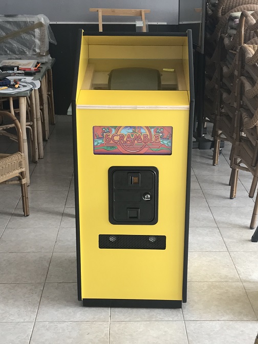

« Reply #135 on: May 03, 2021, 11:08:10 am »
Just a quick update on progress.My second marquee arrived.Totally happy with this one.
 The first guy i used charged me to restore the scramble marquee artwork,not a lot,and has a policy of not releasing the artwork files to the client after sending prints.Is this usual?
The second one was printed from the image I found online and looks identical to the restored one.
Anyway the coin door arrived today,i felt more than a little relieved when it fit just right,having cut the hole what seems an age ago.
Also i ordered the U360 stick.Id wanted the servostik but the shop i was using didnt have the control boards in stock.
 I intend to replace the U360 with the servostik.I just wanted to get things moving and when the stick arrives Ill be ordering the CPO.
So Im hoping the U360 and servostik share the same hole pattern.Ive looked about,on slagcoin and the Wiki here,and cant find out for sure.
Anyway a bit of progress has been made.
Re: First upright build-Tully Cabaret Plans.
« Reply #136 on: May 03, 2021, 11:19:19 am »
That looks fantastic.   :cheers:
  • Posts: 7994
  • Last login:October 30, 2025, 09:56:45 am
« Reply #137 on: May 03, 2021, 12:30:57 pm »
Great looking cabinet!  Coin door definitely makes it look 1000x better than not having one.
In my experience (once LOL), a commissioned artist should provide all of the drafts and the finished product to you so you can reproduce it as many times as you want.  Maybe this is something that you need to state up front?  I didn't though and got everything sent to me...
lomoverde
  • Posts: 283
  • Last login:June 03, 2025, 06:12:17 pm
« Reply #138 on: May 04, 2021, 03:00:33 pm »
He does actually state on his website that he doesnt release the files,but then he couldnt provide the promised prints....anyway its all put down to experience now.
Amazed to recieve the U360 today,i was expecting at least a week longer for delivery.In hindsight i could have waited for the servostik control boards to be in stock.
So i opened up the CPO design again,and hadnt even thought about the dust washer covering the art like it will.So Ive had to adjust it a bit.Problem is I cant have both the arrows and text.So its one or the other i think:
Im leaning towards the text version.
Ive also removed the black circle around the joystick as it will be covered anyway.
If I get this sent away,the end is in sight  :applaud:
« Last Edit: May 04, 2021, 03:03:59 pm by lomoverde »
I like the bottom one as well
Yeah,if I cant track one of those smaller dustwashers closer to home,I think Ill go with the bottom one.
I like the text version and love that cabinet.
the yellow with marque just pops.
