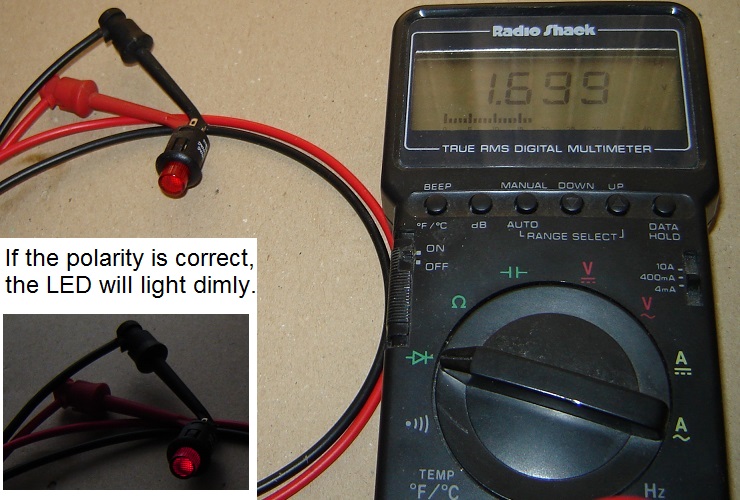

Alright... wiring is complete and... nothing.  LEDs not lighting up.  Not sure what I did wrong but here's a quick video walking through it.
Any help at this point would be appreciated... I literally have no idea what to try next to turn these LEDs on.
I made 2 separate runs from the two 5V pins on the iPAC2 to what I think is + on the volcano button with the 220 ohm resistor soldered in-line for each wire.  Then I daisy chained the ground wires and ran that back to GND on the iPAC2.  I plugged the iPAC2 in and the green light came on so it has power but the LEDs did not light up as expected.  Do I need to tell the iPAC2 to provide power to those pins in software or something?
Thanks guys. :cheers:

Time to troubleshoot.
First step, test the LEDs and confirm the polarity.
- Remove power to the panel -- the multimeter will provide power for this test.
- Set your multimeter to diode test.
- Touch the leads to the LED tabs.
-- If the leads are backward, the LED won't light.
-- If you swap leads and the LED still won't light, either the LED is bad or you're on the wrong tabs.
-- If you have the correct polarity and the LED is good, it will light dimly. (make a note of the voltage displalyed on the meter)
Next step is to check if the LED is getting enough voltage to forward bias.
- Set the meter to VDC.
- Restore power to the panel.
- Touch the leads to the LED tabs to test how much voltage is dropped across the LED.  Compare that voltage to the voltage during the diode test.
-- If the voltage is lower than during the diode test, you need a lower value current limiting resistor so the LED gets enough voltage to forward bias.
Use a calculator like this one that Zebidee linked earlier.
- Fill in 3 of these 4 values and click on calculate.
  • Voltage source = 5v
  • Voltage drop from LED = voltage from the diode test
  • Current through the LED = usually between 15 and 20 mA
  • Resistance = current limiting resistor value

Use your multimeter to check voltage out of those IPAC pins.
Make sure you have the polarity of the LEDs right. Long lead/anode to the voltage, short lead/cathode to ground.
Double-check that the GND you are using is connected to the GND on the trackball socket you are getting your 5v from (continuity test). However I expect they are.
Also, ... even though they worked for someone else, 220R for the resistors IMO is marginally viable and might be too high for your particular case. Try 150R if you have them. Even small variations in manufacturing or voltage available from your PC/PSU/IPAC could be enough to make the difference between the LED working in one case and not working in another.

Another thing that you may want to consider is some alternate meter leads.
- Alligator clips
- Micrograbbers
- Sharp point leads for poking through conformal coating
This inexpensive set has a good variety.
https://www.amazon.com/Electrical-Multimeter-Alligator-Probes-Professional/dp/B074L1NXRX/

OK so all I had to do was switch the + and - on the LED leads and that did it.  So the reference photo floating around here had it backwards at least for the reproduction from arcadeshop.
I’m super psyched.  Now I need to figure out how to attach the CP to the cabinet without drilling through the top.  I’m hoping some cocktail clips will work but the problem will be getting my hand up through the coin door for access.
. . . and that's why everyone in this hobby should have multimeter.  :P
Glad you got the LEDs working.   ;D
