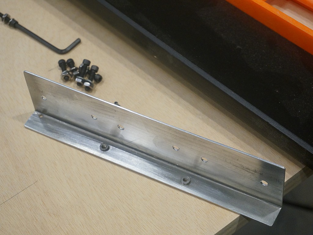

As of the current design, the chair base I made in the posts above is going to run on wheels on carpet.  The wheels will be spring loaded, lifting the skirts of the seat base just above the top of the carpet so it rolls, but lightly sprung such that he weight of a person sitting in the chair drops the skirts to the ground and those then take most of the weight so it becomes stable.  (Kind of like those rolling stepstools you used to see in libraries.)
I'm going to use the rear axle as one of the springs.  It is 8mm diameter surface hardened stainless shaft.  I figure it deflecting about half an inch over a foot of run shouldn't make it take a permanent set, and feels like it's about the right stiffness as a spring to do what I want.
I need a strong mount that attaches this axle to the center of the rear wall, offset by slightly more than the radius of the wheels, because the wheels are going to run inside the box and I want them not to quite hit the rear wall.  The wheels I liked best of about the right size turned out to be replacement wheels intended for those kick scooters - $9 with all bearings per pair of wheels, and they look nice.
I rummaged around my shop and found a block of aluminum.  Laid out the shape of the mount I have in mind on it with a pencil, and grabbed it in the mill.
The milling machine makes a really rigid drill press.  The working space is tight, so I still use my drill press most of the time - but if you have a small part you want *precise*, this is a good way to do it.  I wanted this axle hole to be VERY perpendicular to the faces, so that an almost two foot axle would have the right gaps between the wheels and the back skirt wall way out on the ends.  With the big face of the block flat on the machining vise, and the mill trammed and square, this hole should be dead on.
I drilled it out, and did a test assembly on my work table.
Aaaand it's wrong.  One of the wheels rubs on the table.
 :angry:
The hole is square to the face, alright.  But the bottom edge of the block wasn't actually square, and that makes the block lean.  If I squared the bottom of the block, it'd be squared to the low side, and it'd be too short.  I could make a spacer to shim it out, but... I'm all of five minutes into this part, let's start over.
Back to the drawing board.  Dykem layout fluid, scribe some lines, rotate the part 90' and give myself more room to square up the block later....
Tweaked the design a little to just miss that first hole, drilled the new axle hole, and life is good, this will work.
The clearance above the axle will be tight to fit under the brake pedal, so the bulk of the clamp is toward the bottom.  Two screws in the front (left edge) will bridge across the slit cut and squeeze the gap shut against the axle, which should make it lock up tight.  Flange on the right, for screwing it to the plywood of the back wall.
To my beloved little bandsaw it goes, to rough it out:
You might think 1.25" thick aluminum billet would be hard to saw.  Sure, with a hacksaw it would be.  But not with this.
I roughed it out with a little gap to the line, because I plan to mill it for fancy appearance.
Milled to contour, and with the front holes drilled, it does indeed look kind of fancy.
These holes in the front are 2" deep, and tapped 10/24 on the far side of the clamping slot.
I couldn't reach deep enough to tap the bottom of the hole, though, reaching through the front of the clamp to do it.  So, I was forced to shorten the cap screws a little bit; they still have a good inch and a half of aluminum threads, so they'll hold fine.
Shortening screws on the knife grinder is just fun.
Best done in short bursts with a water dip between so you don't screw up the heat treatment, but still, it's a sparkler.  It sparks joy, okay?
Here's the complete rear axle assembly sitting on a table.
When attached to the back wall of the plywood box through to-be-drilled holes in the flange, this will hold the axle and take in side load the weight of the human sitting in it, as the axle bows up, until the skirts hit the ground.  Takes maybe 30lb to do that, I think.
The front wheels can't work this way, though, because they need to straddle the pedal frame.  They are next.

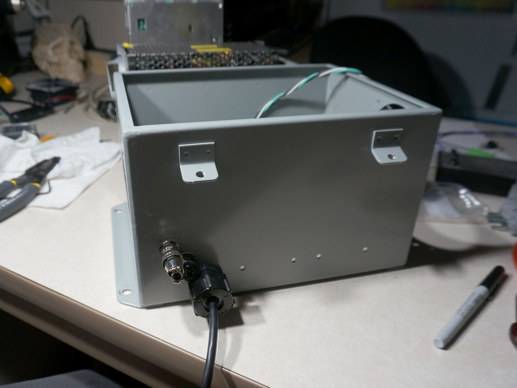

The project is now turning towards the power control box.  This is going to be a steel project box located behind the pedals that contains a whole lot of power supplies, solid state relays, DIN rail and wiring, and is one of the places I'm very glad to collaborate with my father on, to make use of his superior EE chops.  This will support the power demands of the two big linear actuators to transform the machine, and pinball toys like the flipper contactors, slingshot contactors, extra ball knocker, and so on.
Here's the box, sitting on the wooden floor that fits between the rails of the pedal frame.
Marked out on it is a required aperture to be made for an 80mm filtered intake fan.  The exhaust side will go out a duct on the back wall.
I cut the aperture with a hole saw, drilled some other mounting holes, and got the fan mounted in.
This power control box will interact with the floor and the back wall somewhat like so:
These brackets will go to thread inserts to make one side removable, as the whole machine comes apart into reasonably sized modules for the sake of rebuilding in the house instead of the shop when it's done.
The air duct exit on the back of the steel box will need a place to vent, preferably beyond the back wall, instead of under the playfield monitor.

This weekend was about the power control box.  It's been pictured in a few prior updates; it lives on the floor behind the driving pedals, underneath the pushed in chair, in front of the back wall.
When I first proposed this project, rablack97 voiced a concern that there'd be insufficient volume to accommodate the parts and wiring necessary for a good vpin because of the design.  This box is one of the places those guts live.
First, I had to cut and drill a lot of holes in the steel box.
(Then I had to remove a whole lot of conductive steel shavings and swarf, because that's not something I want floating around in here.)
My dad gets the credit for the creative use of space that follows...
A 12v power supply mounts flat on the lid.  A 24v power supply mounts -edgewise- on the lid.
The 12v will be running the 9 amp (max) table rotating actuator,  the 9 amp (max) control panel sliding actuator, and the intake fan.
The 24v will be running the flipper contactors, the slingshot contactors, and the bumpers.
Next I took a PC power cable, cut the insulation off half of it, and threaded it through a heavy duty strain relief panel entry.
This will be the 120v AC in to this box for the various power supplies, and for the big 120v contactor I'll be using as a knocker.
Immediately above and to the left is a fuseholder and fuse; power goes to it first, then everywhere else in the box.  Above and to the left of the fuseholder is the connector we'll be using to run up to the rotating playfield, for sending 24v DC to the flipper and slingshot contactors.

To help mount those, I fabricated a neat little bracket out of sheet aluminum.
Cut out a rectangle of .060 aluminum, folded it to 90' on my little 12" finger brake, drilled it, and pushed in some pem nut thread inserts.
This thing mounts 6 solid state relays back to back, and acts as a heat spreader for them - here's a test fit of the four on the ends.

This is most all the mounting that needs to go on to make the power control box mechanically complete.  It is likely to get disassembled again for wiring, of course, because getting into these spaces to wire it would be needlessly tricky.
As oriented from the pinball player's perspective,  the front wall of the box has the 120v power, fuse, and a connector out to the playfield.  The back wall of the box has the DB25 signal cable to the backbox, and connectors for 1) the control panel stowing actuator, 2) the playfield rotation actuator, 3) the replay knocker, and 4) the various limit switches that will confirm to the PC whether the TV is horizontal or vertical, and whether the control panel is stowed or retracted.
Next up is probably wiring, and some bodywork on the floor/back wall/midshelf - that's the last batch of parts to be painted black by my count.  I've cut the back wall and midshelf back to what I think - fingers crossed - the actual correct final distance from the front cabinet to the back cabinet should be.  Man I hope I got that dimension right, because it'll be a pain to adjust if I missed.
