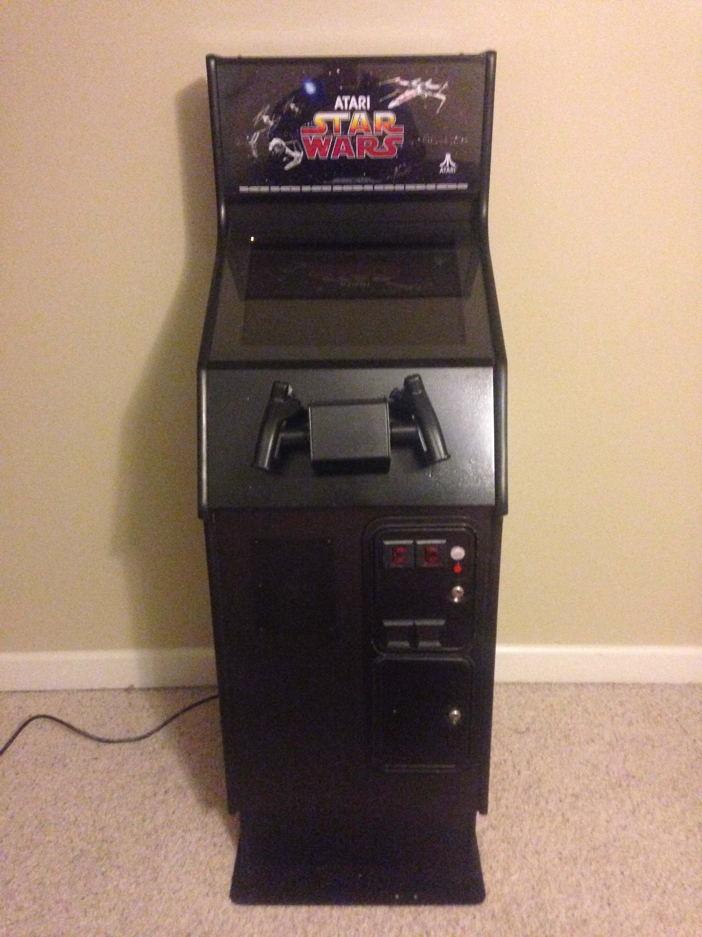

I appreciate the feedback everybody!  Couldn't have gotten here without your input, and I think it has really paid off.  I'm happy.
<<original post>>

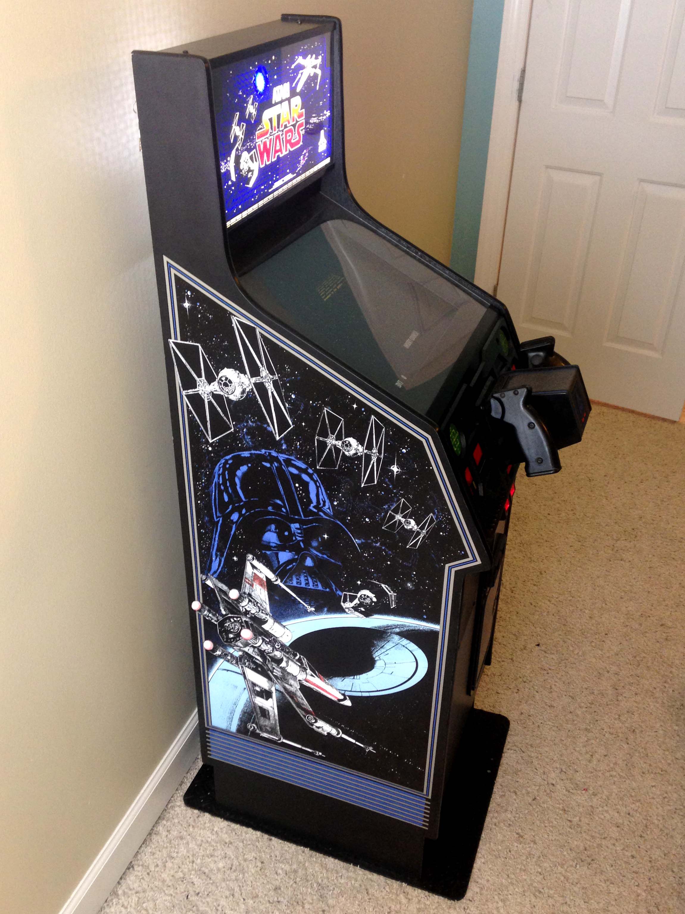

Those that keep up with my real world life (why would you) and don't know, I moved this past spring.  This triggered a number of things happening all at once.  Namely some very hard choices about the masses of wood and CRT living in my garage.  My Daytona now lives in a buddy's garage in Alabama and his kids are enjoying it on the regular.  Passed it off for free because he's a bro and had recouped most of my original investment from parting the second.  In case anyone wants a stroll down memory lane you can clicky here.  Also got rid of Idle Fingers aka Last Starfighter aka the STUN Runner retheme because that MF was heavier than the damn Daytona.  Holy hell.  Changed out the yoke for a regular one and slide in a less robust computer running a tight list and it was gone gone gone.  That thread is here if you're still with me.  TAF moved because you won't be able to pry my TAF away from my cold dead fingers.  All the unfinished project whatnots moved.
That left me with a lot to do, but most importantly a of bin random cabling, PC components, and my Yoke+ which is still a thing, but I think I'm down to only one game that I use it on.  Probably just replace it with a button eventually.  Over the summer I did some thinking and decided that a smaller form factor might just be the way to go.  Something I could move around and not stress about.  Something like a cabaret...only SW never had a cabaret.  Well it freakin' does now!
I briefly had a Monaco GP cabaret before determining it was way beyond my restorative powers, but long enough to realize it was the perfect cabaret for a SW build - so I copied it.  Wood work took a weekend, had a friend with a metal brake brake some metal for me.  I *may* at some point down the line add a pedal to this, would help out on a few games and open up a few others - but likely as much not.

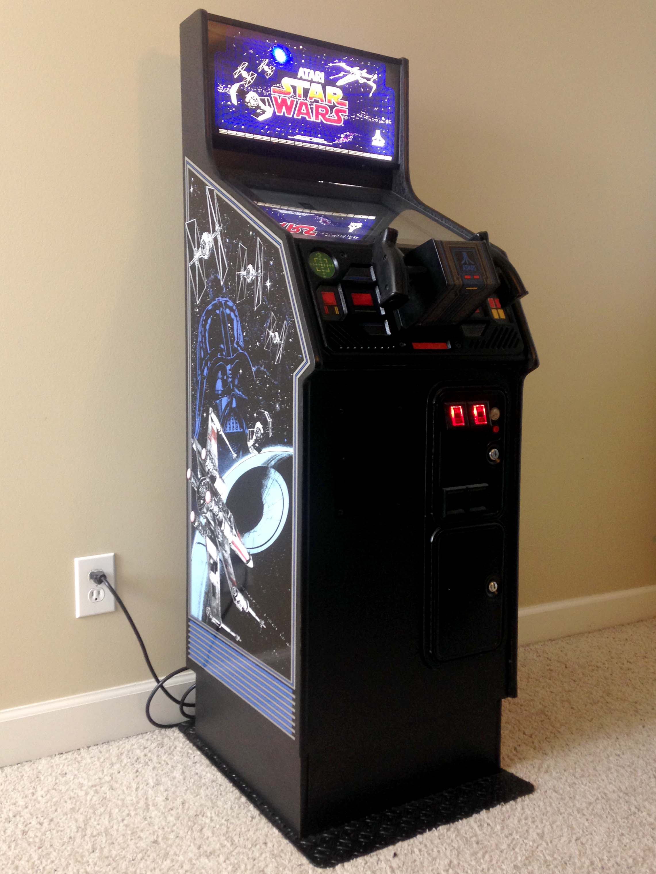

Anyway, we aren't complete yet but here's what we are!

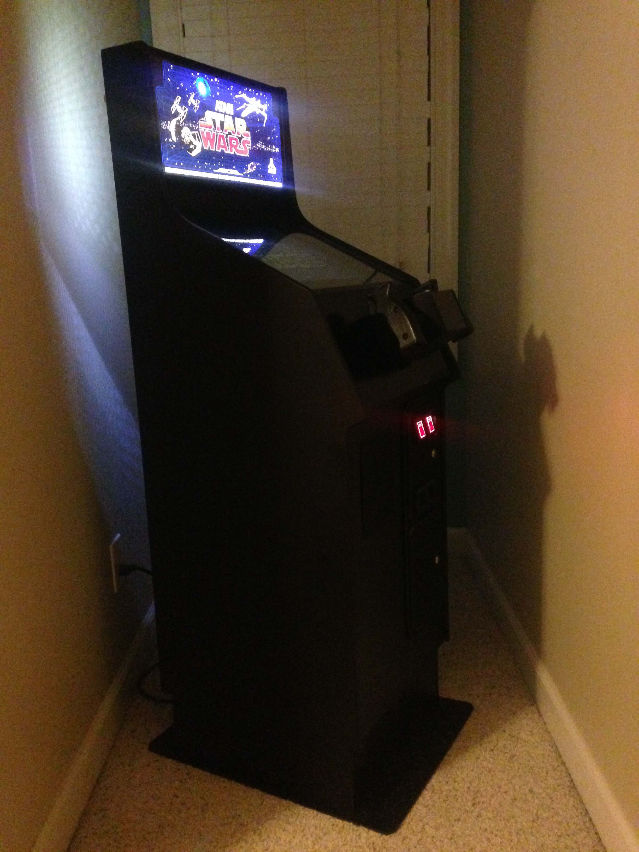

Top down view for a bit of scale.  It's super comfy to play.  We are running a 19" 3:4 LCD that I just got this past week (for freeeeeee).  Before that I had a 17" in with a ghetto temp bezel and light leaks everywhere.  It's been in the house since late September I think, maybe August, but had a crappy monitor and no marquee for the longest.

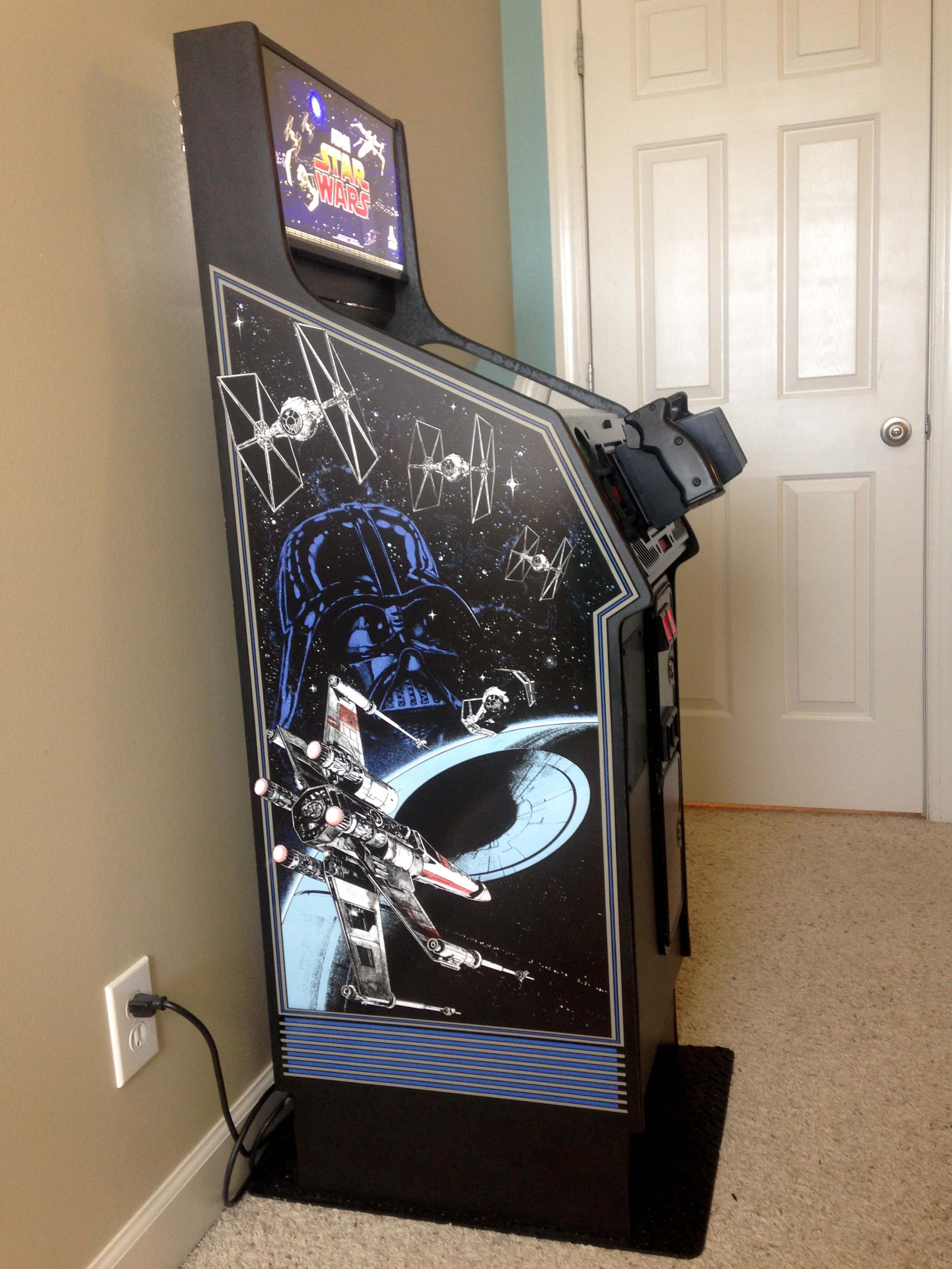

A bit of side action, the cab is laminated head to toe, which only takes one sheet for this size of build.

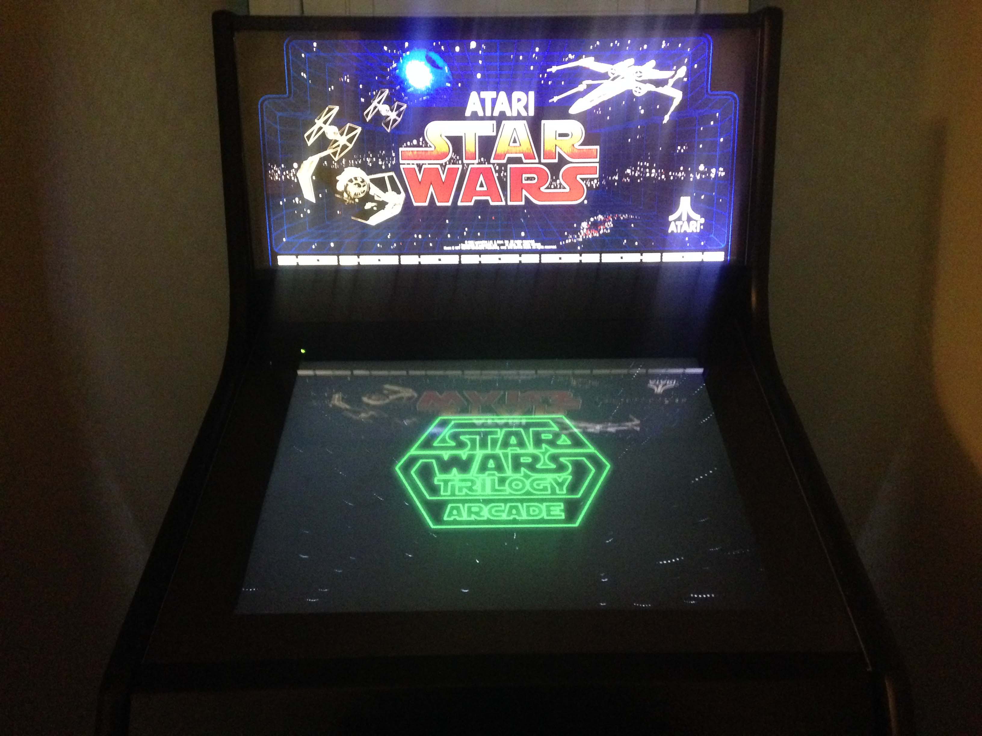

Close-up of the marquee and FE.  Still running Attract-mode FE, works a charm.  The marquee is gorgeous, pictures don't do it justice.  STPCORE did it for me, those of you who have his translites know the quality.  This thing is tits, and he included an additional transfusing sheet that really give it a nice even glow. Someday I may get froggy and go mask off the black boarder but I'm pretty happy the way it is.  If you're wondering, why yes that is the back glass art for the SW cockpit - have I mentioned that's where I fondled my first tiddy?  Good times.

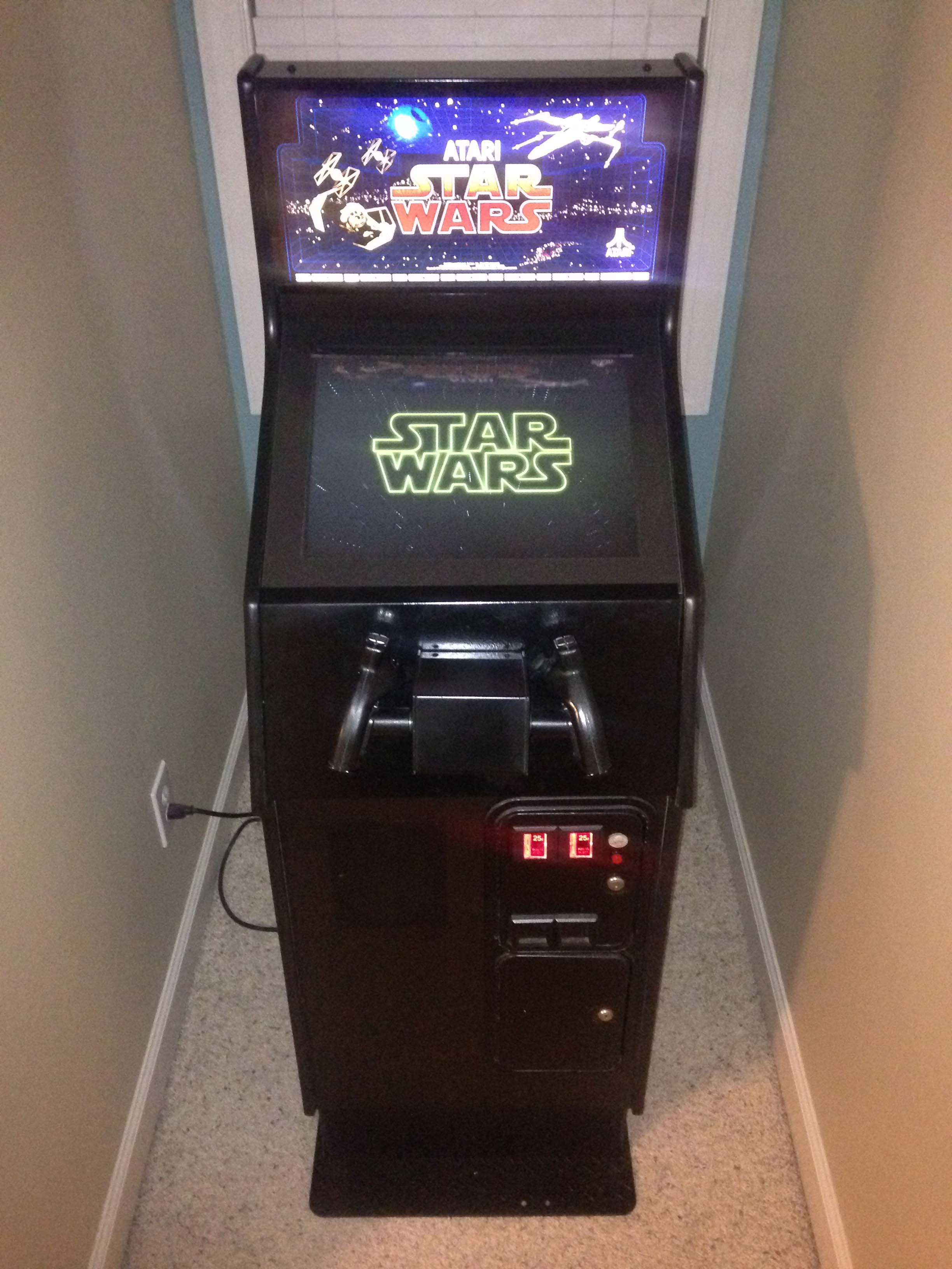

Cab off.  Monitor got dropped in today, big improvement.  Would like to further upgrade to a 19" CRT, VGA or otherwise, but that'll require a kick out space on the back and I'm not hating what I have right now.  It's noice.  Lessee, coindoor has an Easy CoinUp wired up, which I love.  It's wired to both coinup and P1 start.  Does everything I need with a few presses.  A 12mm button is below that to get you back to the FE.

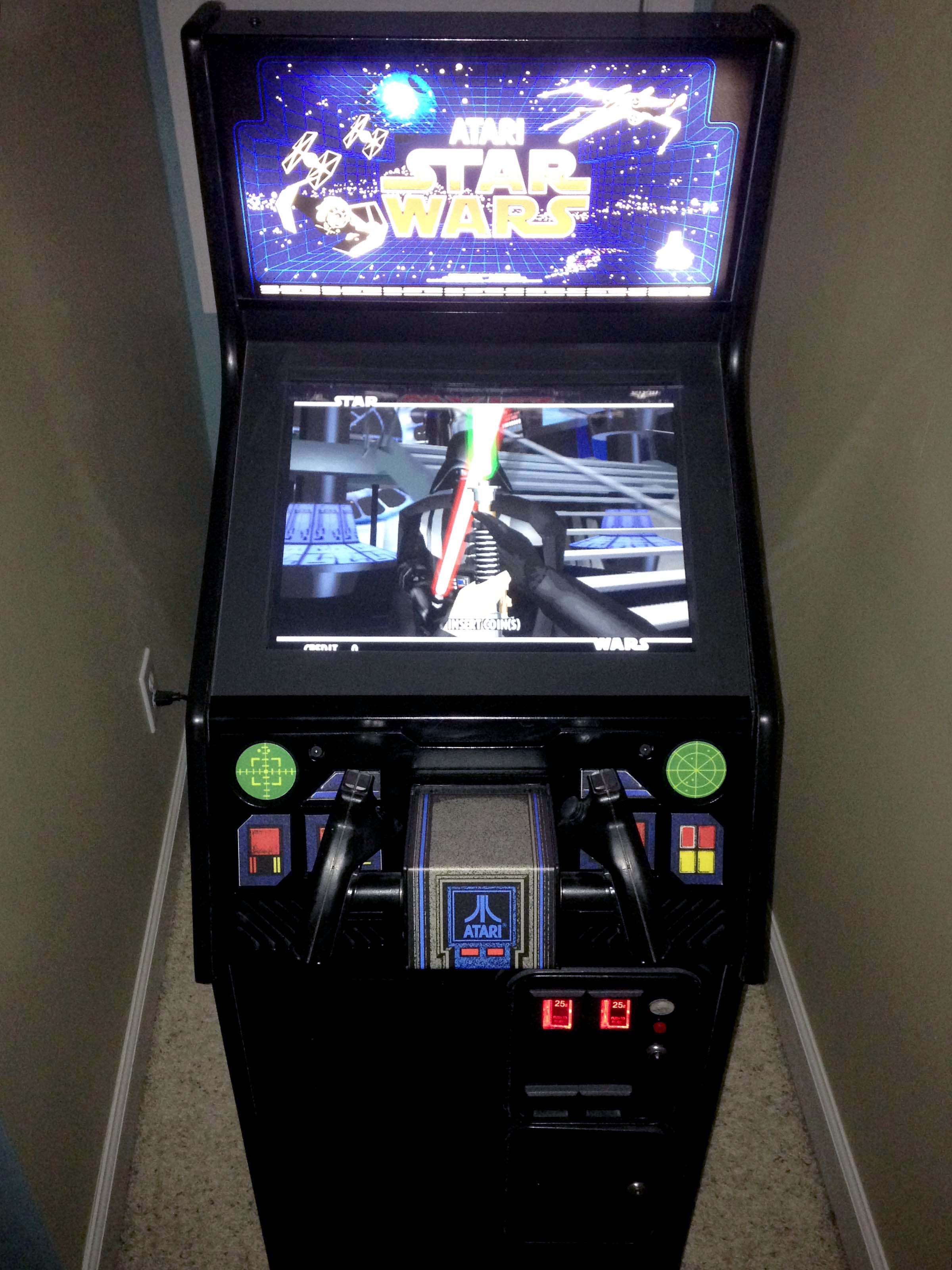

Art - looking at doing the ROTJ CPO art for my CPO.  Also looking at doing some gray vinyl fighter decals along the bottom front.   For the sides I've been playing with the cockpit style art, but haven't really devoted any time to making that happen.  They might just stay black.  Not a lot of room on the bezel so probably nothing there, maybe some Imperial window patterns in two lines down the sides in dark gray.  Nothing crazy. Torn on which yoke overlay to use.  I prefer the SW overlay but think the ROTJ overlay looks better if I'm using the ROTJ CPO stuff.  Maybe I can tweak the SW CPO, don't want to fully skin the panel tho, just a few touches so that's why I'm leaning ROTJ.  Maybe chrome decals.  I dunno, might go crazy.
Somebody please help me not ruin this thing in the home stretch.  I really like this cab, want to finish her off right.  Let's talk the art.  Thanks for looking!

That is a nice focused build. Really clean.

Yoke is connected via a KADE board, game list is up a few posts in the reply to RetroGreg if anyone missed it.  It's short.  Everything works great.  Hydro Thunder is the PC port so it's great (not arcade beautiful) but arcade playable and looks pretty damn good as it is once you turn on all the fancy-schmancy stuff in the gui, if you haven't played it you should definitely look it up.  It's a standalone and not too difficult to find.  FE post is here, I had been using Arximidis FE and trying to get a nice spacey feel and finally switched over the attractmode with the Warp layout.  It's cool because the starfield moves in every direction you move the yoke.  The games just rotate left/right across the screen in carousel.  You could set up multiple emulators to cycle through by going down/up but since I run such a condensed list I'm just batch loading everything from a single folder.  Easier on guests too.  The only games that take explanation are Trilogy and Mario Kart because both of those you have to wait until you're past the initial load screen to coin up or they get angry.  Everything else just works.
I have a few positional gun games in the mix, they are just a different format of an on-rails shooter so they work great.  I've tried a few of the lightgun games but most don't feel right on the yoke.  Jurassic and T2 are just there for my boys, they love it and don't know any better about the control lol.  The others actually feel pretty natural on the yoke, especially Gundam.  The only game I had to do special control mapping (aside from adjusting the analog sensitivity or flipping the Y axis depending on game) was Cybersled.  I have to press a button and steer to turn, otherwise I just strafe.  Took all of 5 minutes to get used to it and now I can run the board with about any of the sleds, but I favor the slower, harder hitters.  Most of the games I tried to keep in the space fighter theme, both because that's what I like and also just for aesthetics - but there's a lot on the list that is just too fun not to have.  Mario Kart and Hydro Thunder get played literally every time the machine is on.  Not so for some of the others.

Man, this is all kinds of awesome.  It would of been cool if you could have incorporated some of the three dimensional bezel relief of the original upright.  Can't wait to see iit finished....Im really jealous.  Looks awesome, awesome game as well.
I love that marquee.  Did you light the Death Star individually? Looks cool!

About the FE
The short and sweet - Attract-Mode FE might be the easiest implementation of the "SW FE" out of the box.
So if you want to try this go download Attract-Mode from: http://attractmode.org/download.html
Then download the Warp layout (read skin for you older FE'rs) from: https://github.com/mickelson/attract-extra (click dl zip in the lower right)
Then open that zip and copy the Warp folder out of layouts and drop it in the layouts folder in the freshest Attract-Mode FE you just downloaded.
If you want any sounds drop them into the "sounds" folder - you'll assign them in the FE tab menu.
Open the FE and hit tab.  Set the display as Warp and point the emulators at the snaps and files you want to run.  Set sounds.  Set the controls (Attract-Mode read my kade+ out of the box) and you're done.  Stupid simple.  I have all my stuff running from a folder full of batch files and only the "windows programs" emulator setup since it looks for *.bat or *.lnk. Just about 5 minutes worth of fiddling and I was done.

Art decisions have been made.  Going to use the SW yoke overlay and am compositing art from the SW CPO to fill in a "ROTJ style" shell that I'll be laying over the control panel to give it some depth.  The image below includes the black shell but that part will be 1/4" material and beveled.  Painted to match the hammered black CP.  Not shown are the venting cutaways at the bottom that you an see in the vector paths below the color render.  Art will be texture printed to match the yoke overlay.  Looking to finalize this shortly but wanted to throw it up for feeback...so thoughts?
I'm pretty happy with the shell cutout, I did templating in giant graph paper so I could lay in out on the yoke.  Already sent it off for milling.  Hopefully it comes out okay!  Once it does I'll verify decals, do test print for sizes, and then send them off for production.
Definitely impressive.   :applaud:   :notworthy:
My one small disagreement with the panel design is the Death Star display.
The Radar Warning Receiver display in the upper right looks like it belongs in a cockpit, because that's real-time threat information that a pilot would need.
It seems that something like the round shield/battle-damage display in these screencaps would be simlarly important information for the pilot.   ;D
Re: Star Wars Cabaret
« Reply #25 on: January 14, 2017, 11:46:07 pm »
While it's not an x-wing showing shield status it does perhaps go with the other tracking graphic a bit better.  Also from the original SW, along with the rest of the art, so it's in keeping with the arc I'm going for.  Minor difference I suppose.  For anyone wondering what the hell I'm talking about because the two are identical, it's the top left circle that is in question.
Also tried some other inserts, more red, different buttons, etc.  Nothing stuck out as better, so I'm keeping what I got for now - unless there are better ideas out there.
  • Posts: 9743
  • Last login:Today at 12:16:07 pm
« Reply #26 on: January 15, 2017, 01:25:33 am »
Looking good.   ;D
Have you considered removing the grid so it's a bit less busy?
EDIT: Just noticed that the targeting display (left display) looks like there are two targets to the left, but the Radar Warning Receiver display (right display) shows  one target forward-right.
If you flip the targeting display and remove one of the target blips, the displays will agree. [/OCD]
« Last Edit: January 15, 2017, 02:16:44 am by PL1 »

My panel came in today.  Really happy with how it turned out, now I just need to get it all primed, painted and mounted.
Got the yoke off the CP and made sure the panel came out the way I wanted.  It did.
Made a spacer for the yoke so the handles won't smack into the panel and did a lot of fiddling and dry fitting to figure out where I wanted everything to sit.
Now I get to prep prep prep to get it ready for some hammered black to match the CP.  Shown is first layer of primer, just applied a nice coat of a high-build primer that I'll let cure over night and start working it back in the morning.  Should be able to knock this out tomorrow if things go well.  Will need to head to the big box to pick up some mounting hardware and some longer yoke base screws.
Now I just need to test print the art and we'll be off to the races.
As for the cab, I'm still running tinyXP.  It's definetly time for a change.  Next weekend I might take a day and flip it over to W7 64 and get some games working that I haven't been able to because I'm using an ancient build (Howard's Offroad Thunder comes to mind).

Need to special order some security torx bolts to class up the look but got it together.  Light in the room is crap so pics aren't stellar but once I get the art done I'll pull out the 5D M2 and do some glamour shots.
I'm really liking this, but those phillips head screws aren't doing it any favors.  Will feel much better once they get flipped out, but hey, progress is progress
Again, the light is poop, but IRL this feels much more like a production model.  Really looking forward to getting some art on it.
