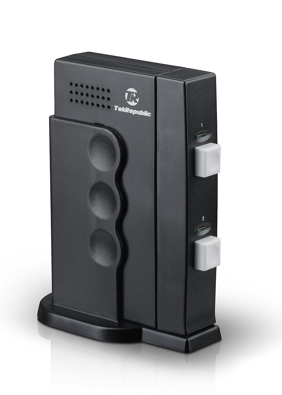

      Another option might be to use the dual core for older Mame racing games and the PS3 on different inputs. So would it be possible to not to physically remove the USB device from one machine to the other Like a USB selector or a USB splitter? Like this:
http://www.amazon.com/Tek-Republic-TUS-200-Sharing-Switch/dp/B00FEM3OKM/ref=sr_1_3?ie=UTF8&qid=1423798464&sr=8-3&keywords=usb+switcher The best of both with a console and computer.

The issue with usb switches is u need one that cuts the power when you switch inputs, this allows the wheel to reset. My guess is that most do this but, I didnt feel like spending $15 on a switch that would not work so I went the old school way and used usb extension cable and I just lift my CP and plug my wheel into whatever I want. It takes 5 seconds but, that may not be an option for you if you Control panel does lift up easily.

A lot of software expects the USB game controller to be plugged in BEFORE you start the software.  Something to consider when using a switch like this.
I used one in the past and sometimes the hand shaking process would fail.  Basically leaving me to reboot the PC to get it working correctly again.  When it worked it was awesome, but sometimes a pain.
