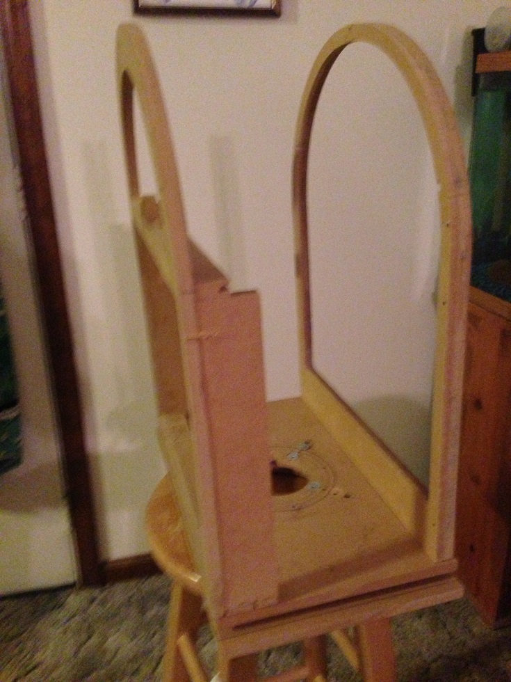

Here is the front and back frames, sitting on the bottom plate.
Sorry about the quality of some of these pics, looks like I lost some clarity when I resized them.
Here is same pose, different angle:
Notice the blocks I added to the sides of the front? These are to mount the monitor I mentioned earlier. More on this later, with hopefully some better pics of the monitor.

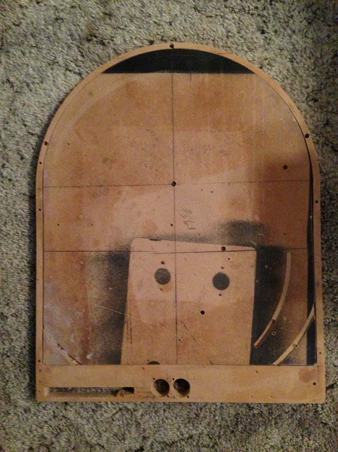

I plan to have a removable back. I need to back up for a minute. This juke box is made from 1/2" MDF (well, the internal frame, bottom and speaker box will be.)
I glued some 1/4" MDF to the inside of the back piece, then routed it out to form a lip.
I then cut the back out of 1/2" MDF. The back will fit against this lip and hopefully will be flush with the outside of the back frame.
I ran out of 1/2" MDF, but I had some scrap pieces left. Hopefully it will be enough to make the speaker box, but I didn't have any pieces big enough for the back, except one piece I had been using as a table.
So I did what any BYOACer would do, I used the makeshift table.
This piece has holes bored in it, a couple of router slots, and even some spray paint overspray (anyone recognize the Little Rage coin door image?)
I plan to cover this with laminate and I still got to cut out for air holes, so I plan to sand it down and slap some laminate on it. Just hope the paint doesn't affect the laminate glue.
Ok here is the back, test fitted in the back frame.

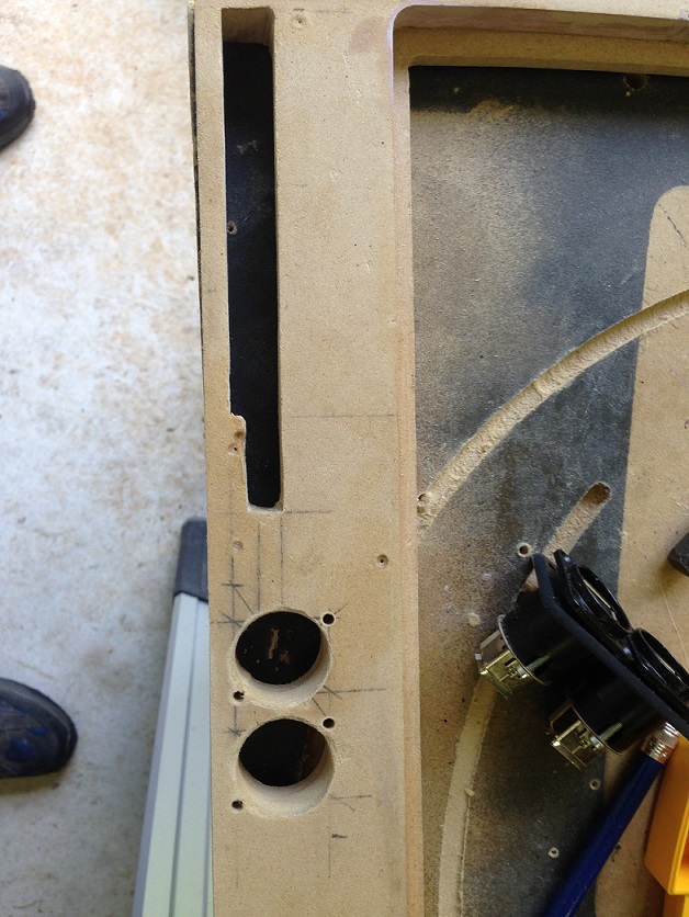

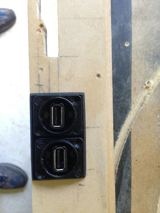

I didn't do anything today, got a sore throat and felt like crap (pretty sure it's allergies).
Last night I did get the area for the USB plugs routed, so that I can recess them.
I got a little wild on the left side and had to use a little bondo.
Here is the routed -out recess:
Here is the test fit. I like this a lot more, but note that the plastic trim piece I made needs to be cleaned up and polished.
