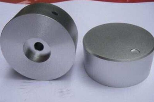

Now I have got to concentrate on the volume control knob, I may need the room to work on it so Im holding off for a bit on gluing the skin down.
Does anyone have a bad griffen powermate they want to get rid of real cheap?
All I need is the knob. I couldn't get the one I had to work consistently on Brendas Jukebox, so I just used the knob and a pot. The knob on the powermate is perfect for this design, but Im having a hard time finding one like it.
Thanks for looking and stay tuned.

Thanks radblack, that is very similar to what I need, similar enough to work perfectly!

Go to ebay and type this into search - aluminum volume knob
All sizes come up, so you have a good choice, and prices+shipping are reasonable.

Hey thanks man, I appreciate it. I am liking the second one you posted. I am a little scared of it shipping from Hong Kong, because of the time it will take, but I may go ahead and bite the bullet.
If I go with this one, I can go ahead and do the mounting method, because I will know the size the knob will be.
This forum is a great resource. I know I would be out in the weeds without it.

Narrow the search to U.S. only, another may pop up in the states although price may be higher.
Yeah, I would order now, November and December is when HK starts having all their holidays and shut down for weeks at a time.
I do it all the time, takes about 21 days on the norm, however, I order from this one vendor, and his stuff take like a week and a half, I have no idea how, but its fast.
Good luck and hope i helped you move forward on this work of art.  :cheers:

I bought a pair of those aluminum knobs on eBay for less than $10 shipped each time from China. Only took like two weeks.

Ok, I ordered the 2nd knob that rablack97 posted. I couldn't find any here in the states, so I had to go the Hong Kong route. Supposed to be here in 7-14 days. But we will see.

I did manage to put together my volume knob configuration.
I don't have any luck with the griffen powermate. Try as I may, it's just not reliable booting every time.
So I am going to use the ole reliable 50K ohm stereo audio pot again.
I found a piece of acrylic rod. Cut it down with my router circle cutter to fit the volume hole in the front of the juke.
I actually cut it too much and had to use some shiny duct tape to build it back up. It needs to fit snug in the hole so the pot knob will be properly aligned with the juke front.
I then cut a round piece out of one of those acrylic "neon" clip boards (blue).
I then glued the round piece to the acrylic rod.
There is a hole in the center for the pot.
I then drilled a hole into the back of the rod, one on each side of the pot, and inserted two blue leds.
The blue ring is the same diameter as the knob, maybe a MM or two bigger.
It forms a nice ring around the knob. (Please get minds out of gutter. LOL)
Here is a pic of it being tested:
And here it is test fitted into the hole: (Minds, gutters!)
Sorry about the quality of the pics, but maybe you get the idea what im trying to do here.
Thanks for looking.
