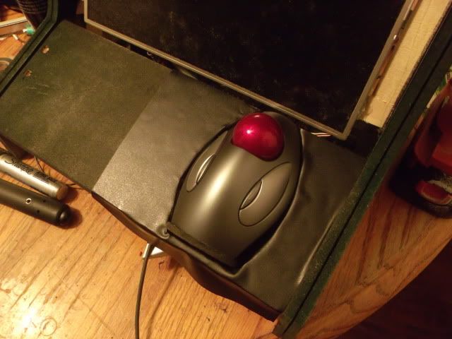

Interesting stuff. That trackball looks like it's 'riding high' (i.e. isn't enclosed in the casing) . Could you hack / remodel it to integrate into the control panel so it's more of a traditional arcade type trackball? Must admit, I was only thinking about something like this the other day.
Good luck with the project  :cheers:

Thanks, I think it will work out. I had an idea for a hacked trackball mouse to use on mame, kind of a mini arcade trackball for a regular bartop build. Would love to play some trackball games on one of these things.
For this build though I will keep the case because I don't want it to lose the feel of a mouse, and being able to easily left, right click about like a mad man.

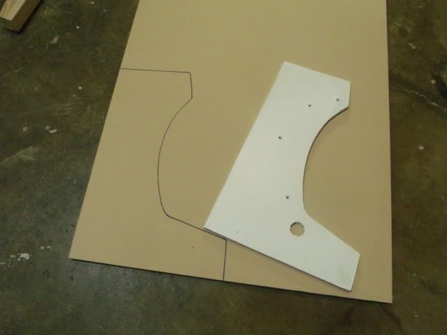

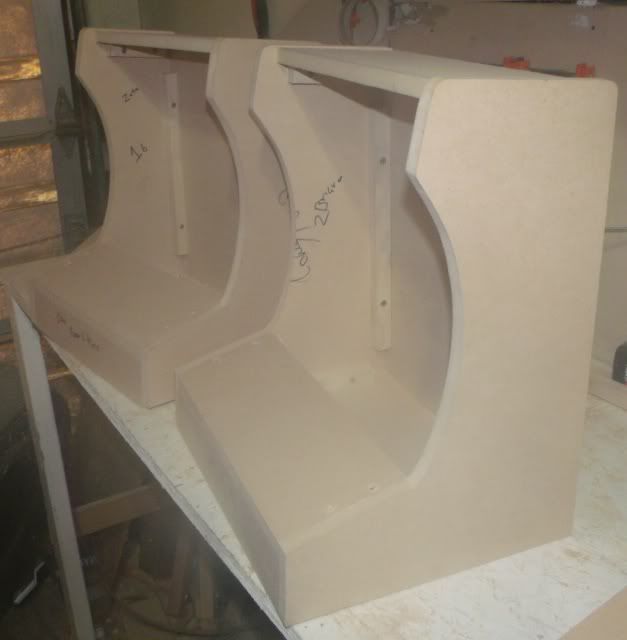

Throwing in some shots from the other thread of this build to keep it flowing

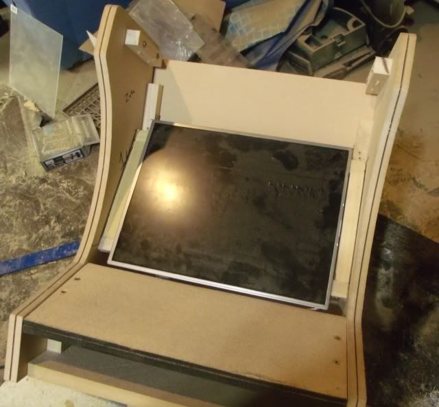

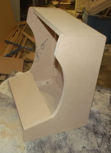

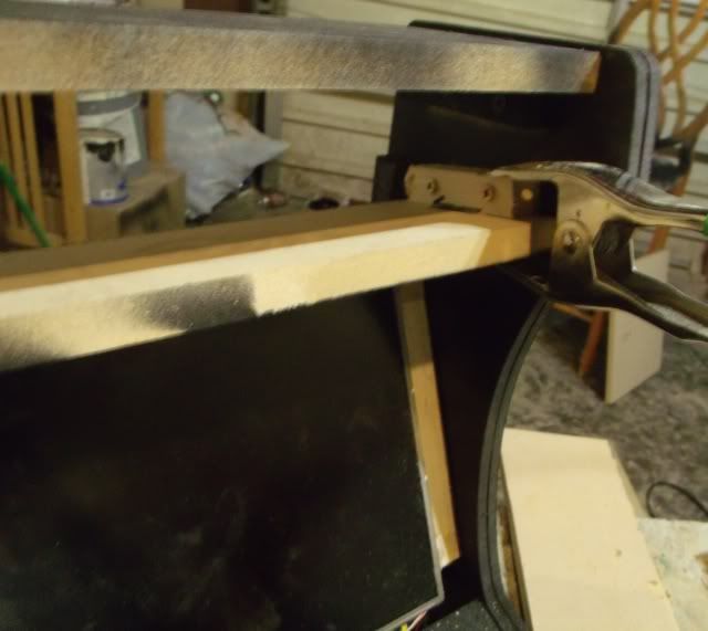

« Reply #4 on: December 02, 2012, 05:06:37 pm »

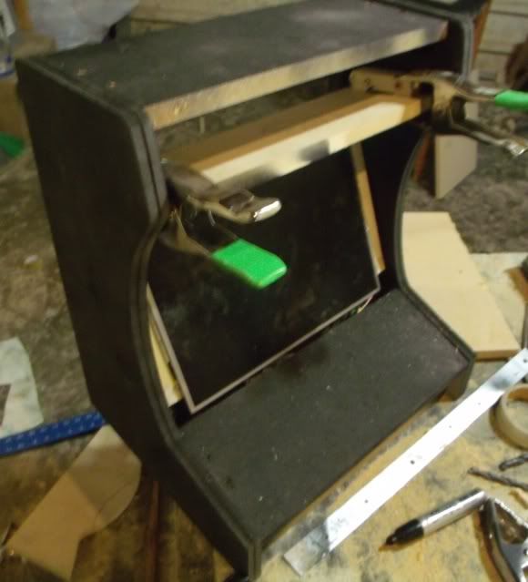

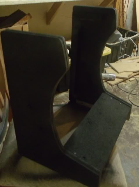

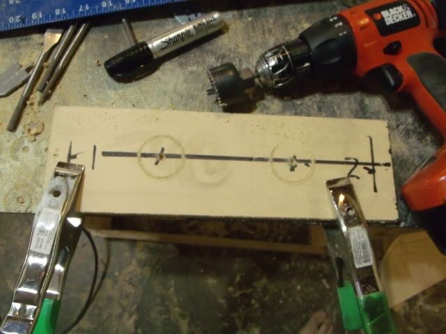

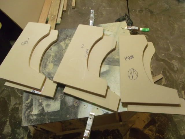

Since I am lacking in space to do some woodworking (garage leaking), been playing around with what will be the serial plates for these bartops. Here is what I have come up with for this build.
Like I said, I have a ton of aluminum to work with and am just waiting on my full sheet of "clear avery stickers" to come in. Will print them all out at once to not waste a sheet.

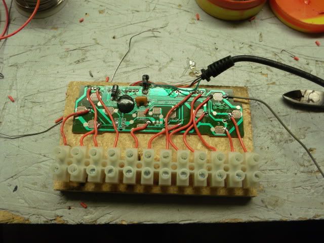

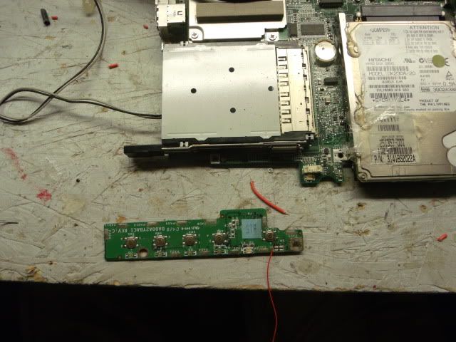

Hacked Gamepad
Edit: Just realized I didn't have to solder to that many points as this build is only going to have 5 buttons all together

 I don't know about using that Logitech Marble Mouse. Do you already have it in hand? I've used those for a long time and the ball is not at all stable in the socket. One even light pull with the fingertips will remove it from the socket. Don't get me wrong, the thing works well, but that particular issue has always made it feel "cheap" to me.
Meanwhile, Paradise Arcade Shop carries a PS/2 mini trackball with LED lighting for the same price as a Marble Mouse at retail. Just a thought!  :cheers:

Well I ordered it already, so we will see how it plays out. I will do a bunch of testing first.
If it fails hard then I will take it back and go a different route. I want to not have to have extra buttons for left and right clicking.

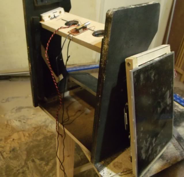

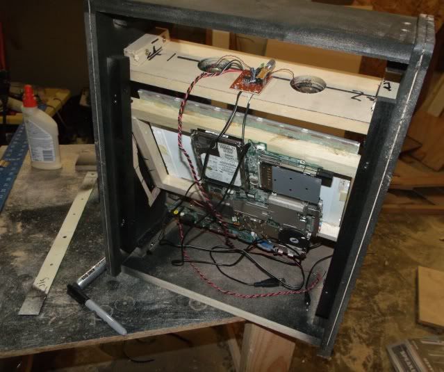

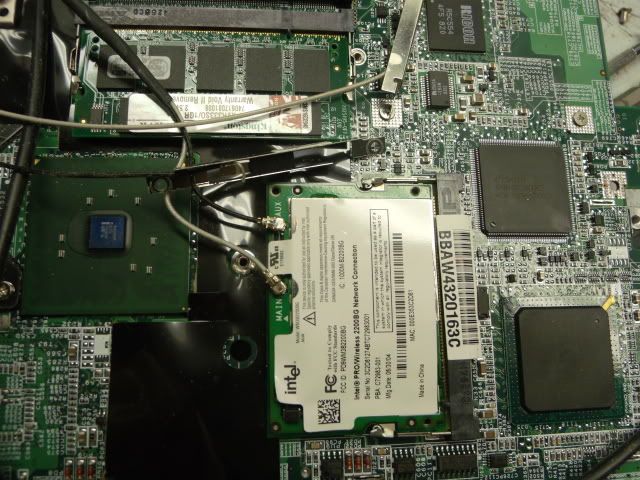

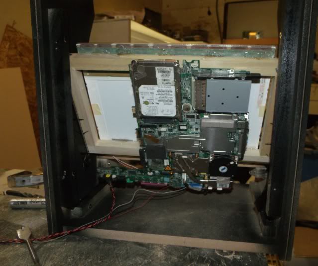

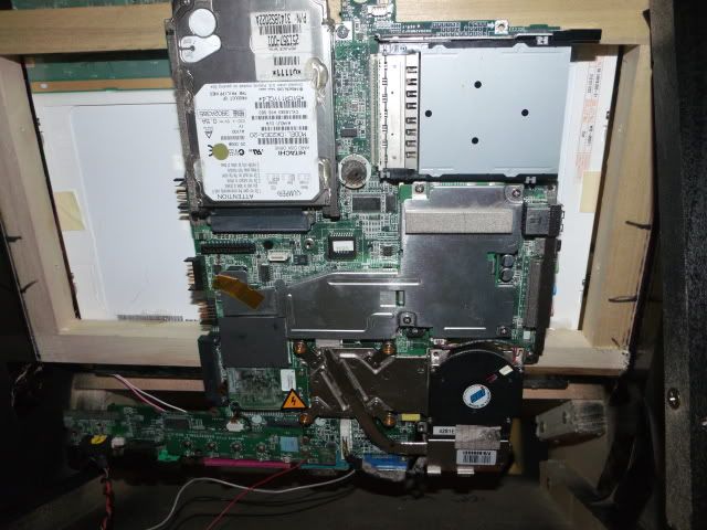

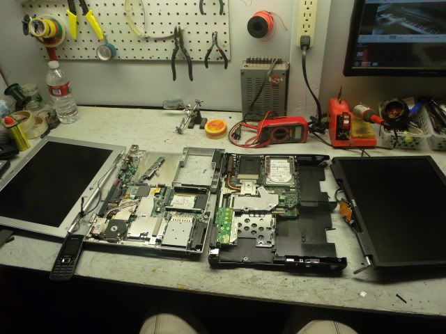

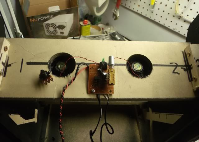

Mounting the laptop to the frame and to the shell of the bartop
Quick spray while I work on other projects
After getting the laptop mounted perfectly I fit the speaker panel
Speaker holes

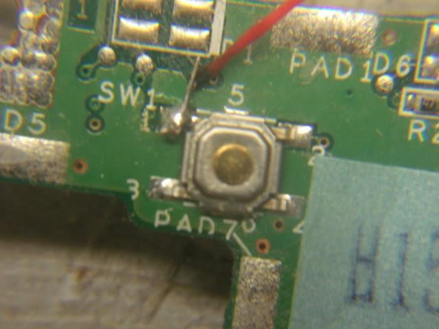

Soldering to the power button

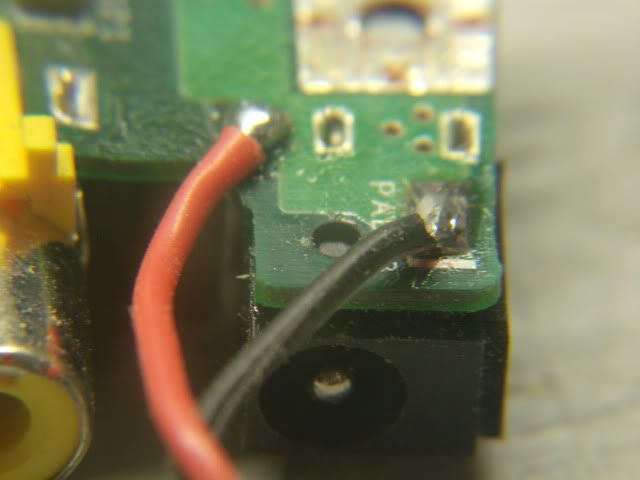

To complete the circuit I just wire one side of the push-button on the back panel to the DC Jack's ground
Soldering onto to the DC jack to extend it to the back panel jack
Shot of the wireless card
A look inside -
Grey & Black wires = Wireless antenna
Red & Black wires  = DC Power
22 gauge red wire = Power switch wire
Apparently the trackball is out of stock, even though they marked it as shipped 4 days ago  :banghead: Ordered another one

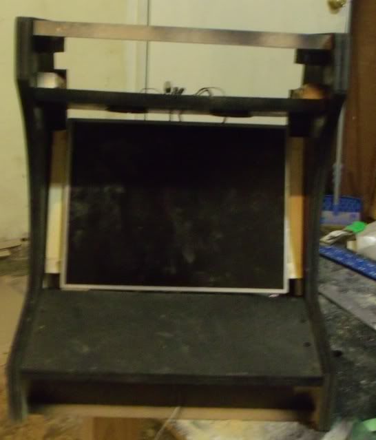

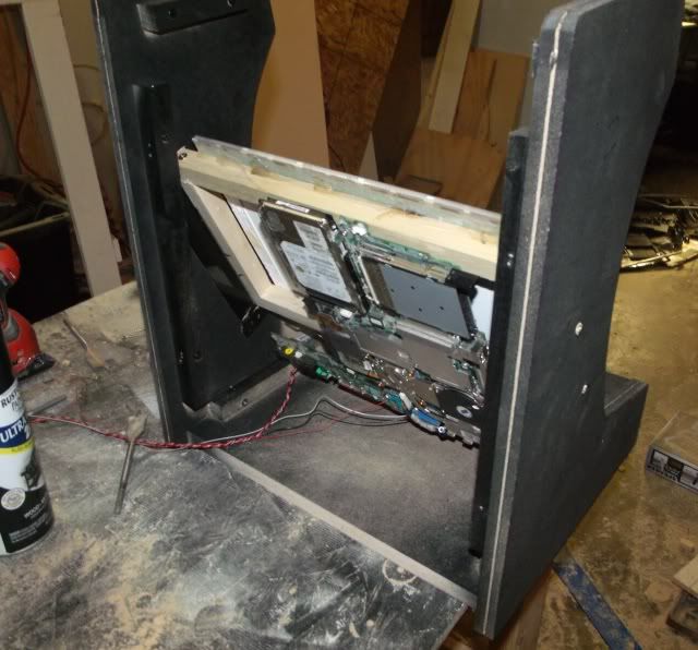

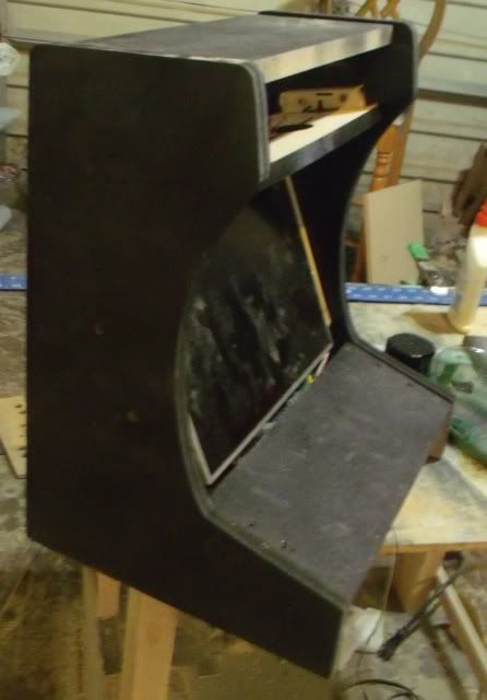

Audio panel painted and amp installed - I remove the audio potentiometer (rheostat) to be repositioned on the back panel
Re-mouted the laptop and filled in the holes
Next up is to tidy the wires a bit, sand and paint\apply vinyl, get art printed and await the trackball mouse.

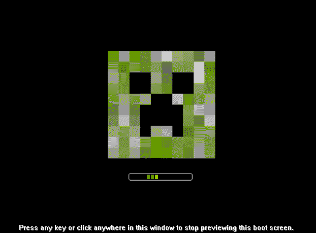

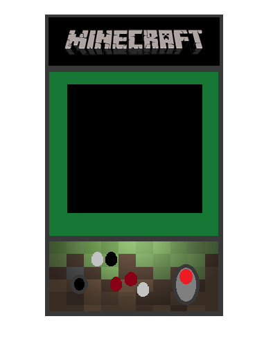

Art
Marquee
Control Panel
Boot Logo
CoryBee

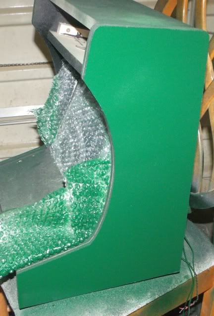

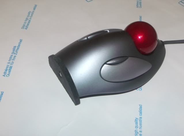

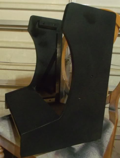

« Reply #17 on: December 11, 2012, 09:51:05 pm »
Painting the sides a darkish green

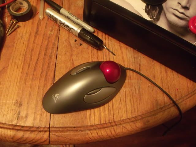

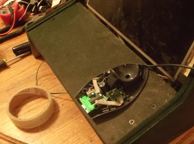

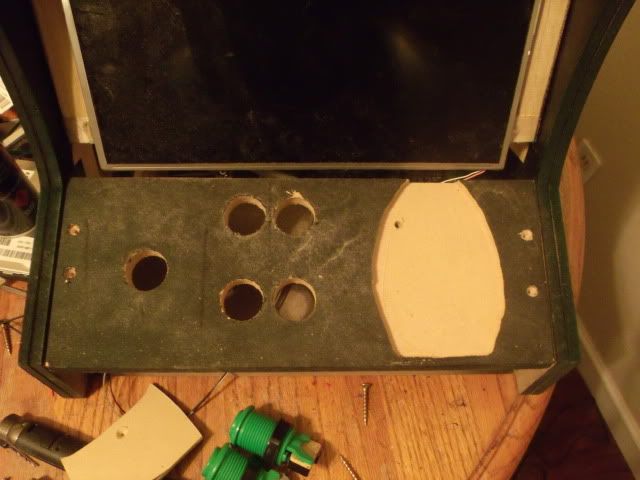

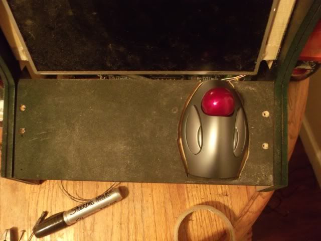

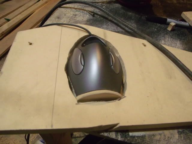

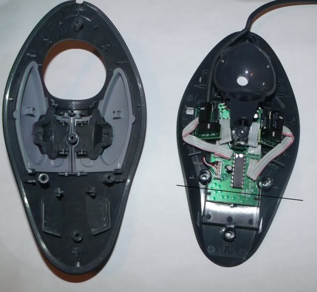

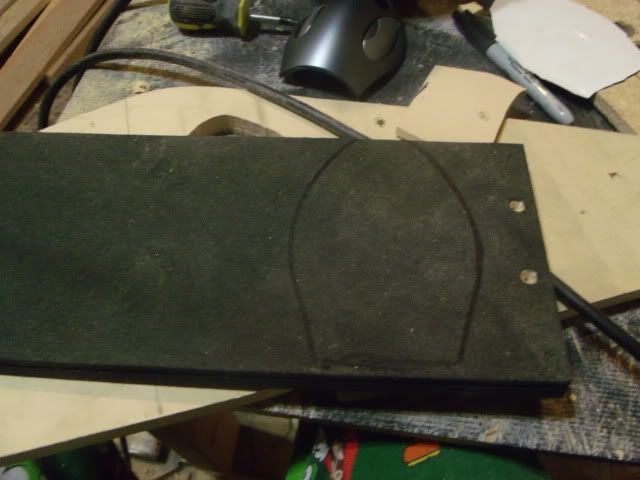

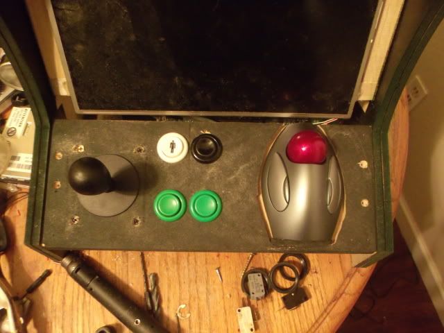

So my trackball came in and the thing is longer than I thought...... :banghead:
It would hang over the edge by a little over a half an inch. The only way I see to rectify this would be to cut the "tail" off of the end and rout a recess (I was already going to but this would go at an angle) to hide the missing piece of the trackball. Short of hacking up the assembly out of it's case, that is the best I got.  :dunno

« Reply #18 on: December 11, 2012, 11:50:31 pm »
Any ideas on the trackball issue?
  • Posts: 9743
  • Last login:Today at 04:37:06 pm
Re: Minecraft Bartop
« Reply #19 on: December 12, 2012, 04:25:36 am »
Is cutting the CP 1/2" - 3/4" deeper and letting the extra hang over the near edge an option?
Might be easier than cutting down and angle-mounting the trackball.
Option #2 a bulge under the trackball like the top of the side panels above Ms. Pac-Man on Griffindodd's Tabletop Cocktail Cab.
CoryBee
  • Posts: 2093
  • Bopity Boopy
« Reply #20 on: December 12, 2012, 05:09:04 am »
I am not sure what you mean on either of these options....granted it is late so I am tired
cut a longer cp?
  • Posts: 9743
« Reply #21 on: December 12, 2012, 06:23:08 am »
Diagram #1 - Current CP.  Trackball base is too long and hangs over the near edge.
Diagram #2 - Cut a larger CP, additional area shown in light blue.
Diagram #3 - Cut a CP with a bulge, additional area shown in light blue.

CoryBee
  • Posts: 2093
  • Bopity Boopy
« Reply #23 on: December 12, 2012, 06:49:10 am »
This is why I love you scotty, going the extra mile!  :applaud:
Bahh! Number 3 looks like the hardest to implement and make look decent....
Cutting a larger control panel is an option....but then there will be a small space where the tmolding wont be...unless I curve it or something
I am thinking cutting the tail off this thing (if possible without damaging the circuit board) is the best option
Thanks for the help, if you have any more ideas let me know.
Did you already cut the t-molding to length?
If so, use it on your next build -- which should start in 2 days given your build rate.   :laugh2:
Cutting the tail off creates two challenges:
1. Getting the chopped tail smooth and comfortable
2. Routing the CP to mount the trackball
Instead of chopping the tail, you could mount the trackball using screws through the trackball base. (green)
Snug nuts/lockwashers (red) to the bottom and put the base back on the trackball.
Drill through the CP (yellow) and countersink.  Attach nuts (blue) to hold the trackball down.
You can leave the tail hanging over the edge if you want to use your current CP or you can cut a new one.

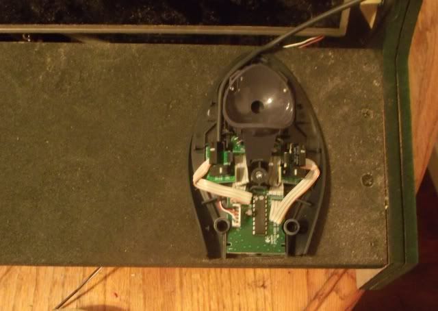

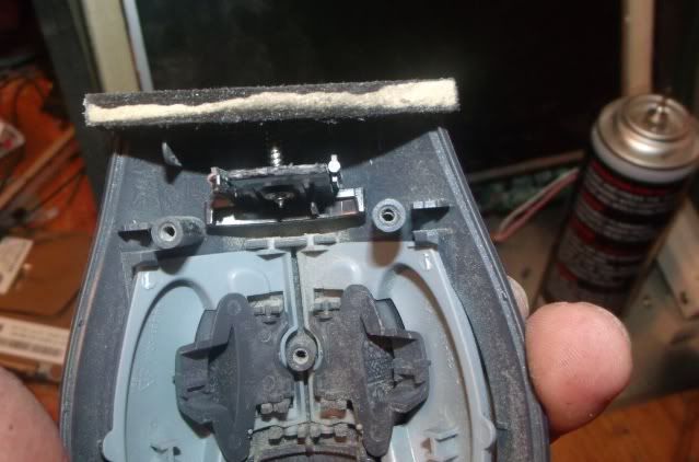

« Reply #25 on: December 12, 2012, 06:39:47 pm »
Take it apart before you make a decision.  A lot of that plastic could just be a palm rest and you might be able to just integrate the guts and the side buttons right onto the CP.  That could also help prevent that ball from just rolling off that mouse which it is somewhat prone to do.
CoryBee
  • Posts: 2093
  • Bopity Boopy
« Reply #26 on: December 12, 2012, 08:07:17 pm »

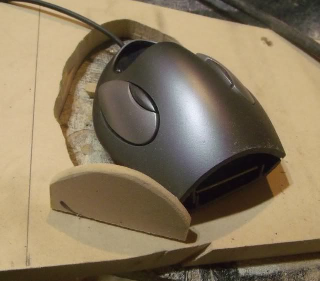

The ball seems to be held pretty securely by three prongy things that it clicks into. I have shook it and hit it all to hell to test this out and it didn't fall out  :dunno
If I was to cut off the tail I was going to recess the mouse at an angle a bit to hide it.
Hmmm, I am going to take it apart before I do anymore pondering. Thanks guys!

« Reply #28 on: December 12, 2012, 11:47:45 pm »
My younger brother can't stop playing this darn game  :laugh:
Thanks for the kind compliments, I think I have come far in the past 7 or so months when all I had was a jigsaw and particle board.  :applaud:
On a side note, have been messing about with the trackball mouse and it is surprisingly easier to use than my standard mouse for gaming. Haven't tried it on BF3 yet but that would be a learning curve indeed.
CoryBee
  • Posts: 2093
  • Bopity Boopy
« Reply #29 on: December 13, 2012, 05:42:30 am »
So I opened up the Trackball Mouse and we were right that the tail is pretty much empty. Everything after the black line is redundant space, on the circuit board it is empty "ground" space.
So I think I am going with option 1, cutting the tail off and making a recess for it in the control panel  :applaud:
CoryBee
  • Posts: 2093
  • Bopity Boopy
« Reply #30 on: December 13, 2012, 10:36:02 am »
Update:
Spent a lot of time pondering what to do with it after cutting the tail off.  :dizzy:
Tried routing in steps but that was fruitless to hide the cut
Decided to make an end cap
Fits - drilled a hole in the bottom of the trackball to thread the cord through another hole in the CP
The art is changing slightly - Left side will be the same but on the right will be a black laminate (it will look better than this, was just getting an idea for it)
CP
The trackball is surprisingly comfortable to use at this angle, won't be doing any "superman" ball spinning techniques on this thing  :laugh2:

What if you finished cutting out that recess all the way through the wood and then go crazy with the bondo.  Make it into one continuos piece.  I'm thinking you could get get something to tack it into place like clay or hot glue.  Then pop out the guts from the bottom.  Next, fill in the gaps with some bondo.  Sand it down like crazy and repeat until you have a nice smooth finish.  Tape up the buttons and spray paint the entire thing.  Then take the tape off and lightly spray the trackball to match in color to everything else.  It would be a lot more work but the end result would be pretty seemless.

Or you could have just used a real 2.25" arcade trackball.  :dunno
CoryBee
  • Posts: 2093
  • Bopity Boopy
« Reply #35 on: December 13, 2012, 05:52:51 pm »
Wanted to keep the buttons on the trackball. If I ever do it again I would, and use the little arcade buttons next to it for left\right clicking.
Jammin0 -
I have never used bondo, thought about something like this though. If it looks like ---steaming pile of meadow muffin--- when I am done I probably will go this route
I second this opinion.... real hardware would look less "crap-mame" worthy!
CoryBee
  • Posts: 2093
  • Bopity Boopy
« Reply #37 on: December 13, 2012, 06:23:16 pm »
Relax, if it looks complete shite  then I will order one of these Link
