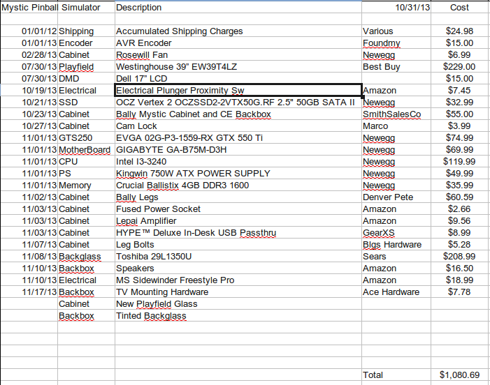

Components (incomplete list to be updated over time): Last Update 8/23/12
06/25/12   Cabinet             Solar Ride by Gottlieb           Duncan   $60.00
07/10/12   Legs                                                              Ebay          $25.88
07/17/12   Playfield             Westinghouse EW39T4LZ   Ebay                  $269.00
07/17/12   Video Card          GTS250 PNY VCGGTS2501XPB    Ebay         $45.00
07/20/12   Backglass             Hanspree Basketball          TigerDirect           $159.99
10/10/11   MotherBoard     Zotac GF9300-K-E                    Amazon   $118.48 (I had this from before I decided to start the project)
12/07/11   CPU                     Intel (BX80571E3400)             Ebay           $46.99 (this will be replaced with an E8500 shortly)
12/07/11   Memory             4GB Corsair DDR3 1333Mhz   Ebay      $15.00
10/25/11   Case                     BROADWAY 1243MA-BLACK R   newegg   $29.99 (includes 500Watt power Supply - case will be severely modified)
07/22/12   SSD                     OCZ 64GB Vertex 4                   Amazon   $69.99
                                IPAC2   Ultimarc
8/2/12                            AVR Encoder                             Degenetron $24.94
                                Intel E8500 Processoror better LGA755 format processor
                                          3rd Monitor
8/22/12     Backbox              Backglass Glass                Local                 $13.00
07/27/12   Misc                     Chisel and Glue           Harbor Freight   $10.98
07/29/12   Misc                         Speaker Hardware   Ace Hardware   $0.90
07/27/12   Misc                         Backbox Bolts          Ace Hardware   $6.16
07/27/12   Speakers                 Logitech                   Target           $19.94
07/28/12   Misc                         Wood and hardware   Lowe's          $21.54
07/30/12   Nudge (x3)            Mercury Tilt Switches   ebay                  $16.22
07/31/12   Misc                         Paint and Door Hook   Ace Hardware   $7.24
03/15/12   Electrical                     Belking Smart Strip   Target           $14.67
07/31/12   Electrical                  Fuses and Buttons   Radio Shack   $7.18
06/25/12   Electrical                Fused Power Socket   Amazon           $7.58
08/13/12   Backbox                  Fish Tank Hinge             Ebay                $7.95
08/13/12   Backbox                   Speaker Grills               Ebay                $6.88
                Backbox                   Backbox Door Wood       Leftover           Free
8/22/12    Backbox                   Cam Lock/hdwr         Ace Hardware       $9.00
GRAND TOTAL - ---------------------------------------------------------------$1020.15
« Last Edit: November 08, 2012, 11:01:45 am by MTPPC »

I dove into my 4th pincab project today. Project Mystical Close Encounters. Here's the parts list and a teaser photo:
