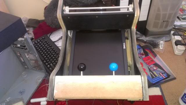

I do have one issue though, as seen in the pic below. I forgot about this... and it was a problem with my Star Wars project earlier. When using the slider controls in the TAB menu of Mame the screen cuts off when lowering the image in portrait mode. You can see the game image has cut away at the bottom but yet there's plenty of screen to go. Why does this happen? Does anyone have a solution?
On the previous project when I had this issue I was able to reposition the monitor. But this time I'm not gonna be able to do that. Or I could, but it would spoil the way the cab has been designed thus far. I'm gonna start Googling for a possible solution to this. It might be something really simple (I hope!).  :dunno

As for my earlier problem with the screen cutting off... I did find a solution. And that was to open up the NVidia control panel and move the desktop down as far as it would go. This cuts off the taskbar and loses about an inch of the desktop in total. But when Robotron starts the image is now low enough to not be a problem. It's quite central now and when it comes to fine adjustments with the bezel artwork in place I foresee no problems.

Here is the control panel now finished off. Forgive the odd coloured ball tops, they will be changed to the correct red ones soon. The panel here is locked down using the correct sized allen key which I cut down using a grinder. It fits in the locking tab underneath nicely and holds the panel tightly closed under play conditions. I also got the T-molding slot out out as well.

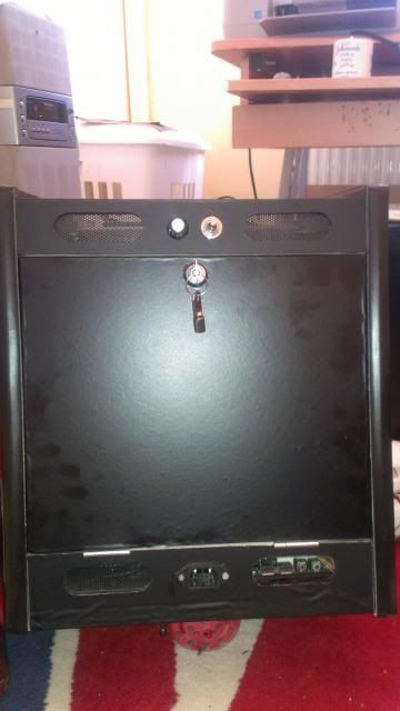

The back door is now finished along with a proper arcade lock fitted. I went for as close a detail as possible for the back of the cabinet (even though you don't really see it). Anyone who's seen the rear of a real Robotron may well recognise the oval cutouts with the gauze mesh in there. There is also a large toggle switch on the original which I think switches on/off the marquee light. Here it's the power switch on a momentary toggle which resets back to rest. Alongside is the volume control.
