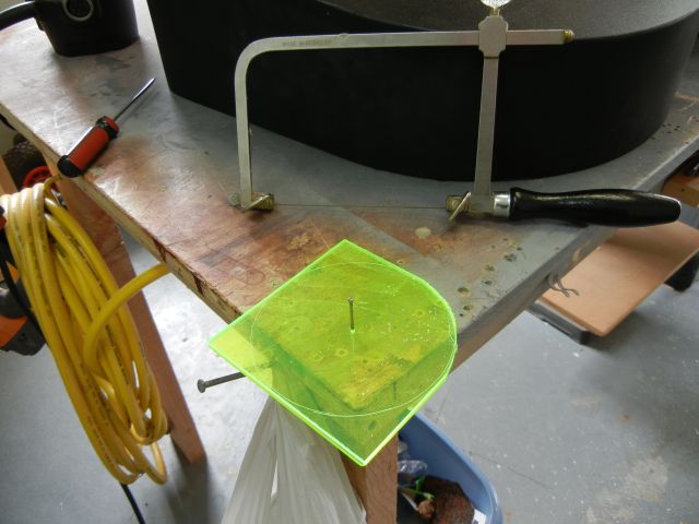

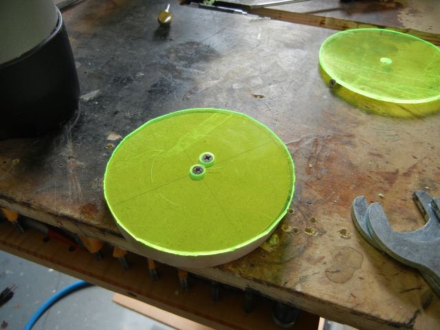

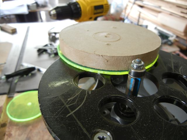

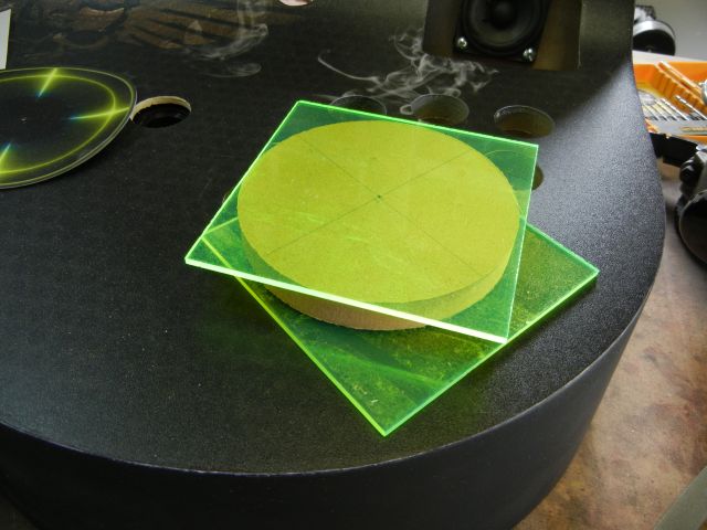

Had the weekend off and I was trying to decide how to approach attaching the joystick surrounds to the cp overlay.  I knew I would have to cut out circles in the cp overlay so the LED's would shine through to the joystick surrounds, so my options were to stick a vinyl overlay on top an overlay, cut out a perfect circle in the cp overlay to fit the joystick surround 'in', or come up with a good transition to meld the two. I had some of the light sensitive plexi left over from my buttons so I came up with this:
The first thing I did was use my router to cut out a 4" circle out of 1/2" mdf. Next I cut two blanks out of the green plexi just slightly oversized above 4".
Next I marked the center of the plexi, drilled a small hole, attached to the side of my work table with a nail, and used my coping saw (which I use for silversmithing- it has a TINY tooth blade on it and it was melting the plexi right behind itself which made it a pain in the butt to cut out!) to get the generic circles cut out that are also a little oversized:
I attached these circle blanks to the mdf wood circle and used two screws to keep the plexi from spinning when under force of the router blade:

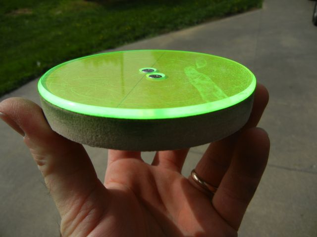

This pic shows the generic idea of what I'm trying to accomplish by routing the plexi with the flush trim bit and the template. * Notice before I actually routed the plexi, I attached a larger piece of wood to the top of the mdf to use as a 'handle' to help control the small 4" wood template and keep my fingers away from the bit.*
I don't have pics of the following steps, I was getting in a hurry and excited to see if it would work  ;D but after the plexi was cut to a perfect circle I put a small 45 degree chamfer on one edge, sanded the edge with progressive sandpaper from 220 to 600, and buffed the sanded chamfer edge with compound to accomplish this:
It's not the greatest pic, I'll post another later to show the smooth edge, the plexi is extremely light sensitive and glows on edge when the light comes in from the flat top and bottom. This blurred the focus so I'll try again later.
So the whole idea is to stick the joystick surround on top of the plexi and the plexi on top of the cp overlay. The LED's will shine into and through the plexi to light both the edge of the plexi and hopefully go all the way through to the joystick surround image to light the directionals like I talked about before...let's hope so at least!  :dunno

Little more done today and hopefully more by the end of the weekend. When trying to find a way to attach the plexi joy surrounds, I decided to epoxy screws to the bottom of them and bolt them into place, at least that was the idea...
I had to find a way to keep them separated from the cp until after the vinyl was attached because I knew that after cutting the sticker out, I would have to clean the edge, sand, buff etc. Well in theory I thought it would work and it did until I tried to bolt it down using lock washers. With just a little force put on the bolt it pulled right off the plexi. But here's what it looked like until then.
Here's an example of what the plexi looked like after the graphic was attached excess trimmed, filed, sanded, buffed.
After that little escapade, I decided to use the single bolt left attached to help line the plexi up and simply glued the whole piece down to the top of the CP overlay.  I put a heavy piece of steel on top of the joy surround to keep it tight and flush to the cp while it dried. Once those dried, I began to work on the graphic button surrounds.
Here is a quick mock up of what everything will look like.
